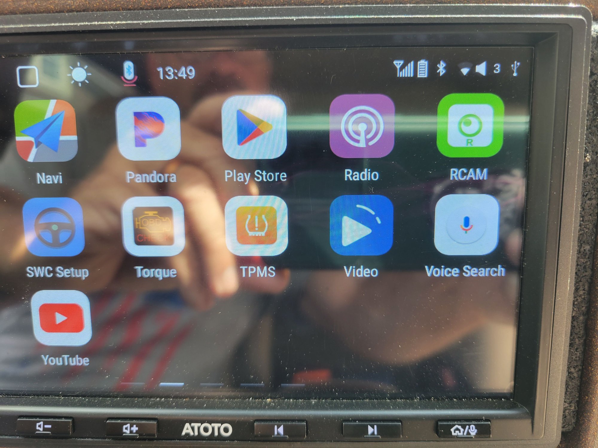

@sjbj. Photo of app, upper right corner.
