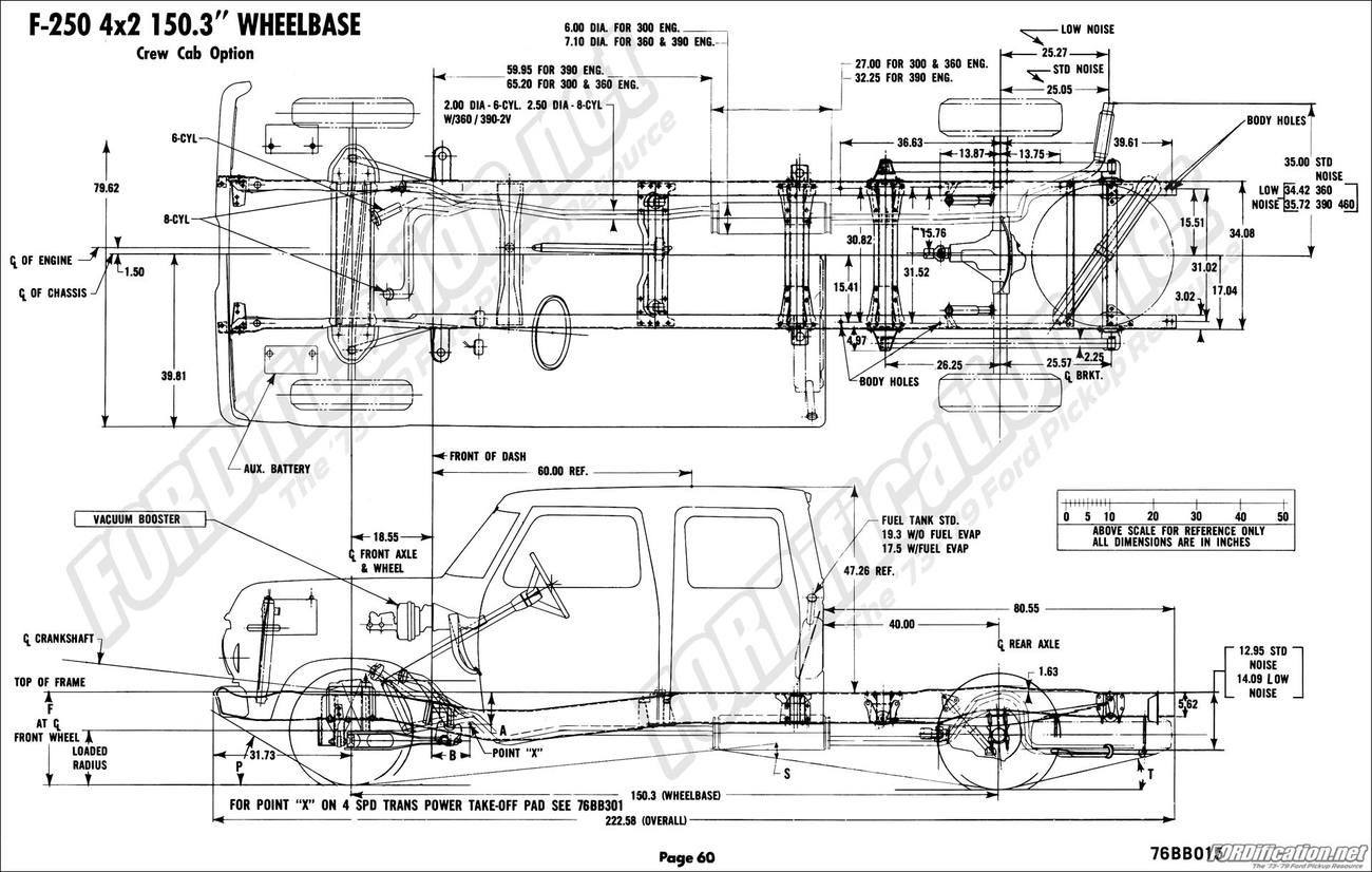

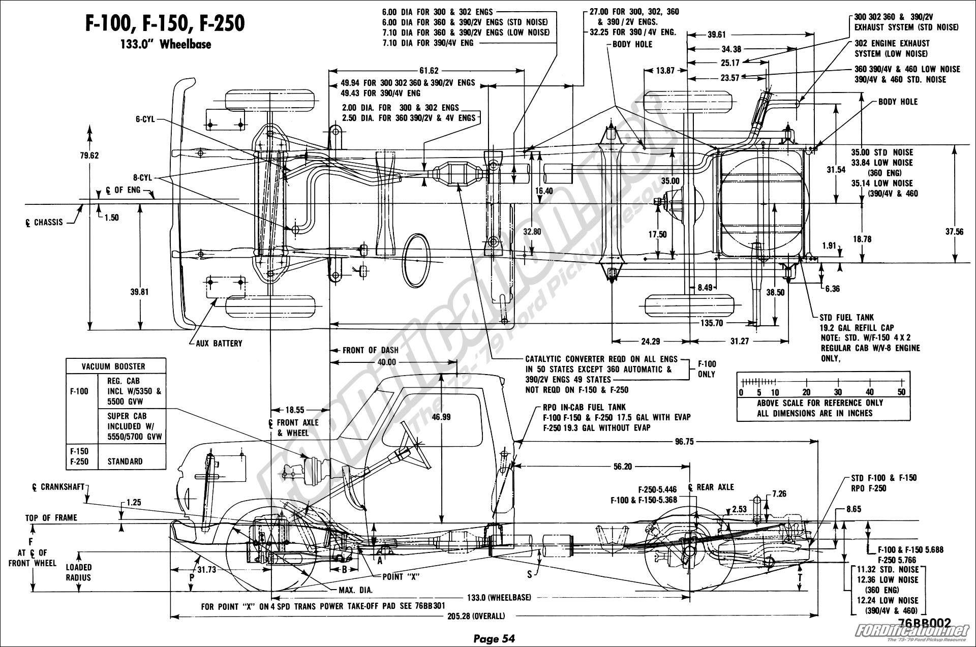

Yep I know, another 7.3 swap post but my question is would a 1973-79 supercab body bolt to a 1997 f350 4 door frame? I would like to take a 73-79 ford truck body and bolt it on a 97 f350 frame but I would rather have a supercab than a crew cab 70s body.

Maybe this will be helpful on this journey....you going to have to get the 97 measurements on your own.
