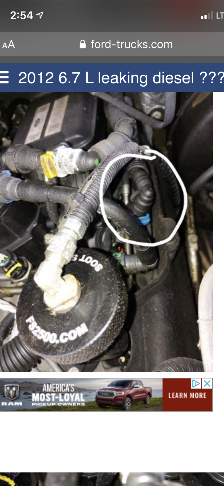

I have a 2015 f350 that has a fuel leak on the return line that goes back to the fuel tank. I’ve been trying to find what fitting it is or even just a part number for it. I’m looking for some insight as to whether it’s just a replacement fitting or I have to replace the entire line itself. I got to take pictures on exactly where my leak is coming from but I have a picture off another forum. When I get off work I will post pictures of of the fitting.
And just to be clear on this thread that I got it from it was on an injector return line issue and a person posted this picture and I used it, also there was no other answers on the thread after this picture was posted.

Really can't tell much from the picture. I would suggest you get a close look to see if it is leaking from the o ring or a cracked housing. If it is leaking from the coupling itself then the o ring may be able to get replaced without the connector. Those fuel lines are plastic formed to the plastic fittings and even if you can replace the fitting chances are the repaired line would be too short for reinstallation. You may have to replace the line but I would look closely before purchasing anything.

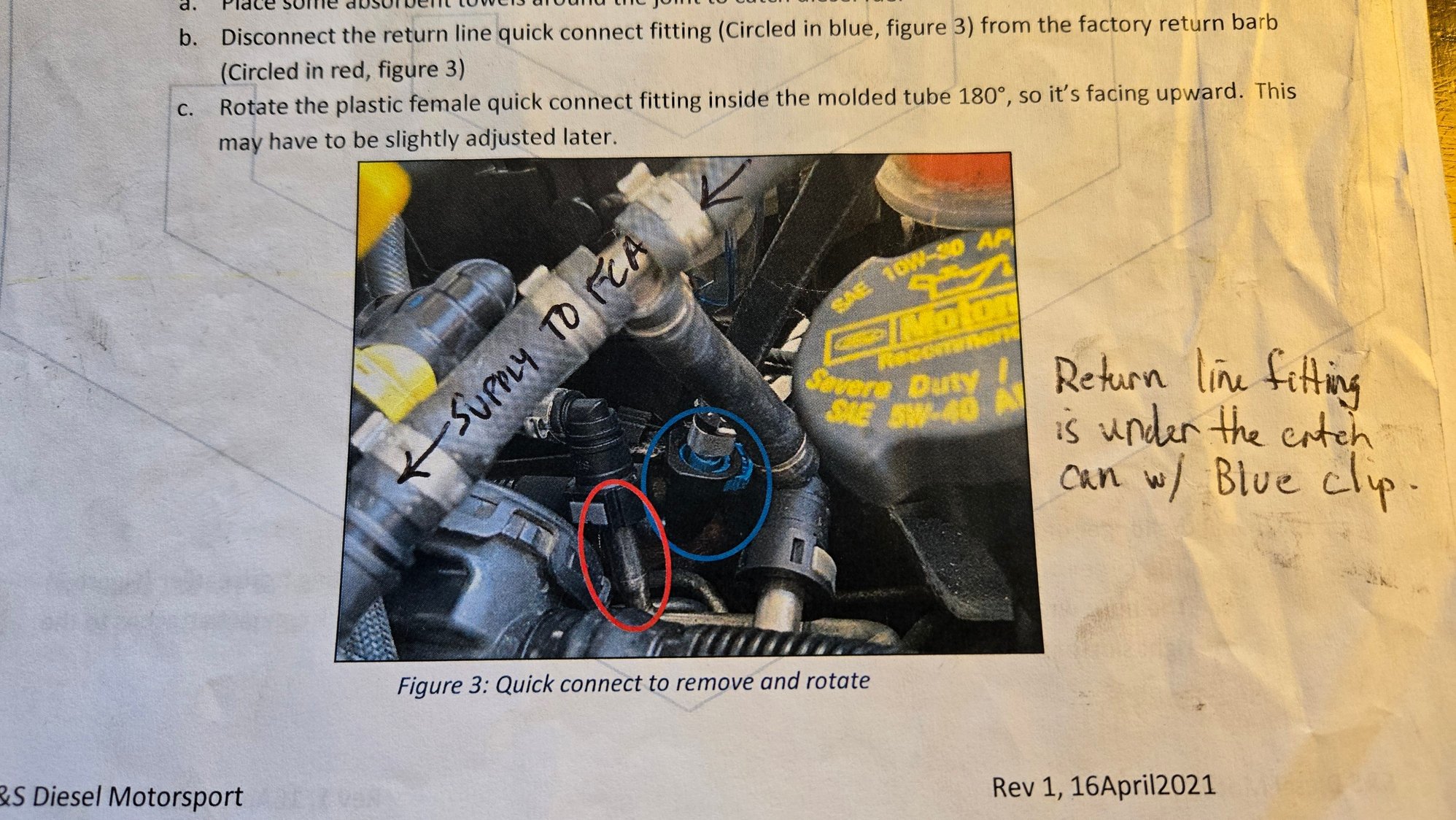

Yep thats the return line fitting. When I installed the S&S kit with filter, you flip that fitting up. From my instructions:
It's circled in blue.
