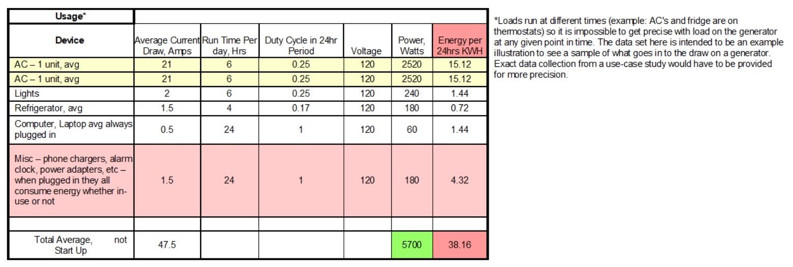

Just for kicks I ran some numbers here to illustrate the specific example a bit better.
Originally Posted by Jdwillemin
my question is...will ford ever take this a step further and allow boondockers the ultimate freedom to go anywhere. Are there plans to put a powerpro onboard system in the F250/F350 line that can have a 50amp 120V Direct plug in for our RV toys? Yes...50amp (we Texans need 2 AC units :P )
There are several things and numbers I threw in the wind for the purpose of the illustration. Those are:
- Particular model of generator - this can be any, I just randomly picked one that had suitable specs to use (Generac, Northstar, etc are just a couple other brands you could do the same with)
- Slope of the fuel consumption - this is the orange line on the graph below. I approximated this on the low end to a flat line for ease of calculating. Note that above 50% load the consumption goes up exponentially. Also note that for 120v on one pole you never go past 50% because that is the breaker limit at 60 amps, even though in this example that is 7200 watts - half of the rated wattage. For an explanation of how that is see the details in post #7 of the thread. I won't re-hash that here.
- I equated 100% load to be 14,400w as that is the limit of the main line circuit breaker. Running wattage is spec'd at 15,000w, but you'll never realize that because of the breaker. As to where the OEM spec's actually come from - no idea. All they list is "% load". They don't define what the "load" is. So for the illustration I am defining it (right or wrong) as 100% = 14,400w.
- Period hours in the chart on Operational Consumption - guesstimate based on duty cycles in the Usage chart.
- The average load vs period to compute fuel consumption. See the note in the spreadsheet excerpt below for more detail.
- The use-case below is in Prime Use generator territory. A Prime Use generator is what you see on foundations to power buildings like hospitals (larger scale, of course). Portable generators (specifically 3600rpm models such as the one in the example) are light-use. They are not built for Prime applications and therefore won't last in such service.
That said, and to cut to the chase:
In this example you need almost 13 gallons of gas per 24 hour period to supply 2 AC's, a refrigerator, and somewhat normal consumer electronics.

Below is the illustration of this:
Originally Posted by KC8QVO
If power looks scary - start accumulating kilowatt-hours and then look in to what it actually takes to provide that. You might want to be sitting down when you run the numbers.
What it takes to supply the power requirements with the particular generator in 1 day/24hr period (and you can assume generators in this class will be similar) is nearly 13 gallons of gas. I won't stretch things out to the efficiency of the power conversion between potential energy (in heat when burned) of fuel vs the electricity provided after the combustion-to-mechanical then mechanical-to-electrical power conversions. I can assure you it is extremely inefficient.
For the sake of detail, yes I did leave out the comparison between kilowatt-hours vs gallons of fuel burned. However, where these do come together is the run time while the generator is providing the wattage in the last segment of the spreadsheets. This is from the wattage loading the generator causing the fuel consumption to go up. So, the comparison here is power (watts) vs burn rate for a given time.
In the same breath on the subject of detail - in a fuel burning generator, as opposed to alternative energy systems that use storage (batteries), you are substituting the ability to store excess power with the ability to provide that power on demand via burning gasoline. Flipping this around - in the case of Alternative Energy systems - substituting the ability to burn fuel is where your storage ability comes in to play. You have to, on average, produce the energy you are going to consume (kilowatt hours) and what you are generating that you are not consuming, at the time it is produced (excess power), has to be stored. You don't have to produce the larger instantaneous power consumption (the start up on your AC and refrigerator compressors, for example) because you have the energy stored to pull from to give you what your source does not (source being wind, hydro, solar, what have you). Fuel burning generators have to have the capability to provide the peak power draw and instantaneously acquire that from the fuel that is there. That is where the fuel consumption goes up as seen in the graph below (last one of the pictorials at the bottom - the graph, not the spreadsheets/OEM spec sheet) - the load on the alternator goes up and the fuel drawn from the engine shoots up. That is also the trade-off that you have when the engine is running while little to no electrical power is drawn. The ability for the power to be drawn is provided by the .47 gal/hr minimum fuel consumption. That is the price you pay for convenience.
***The segments below are imported as pictures. There is text underneath them in smaller italicized lettering that might be hard to make out if you are skimming through.***
Note the green. Fuel consumption listed on the left in the red box. That is what the rest of the numbers are based off of.
Sample generator and specs copied from the spec sheet. The wattage, as noted, is based off the breaker tripping with a total of 14,400 watts (at 240v, or 7,200 watts for 120v). As noted in the red boxes - for 120v you can't draw more than 50% because that is the single pole limit of the breaker.
EDIT: The bottom line didn't format correctly so please note that is the "Total Average, NOT Start Up" - start up of motors/compressors is not reflected in that number. The reason - start up periods are so short, in comparison to the run time, that I am leaving them out of the total fuel consumption numbers.
Yellow is your AC - 2 lines because there are 2 units. Red is your miscellaneous. Details are spelled out in there.
Edit #2 - note the total kwh in the bottom right/brighter red box. For my cabins example I'm under 20kwh with 3 fairly occupied buildings and 2 auxiliary buildings - without AC (don't have the need for it most of the time). And in this RV example you're almost double that - because of the AC. I'm not knocking it, but if 5 buildings with a water heater and well pump are running on half that it is something to think about...
In reference to the two chart segments above: The burn rate in the below segment is what the wattage in the above segment gives when plugged in to the Equation. The Period was derived from the 2nd segment (Usage chart with the loads breakdown) - again this is a wild *** guess, but it gives some meat behind the draw on the generator and that, in turn, is what the yellow box comes from - how much gas it should burn in 24 hours. As per the note detail in the 2nd segment - you would have to do a live use-case study to get real precision.
Graphed fuel consumption. Again, 7200 watts is 50% and that is the most you can draw from 120v. So by approximating a flat line to that range we can more simply compute reasonable fuel consumption rates based on wattage in that range.
Last thought for now...
When you think about it - in the scaling of perspectives here - the idea of being able to provide large amounts of power in a mobile platform is why Nuclear technology works so well in navy applications (ships, submarines). What they deal with is exactly the same - how do you provide x amount of energy while on-the-go?
Then go back to the 1800's when steam power was prevalent - namely in the railroad industry (also shipping). Take a train for example - how much coal and water had to be on-board? How often did the train have to stop to resupply?
Or, modern diesel-electric locomotives - how many thousands of gallons of fuel rolls behind the locomotives before the cargo cars start?
That is an interesting question to ponder for a while. What does it take to provide x amount of energy? And again - electrical power (wattage) and electrical energy (watt-hours) are two totally different units, but you have to work with both.
