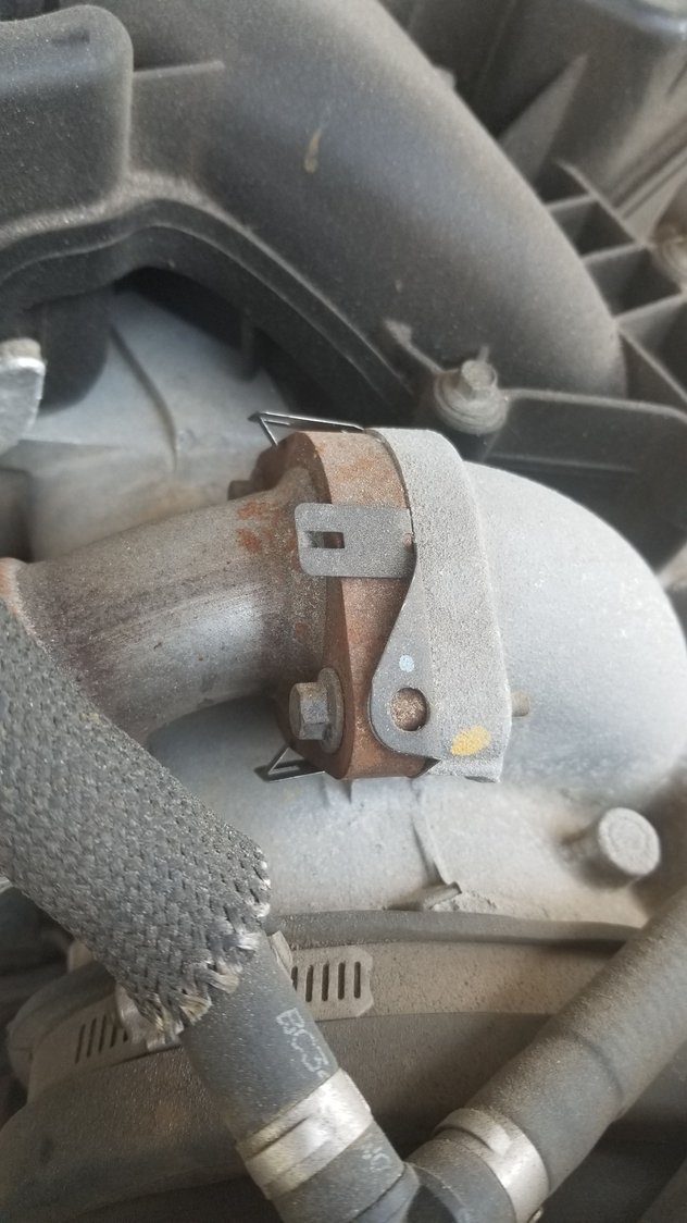

Great news. When I went to unplug the butterfly sensor I saw some plates in between the stock pipes. I am all set it seems. Would u guys still bypass the coolant lines?

And the check engine light didnt come on so I know I'm all good. What a relief cause with 190k I knew I was gonna be breaking the bolts

Thats good, you already have a egr delete tune. I would still source some block off plates and install them. I believe those are the gaskets in the pictures, not block off plates. I bought mine on ebay for about 100 bucks with the hoses and coolant bypass plates.

Your right they are gaskets. I got excited for a hot minute. I did buy the kit but am very worried about breaking the bolts off. One video I saw instead of drilling out the current holes. He just tapped new holes next to the current ones. Whatcha guys think is the best approach? Just make new ones? Or try and drill out the bolt or bolts everyone breaks off? Or just leave it since the tune has the butterfly closed and just bypass the cooling lines with the new line in the kit?
