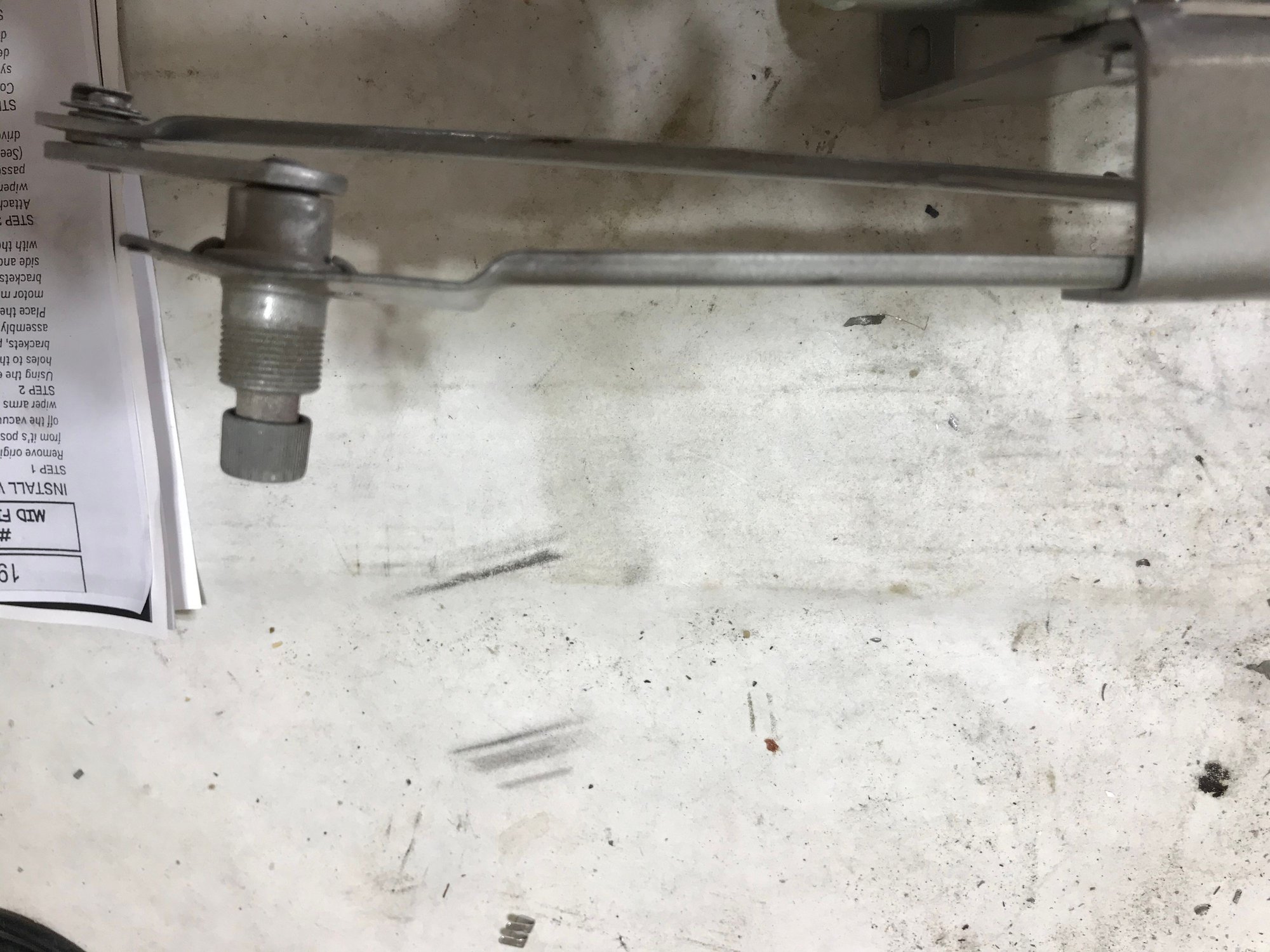

Hi gang. Finally putting the wipers back in the truck. Got my new motor from Mid-Fifty complete with Tootsie Rolls. My question is this: at the ends of the bracket, how should the tower arms be pointing. The enclosed picture, you can see there is a slight outward bent to each tower. I want to try and get it wright before I wrestle it up under the dash. The pictures are upside down, but i think you can see the bend at the end

They have some bend to them to match the curve in the cowl. Mine looked bent up too. I didn't really straighten them, but made them look "right." Then I had to bend them back to get them to line up. sorry I don't have a picture, but yours look pretty good to me.
