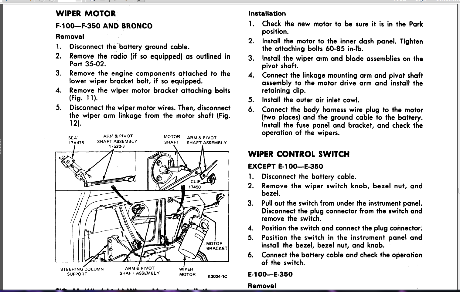

Looks like 2 bolts on the other side of the wiper bracket
Here's an excerpt from some of the Ford Shop manuals for 78-79 trucks, that I bought on CD ROM on Amazon for $35, Its definitely been worth it, it even has tests you can do to tests the wiper system. Using the shop manuals I was able to test, verify, and reconnect my speed control and get it working

It looks like the heater air box is in the way of the mounting plate for the wiper motor. Does this sound right or has the heater box come apart? I think I will remove the heater box as it looks as if some of it has broken and the tray that has all the wiring going from the left to the right has come down as well. I will let you know what i find after i get it all out. thanks for the layout and pictures of yours.
