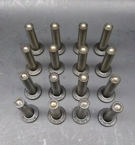

I Would pull the intake and see where the lifters went, chances are if someone drove it like that the lifters popped out of the holes and are lying in the valley. Just a guess but i think it's possible.

I'm not a Y-block expert, but I think those use a "Mushroom Lifter" They are installed from the bottom with the block upside down and before the cam is installed. The larger diameter end rides on the cam lobe. So, they cannot pop out into the valley. You might have bent pushrods from them falling out either during a valve adjustment or because the adjustment got severely loose. Some old school mechanics like to adjust valves with the engine idling. I've seen push rods fall out when doing it that way on mechanical cams.

As far as your Y Block lifter issue a Y Blocks lifters insert from the bottom end of the block. There’s a old tool to remove them without complete disassembly but I’ve only seen the tool in pictures. I’d suggest you purchase a good Y Block book if your going to disassemble it. Here’s a couple:

The lifters can't go anywhere as stated. I'd pull the rocker assembly and all push rods on that bank and ensure the rods are all straight and the same length. If the rockers and shaft are worn, then rebuilt assemblies are available. Bear in mind, the one real design weakness of the Y is that the rocker arm assemblies receive oil only from the center cam bearing through a passage in the block and head then to the rockers via the center rocker stand. Oil delivery can be compromised due to a worn cam bearing or simply sludge in the passages. If the rockers and areas under the valve cover look dry with little oil, then this may be an issue on yours. There are ways to mitigate this, but check yours out before we go on about that.

Thanks everyone for all of the responses. I've learned a lot from everyone about these old Y-blocks. I've made some real progress here. First, I determined there were three stuck valves. I was able to retrieve the three push rods and low and behold they were all bent. I was able to free up the stuck valves by by tapping the end with a hammer. Next, I straightened out the push rods. I was then able to see down into the holes and determined that all of the lifters were still in place. Reinstalled push rods, adjusted valve lash and now I have an engine running on all cylinders. Very little spoke as well. Thank goodness I didn't have to dismantle everything at this point. It's too hot here in AZ right now. Future plans are to go with a 4 barrel intake and electronic ignition like you said. My other question is; does anyone know what type of headers would work on this engine for clearance sake? Seems like a lot in the way on the driver's side? Also, I would like to add a double reservoir master cylinder. Any suggestions? Thanks guys for the help!!
