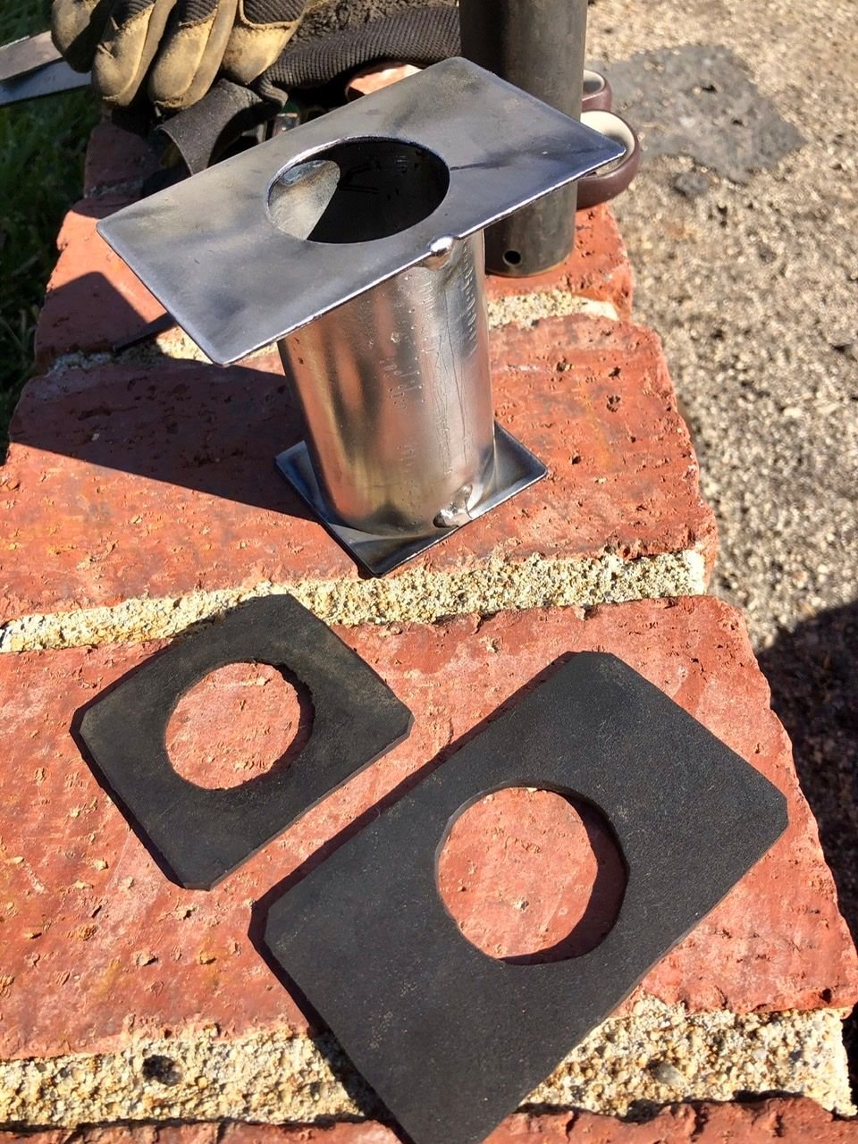

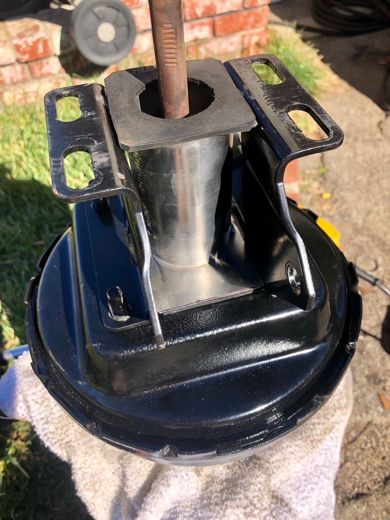

I made a steel tube to seal my booster to the firewall. Gaskets on both ends.
