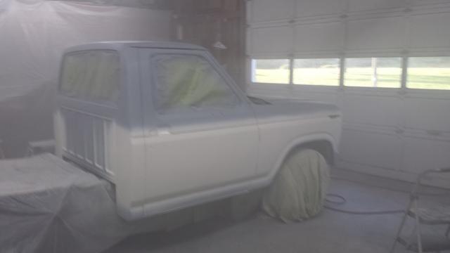

I have 2 old school suction cup guns and when I did my frame with hardware store enamel & hardener I used 1 of them as it was easier to get to and clean up than my HVLP guns.
For painting I have 3 different HVLP guns, Start Line kit I got thru East wood.1-large head paint gun, 1 small head paint gun, 1 large head primer gun.
I can use the large De-cups kit with bladder for easy clean up on all 3 but have yet to use the primer gun.
When I did my truck I used 1 of the suction type guns for primer, just easier for me to fill when I was priming being old school.

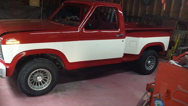

But for painting I used the small head gun for painting the inside and door jambs and used the large head for the outside.
See the red over spray on the floor?
Dave ----
