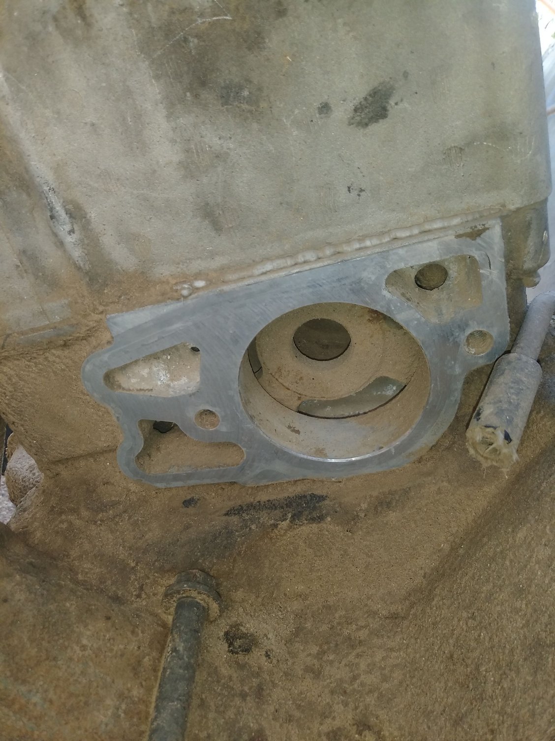

Thought I had pics of the early front cover where the HPOP mounts, but I can't find any.
Hoping you guys can help out.
I have a customer needing a HPOP but he's not sure if it's early or late.
I know the actual pump differences between early and late, but he bought the truck not running, said the previous owner replaced the pump and we don't trust that it's the correct pump based on other hack work the guy did..
I really need to ID the front cover where the HPOP mounts so I can get him the proper pump.
Any help?

Hope this helps. 95 MY

Thanks for the pic. Is that Early model '95 for sure?
I can't tell if that lower left passage goes all the way through to the gear cavity, or if it goes up into the reservoir.

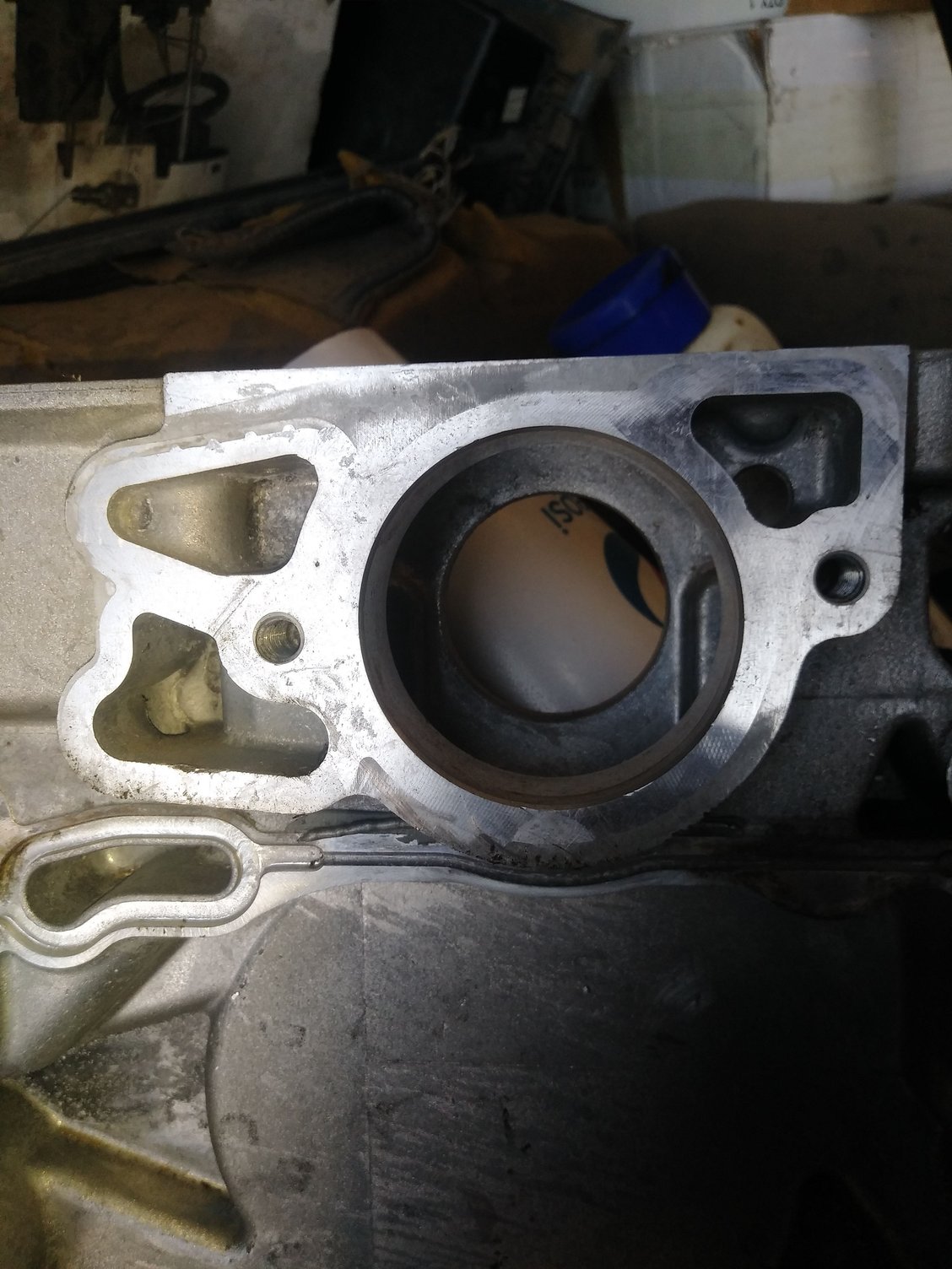

Yes mine has the check valve on the HPOP. You can see in the pic that theres a small hole. On the top left Heres a reference for a 99+ hpop cover

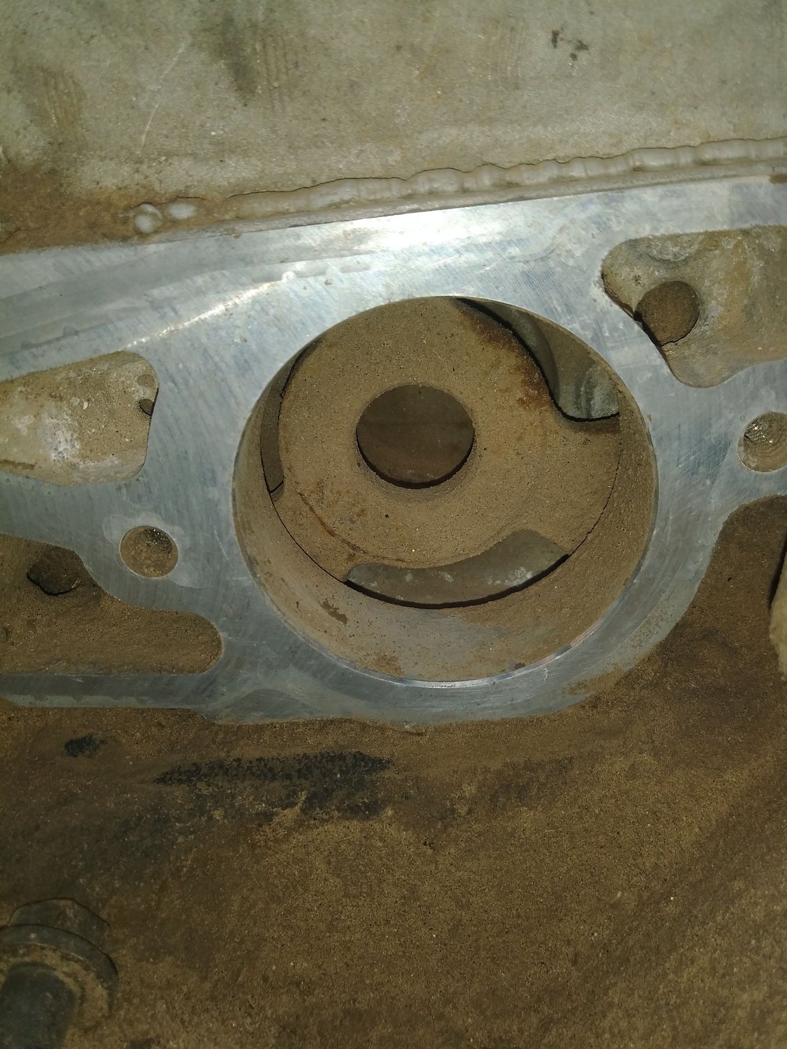

Heres a better picture of the early 95

Yeah, I meant top left.
Thanks for the info!
