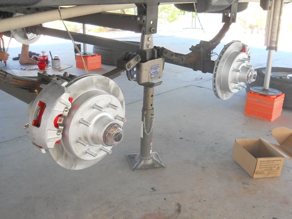

Huge props to performancetrailerbraking.com I desperately needed a disc brake kit and they delivered quick. Ordered last Thursday, showed up today. Fortunately they had someone cancel and were able to cram me into the shipping schedule. The kit is fabulous and includes everything minus some loctite, grease, and brake fluid.
I had checked with stopyourtrailer.com and their price was great but their shipping schedule didn’t work with my timeframe. Otherwise both companies are top notch.
switched out some worn drums and electric brakes today and tomorrow I run some hydraulic lines.

Just wondering, how did you lift the trailer? I am considering replacing my leaf springs and doing brakes, but 13k pounds seems liek it would need a few very heavy duty jack stands, not to mention the jack to lift one side. I just hate having someone else do the work if I can do it myself.

I used the leveling system then once it was up I put jack stands under the axles and lowered it on to them. Pretty easy. I’ve also used a floor jack before and done one axle at a time. It works but it’s a longer process.

Ah ok, I don't have that leveling system. I am going to have my work cut out for me or just pay a guy down the street to do it....which I HATE to do. I also don't wanna a trailer to fall on me, sooooo. Thank you for the heads up!

4 jack stands and a pump jack will get one side up at a time with no problem.

Discs are in, plumbed and working. This might just be the best upgrade to the 5th wheel. The trailer might stop better than the truck now.

Levelers to lift but a standard floor jack would do. Even on the levelers I used jack stands.

agreed I placed a jack stand under each axle.
