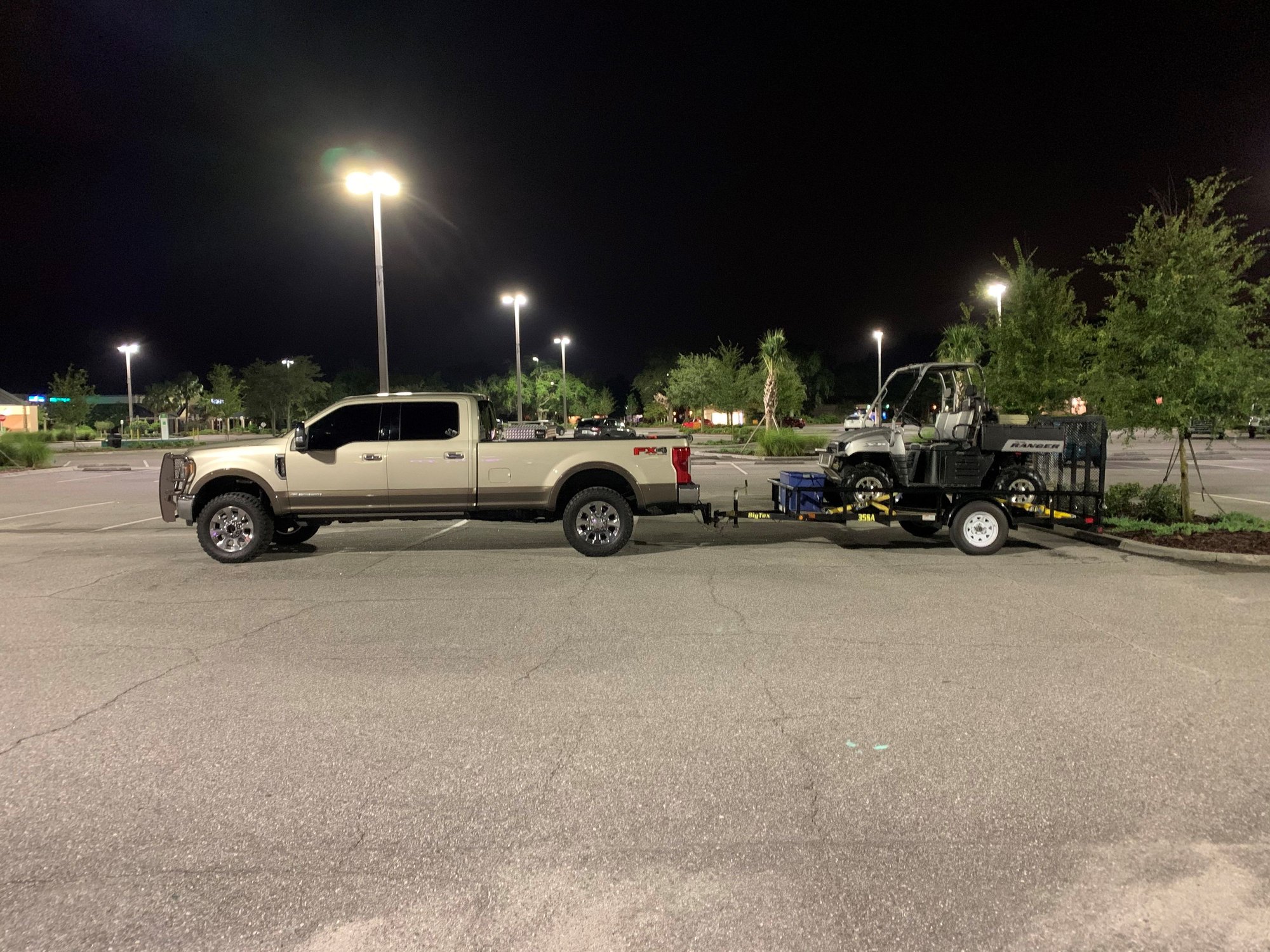

Happened to be going to the deer lease this weekend. 6x12 Big Text with 6" drop 3" shank bulletproof.
2.5" Carli Back Country in the front, stock rear and 295/65R20 Cooper STT Pro's
-Curtis-

That looks like a good setup. I think a 6" drop is adequate for most trailers.
