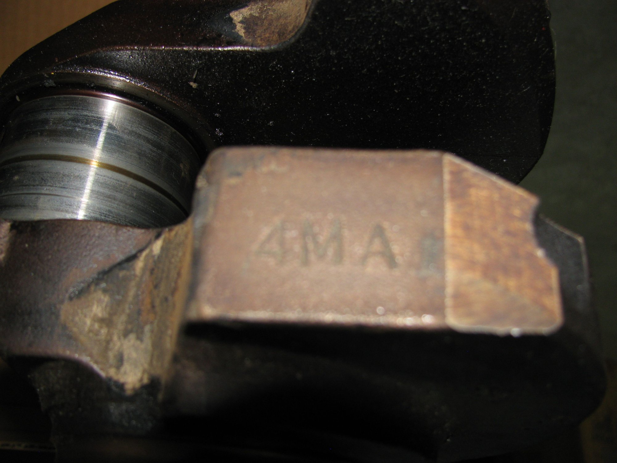

Look on the crank for a marking like this. They are all marked with an ID number. Post it and I will see if it is listed in my interchange book. This pic is a 73, 351C not an FE.
