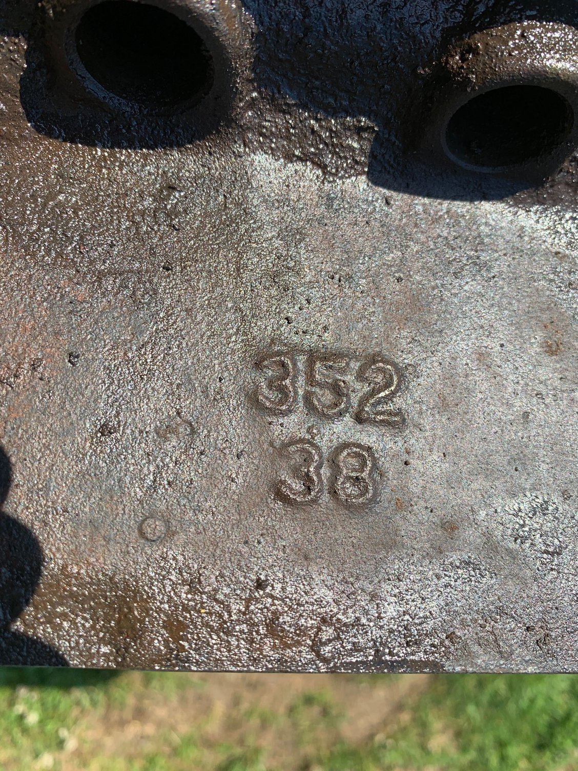

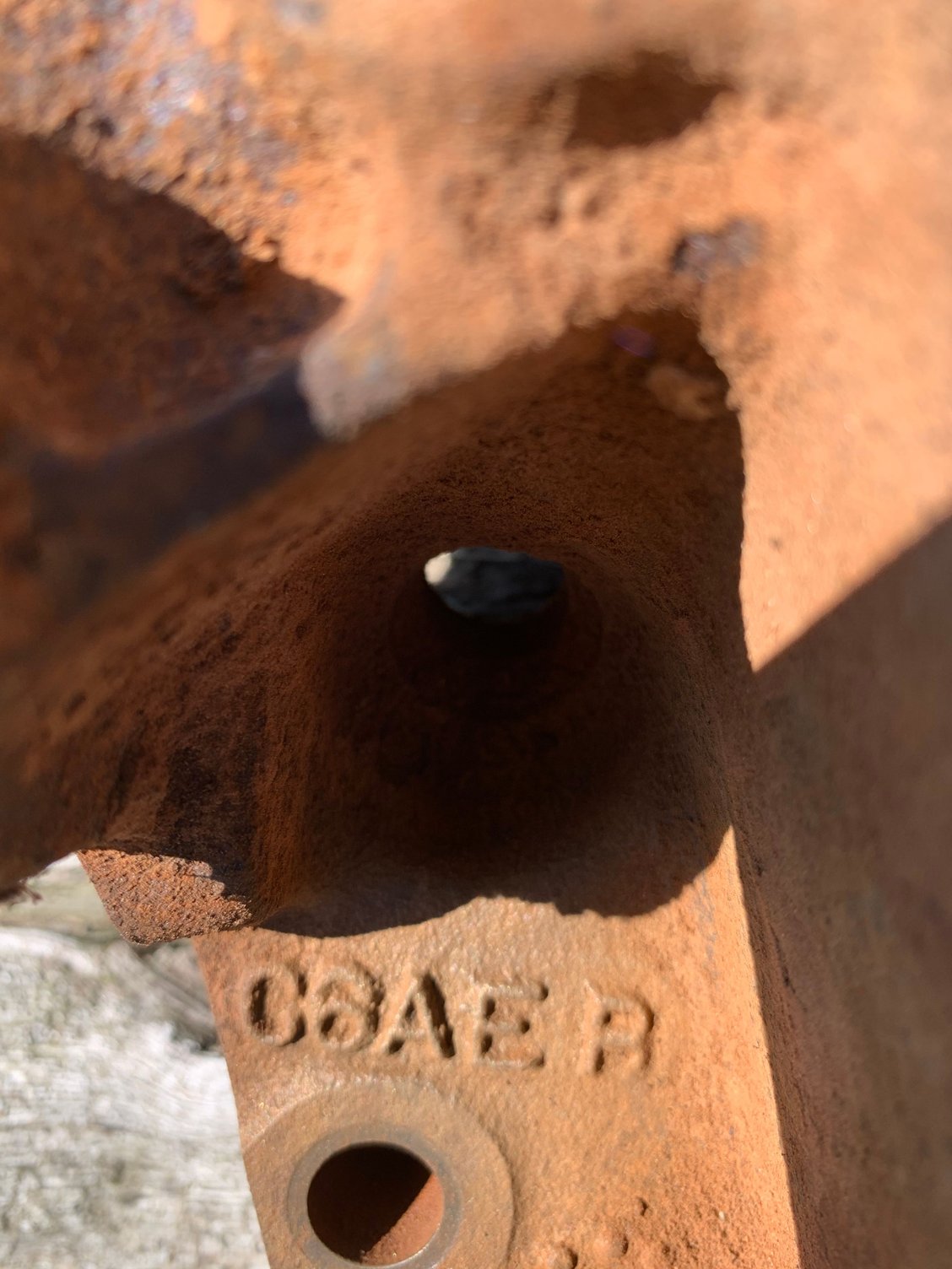

Hello fellow enthusiasts. Still working on the 1960 F 250 and just ran into major roadblock. Turns out the motor in my 69 has been dressed up to look like a y block but is instead either a 390 or 428. Casting numbers say C6ME. Exhaust manifold says C6AE-R (and are shot BTW) and the only numbers on the back of the block are 352 with the numbers 38 underneath and where the starter is, it’s stamped 352 with the numbers 22 underneath. i am pulling my hair out trying to figure this out. I stripped the block down to bear bones so I can’t measure stroke. Any help would be much appreciated. Thanks. Jarheadjo

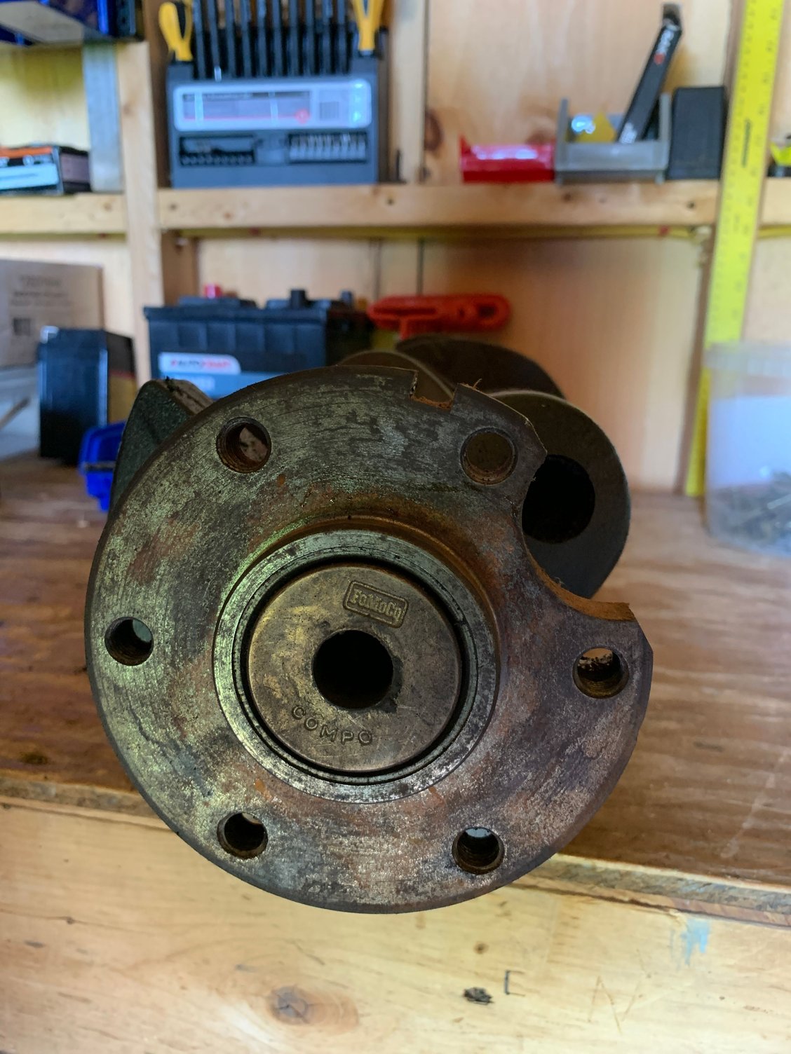

Here is a pic of the back of the crank, no numbers. There is a number 9 on one of the lobes

Only other numbers on the heads RC6AE Dash R and the number 10 and the letters DIF/F

You have the crank out so measure it with your calipers as per the previous post I made with the link to a webpage. As far as what your truck left the factory with you will need to post the warranty plate tag and also confirm that the vin on the tag matches the frame rail vin

Thanks, will do. This motor must have been a replacement. The original motor was av292 Y block according to VIN plate. So I can use the calipers and don’t need a micrometer? That’s good because I don’t have one lol. I did find another number today which I can only assume is the assembly date? 5M10-A. Just so I am clear center of crank to center of journal. Thanks

Crank center to rod journal center x 2 will give you the stroke.
That crank has the half-moon cutout like a 352 crank. Some 390s had it too, but very limited vs. the 352 crank. Your measurement will tell the tale.
Your bore measurement brings up the possibility of it being a 330 MD engine. These were FT engines for medium trucks. The Medium Duty engine used the 352 crank for a 3.5" stroke, and had a 3.875" bore, the only sub-4" bore in the FE/FT lineup. So double check your bore.

Thanks to all who assisted me in identifying this motor, it’s official, 352. 4.0/3.5, stock 352 heads. Thanks again one and all
