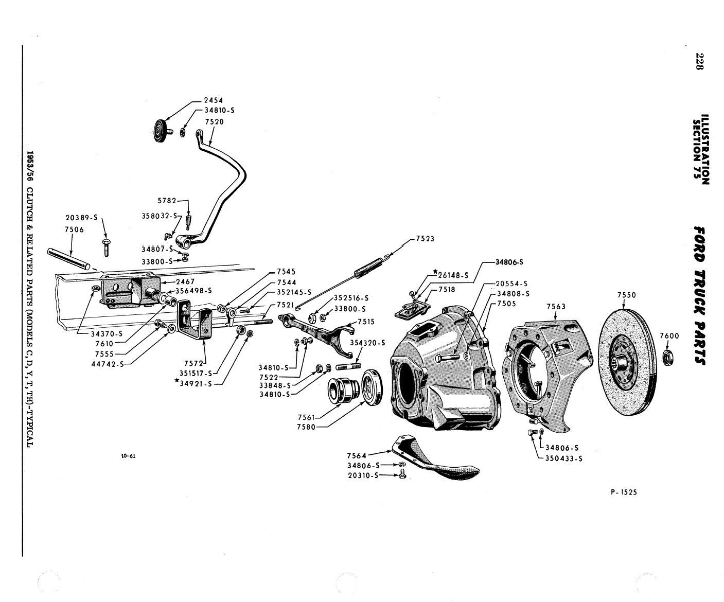

Does anyone have a drawing of the clutch pedal linkage and hookup under the cab of a 53 F-100 ??

Hopes this helps

This is exactly what I was looking for!!
Thank You so much!!

Wouldn't happen to know where I could get that clutch pedal shaft(# 7506) would you?

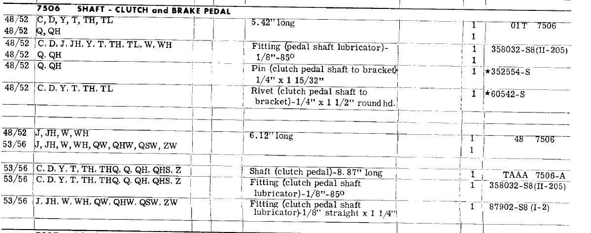

Not sure where you can get one, but here are part numbers to help with the search.
Here is where you can get the pdfs that Bob and I used.https://www.blueovaltruckparts.com/diagrams
Free downloads. there are two files. One is the images, the other is the text. I paid $22 for my copies and it was well worth it. Free is even better.

Doesn't look like much more than a steel rod. Hardened steel?

It's got a groove/notch cut into it for the clutch pedal lock pin on the one end. The other end has a hole drilled thru it for a pin to retain part # 7544.

The brake and clutch shaft is available as a new reproduction from mid-fifty f100 parts. It is part number 0520 in the 2018 catalog
