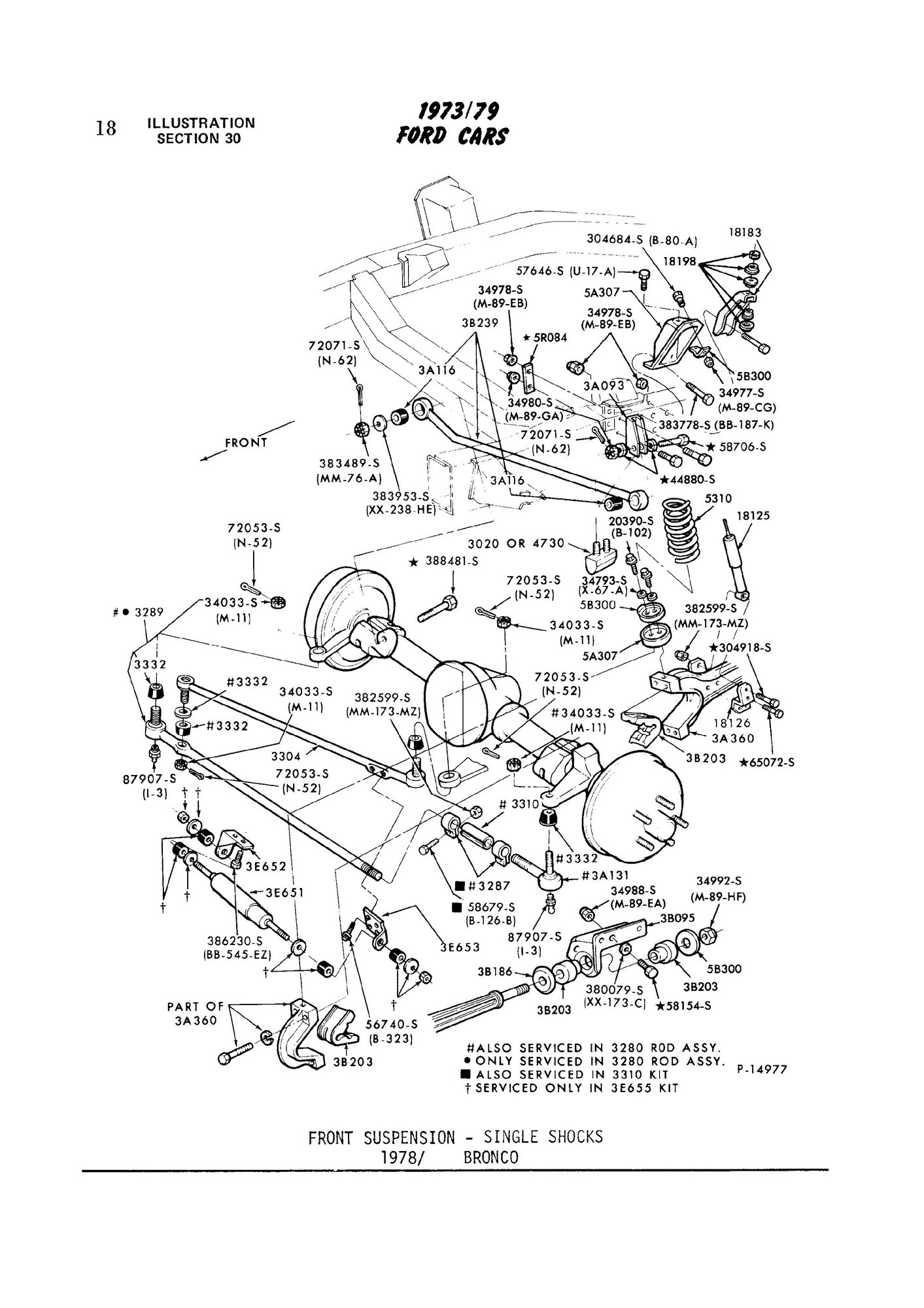

Now back to studying steering stabilizers. While I had what is apparently a "stock style" stabilizer, it was not a stock setup. My truck is a 68 F-100 chassis and axle with (it appears) 76 F-100/150 power steering and steering components. Dad did the power steering swap 30 years ago, but doesn't recall details unfortunately. Who would after 30 years? The stabilizer installation is not stock style for either truck. Looks more like brackets for the second stabilizer in a dual setup, but no idea who made the stuff and no markings on the old stabilizer that match to a maker or part number. Now I get to study stock and/or aftermarket installations for everything around that age and see what I can make work best. Kinda looks like frame bracket for Early Bronco with drag link (?) bracket for 76 F-100.

66-77 EB (Early Bronco) / (FYI all EB's had a trac bar set up) steering damper mount bracket #3E652 (engine cradle mounted) looks alot like a 73-79 F100/F150 4wd and on a 78/79 full size Bronco.
Yep, just trying to figure out what pieces will work best for my particular truck. Thanks for the diagram, it does help me see how it all goes together better than looking at people's suspension pics.
The drag link is stock style so it doesn't have accommodations for bolt on stabilizer bracket like the picture above, but the bronco style bracket mounts with u-bolts, so it should work fine.
Looks like my front cross member has the mounting holes drilled all the way through for a Bronco (& maybe Bumpside F-100) style frame bracket. That said there are two styles of frame bracket for the Early Bronco, one (earlier) has the stabalizer mount hole and bolt holes aligned, the other (later) appears to have the stabilizer hole offset towards the front of the truck a little. Got to figure out which would be better in my application, but I think the later style would work better since i think it would keep the stabilizer more parallel with the axle and steering.
