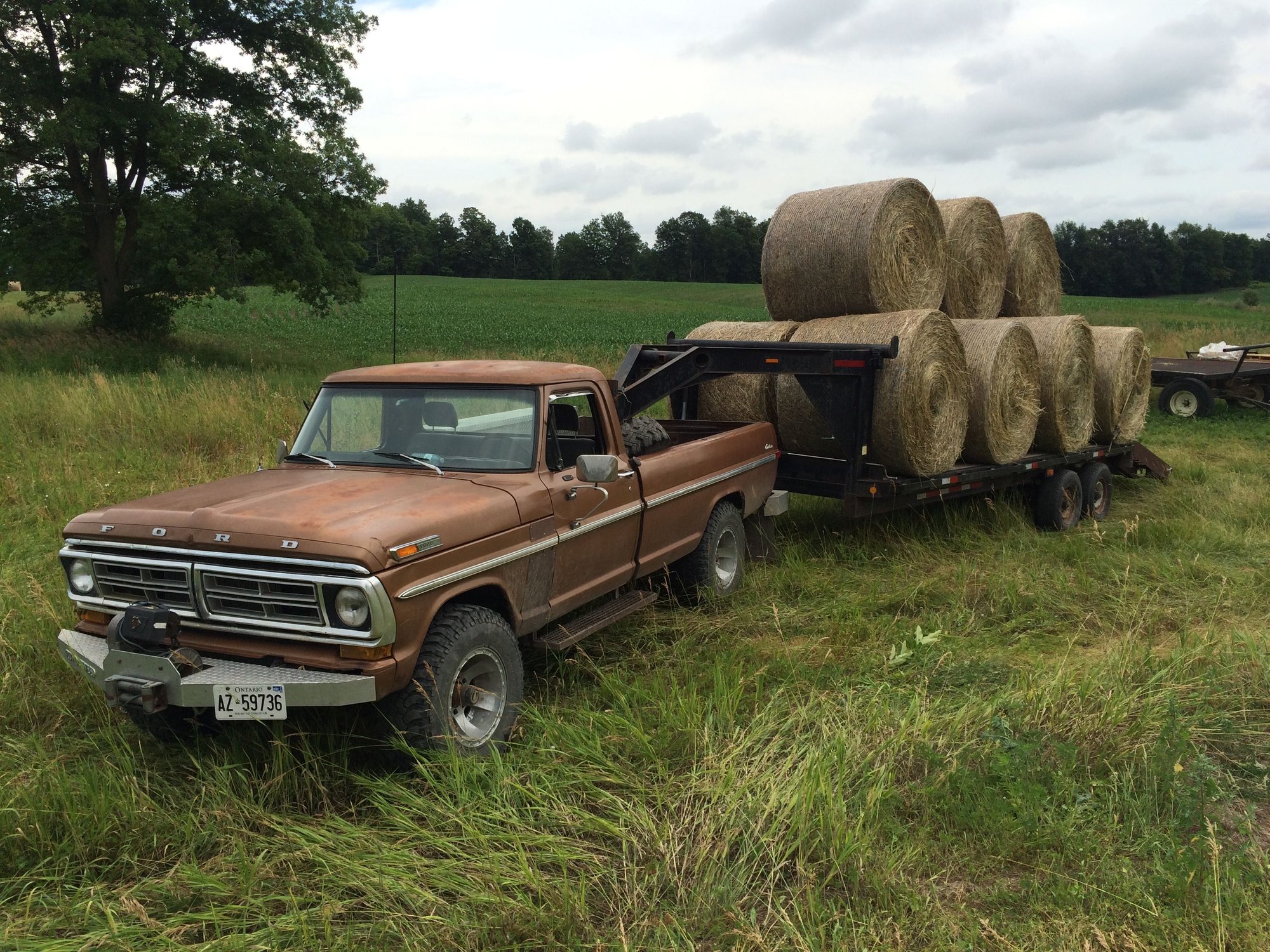

I've got a 72 Highboy that I put a 7.3idi and ZF5 in, originally it had 4.10 gears and with the trailer on it was a bit of a dog but liveable, this winter I swapped in a HP Dana 60 front and Sterling 10.25 rear out of a 1990 F350, the problem is that they have got 3.55 gears and the truck is a gutless gob now. I want to go back to 4.10 gears without spending a fortune. The truck initially had a Dana 60 rear in it. Can I take the gears from a Dana 60 Rear end and put them in a front high pinion axle? I don't know much about gears as I have never needed to get into them before. Here is the old girl in action.
