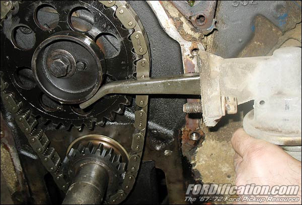

No engine changes needed and I'm not sure why you think there would be. Oh wait.. are you a former chevy guy? If so that explains it. On a Ford motor the mechanical fuel pump eccentric is bolted to the front of the timing set it's not ground into the cam. And yes that applies to an EFI motor too... at least if it's all original, for whatever reason Ford left the eccentric in there and even if your motor doesn't have one you just have to find one and put it on.
