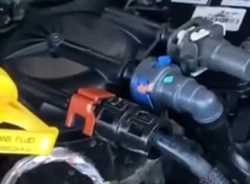

I get that your return line connector broke but did it have the reinforcement clip installed on it? My 2019 came from the factory with the reinforcement clip installed (built Jan 2019), not sure exactly when they started implementing it though. For around 5 years now, the Motorcraft fuel filter kits for the 17-19 have included the reinforcement clip to be installed on those trucks that did not come from the factory with the clip. So even if yours didn't come from the factory with the clip it should have been added if you had the filters replaced with Motorcraft filters within the last 5 years.

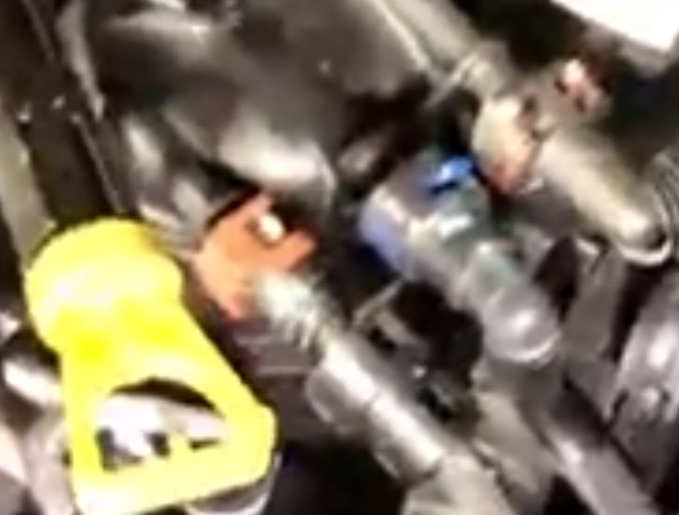

Without clip
With clip

Here's the one with the reinforcement breaking. What wrong with a hose clamp?
Broken Fuel Line in my 6.7 Powerstroke
The fuel filter set that included the reinforcement clip was FD-4625-AA, it appears to have now been superceded by FD-4641 which no longer includes the clip. I guess Ford must feel by this time most 17-19's have had the clip installed. The clip part# alone is HC3Z-9A317-A. At this point the clip is useless to you though, it may have avoided the situation you are in if it had been installed previously.
That return line in that video does indeed have the clip on it but it wasn't even installed correctly lol (screen shot below). It's not actually attached to the base of the connector haha.
The main reason it broke however is because he was being way to rough with it, and that guy clearly didn't know how to release the connection. That one requires pressing in on the sides of it which he didn't appear to be doing.
