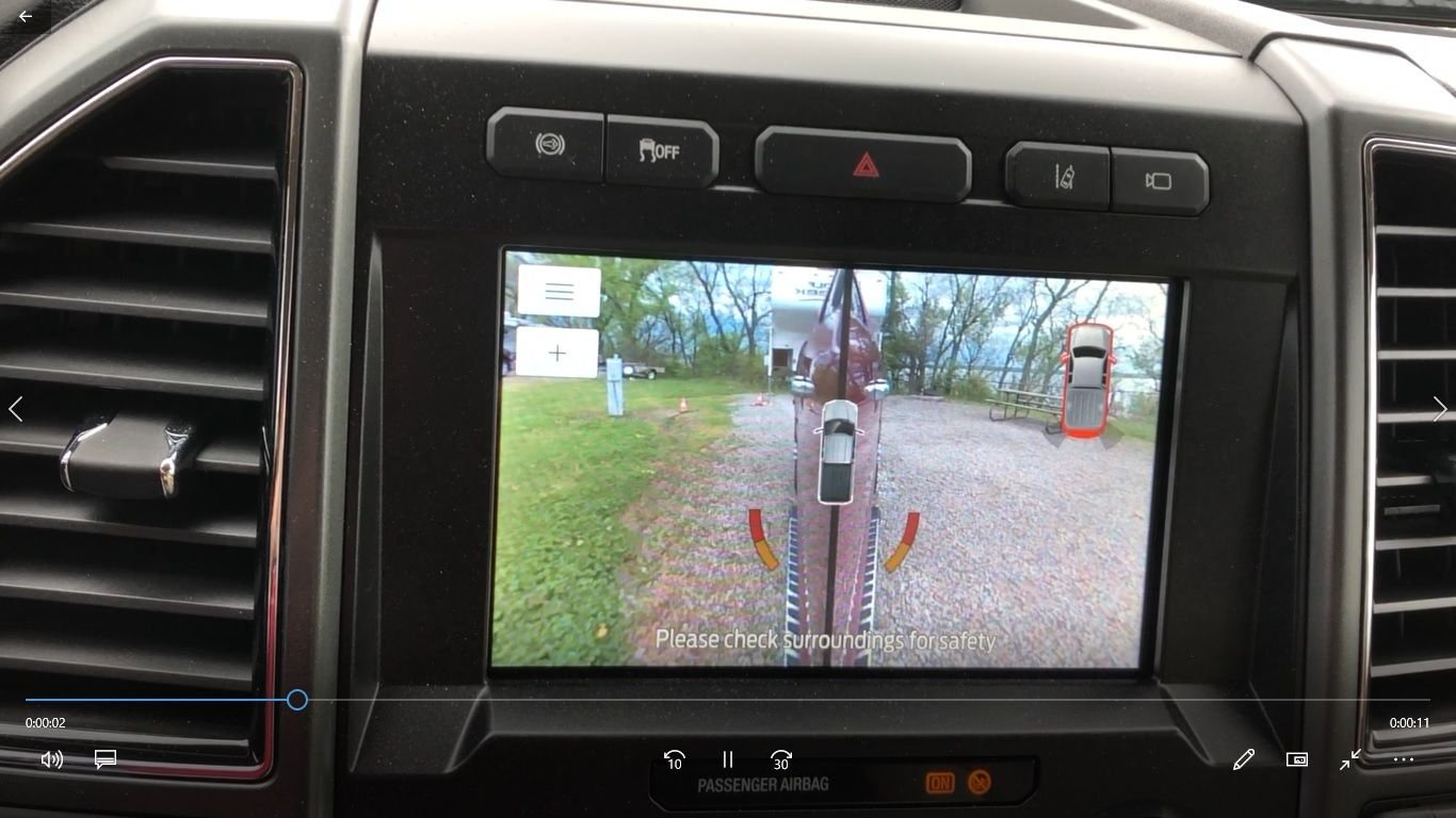

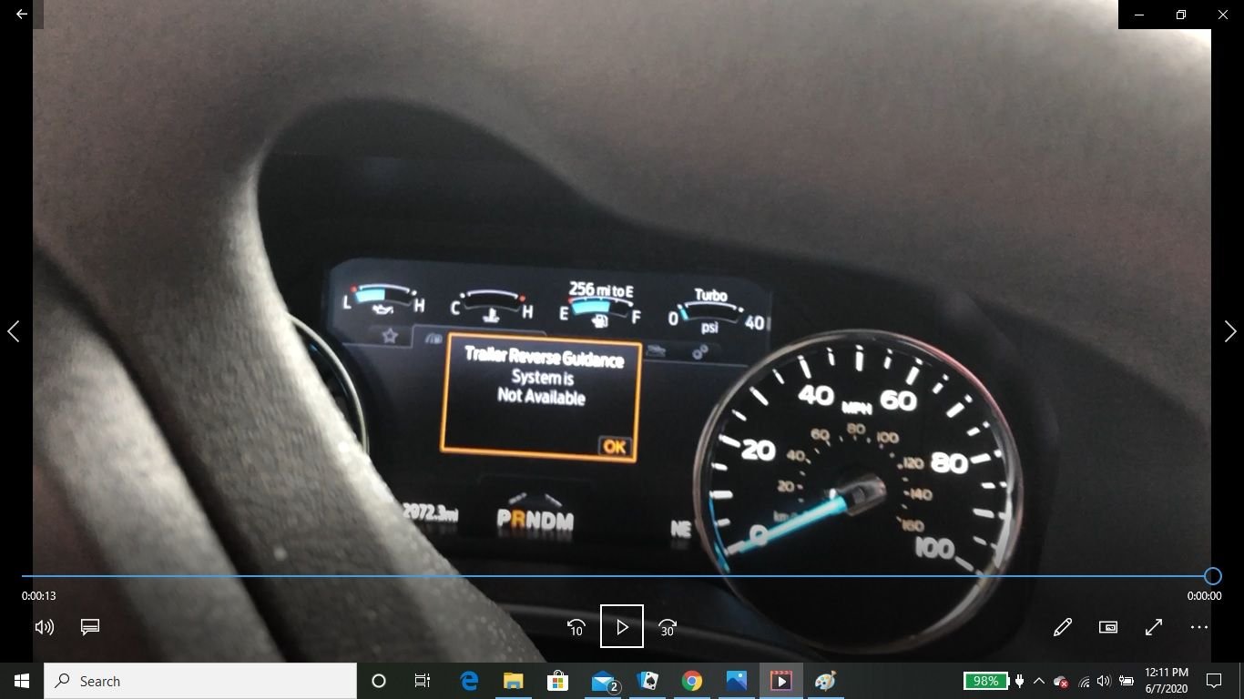

My 2020 F-350 has the 360 camera view and trailer reverse guidance. I haul a slide-in truck camper requiring me to remove the tailgate, which includes the reverse camera.
If I select the Trailer View (side Mirror cameras) or Truck Bed View cab mounted camera, I get a non stop Trailer Reverse Guidance Not Available Message and alert audio. Pressing the OK switch clears it for about a half second, but it resets and goes off again.
The Trailer Camera helps me load my camper as I can balance the distance between the camper edges on each side. I also use the Off Road display when loading because it gives me front wheel position.
The cab mounted camera helps me see my boat after I remove the truck camper and want to launch the boat.
The owners manual says putting the connector covers on the tailgate wiring is important and will prevent nuisance messages so I always do, but these messages are really annoying. They also cover up the Off Road display, rendering it useless.
Do any of you know of a work around? My local Ford dealer was no help. I feel like it is an unintended feature and Ford should resolve it, but Ford is big and I only own one truck.
