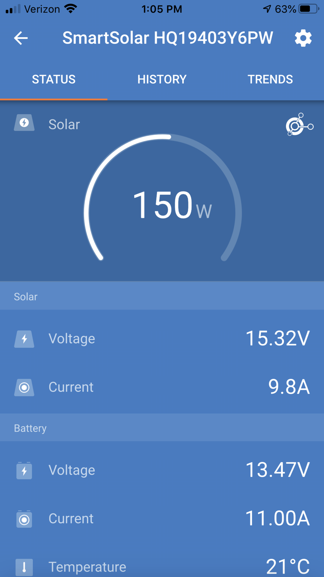

I loaded a Victron app on my iPhone to create a network for the CC and SBS, to customize charge stage voltage setpoints, and to be able to monitor system performance. The SBS monitors battery temperature as well as voltage at the Battery terminals.
The Victron SmartSolar MPPT 75/10 or 75/15 charge controller would be satisfactory for your application. The SBS is optional but helps optimize battery charging and therefore longevity.

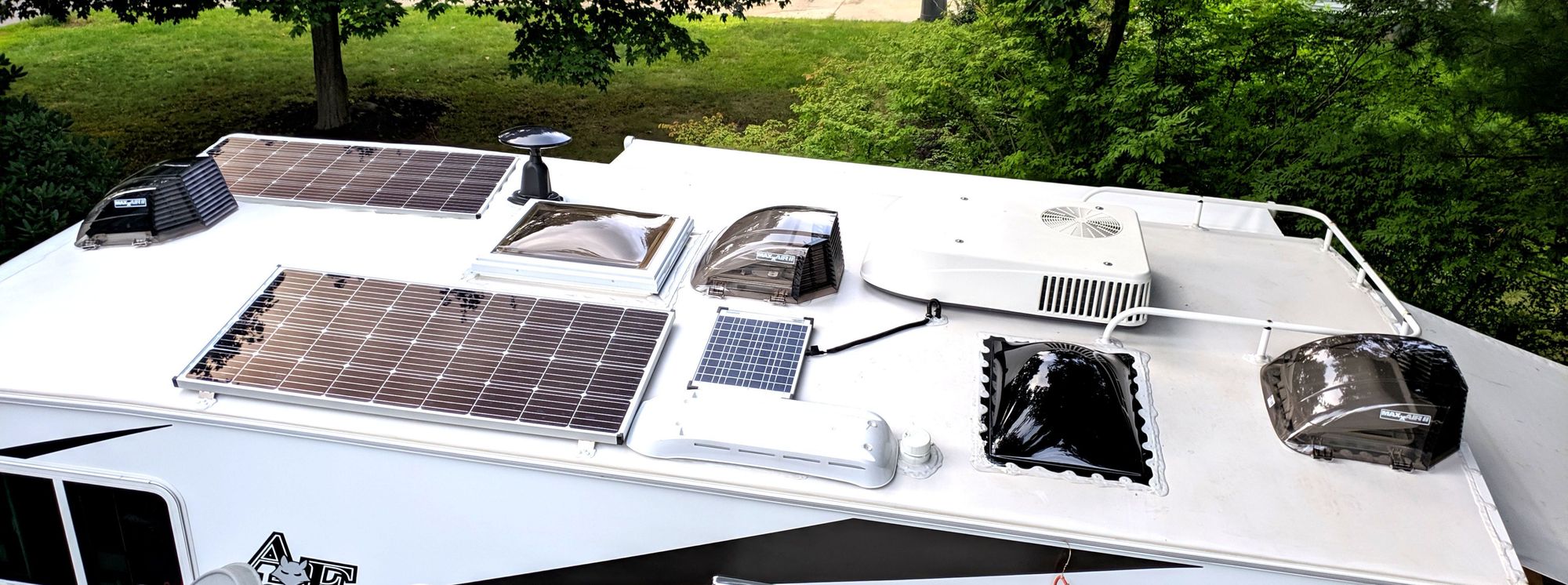

Truck Camper Warehouse added a 2nd 170 watt panel to our AF1140 Arctic Fox when we bought it, pulled the stock wet batteries and put in FullRiver DC115-12 AGM batteries, then upgraded the stock 10A Zamp Solar Controller to their ZS-30A Unit while still maintaining the stock wiring like you mention.

Thanks for the post and pictures. I have been debating how I want to fasten the panels to my roof. I don't have racks on the roof so would have to add them. Otherwise it looks like screwing them down. On fiberglass roofs in the past I used the double back tape like is used to hold on auto body cladding with good results, but I am not sure it is the best idea on a rubber roof, although I like the simplicity and no putting holes in the roof. The panels I will be using have been on two RVs so far so this will our truck camper will be the third one.
