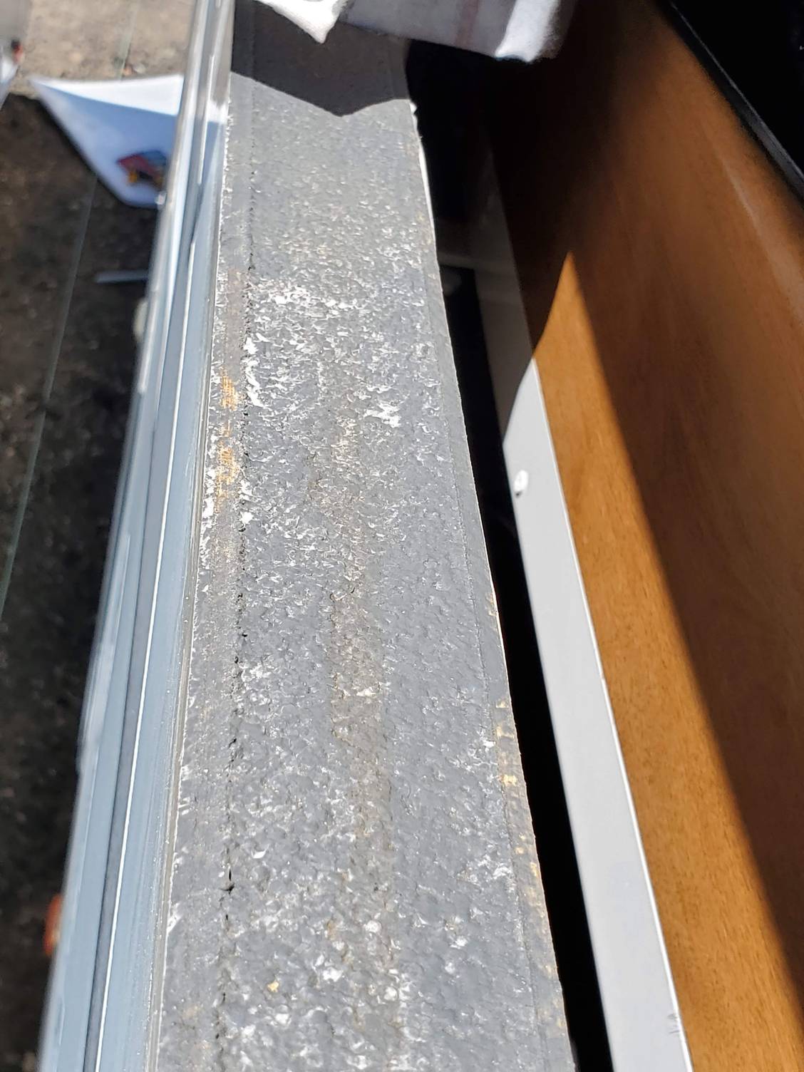

The gasket was in good shape. There are no tears. The gasket was very securely fastened to the window frame. On top of the frame, the gasket is a bit more flat than on the bottom. In the picture below, this is the only abnormal portion of the gasket. The top of the window is on the right side of the picture.
This picture is the side of the window. It's the only abnormal section of the window opening. What you're looking at is the fiberglass exterior on the left, interior panel on the right. The aluminum stud is showing through the rigid foam insulation.
