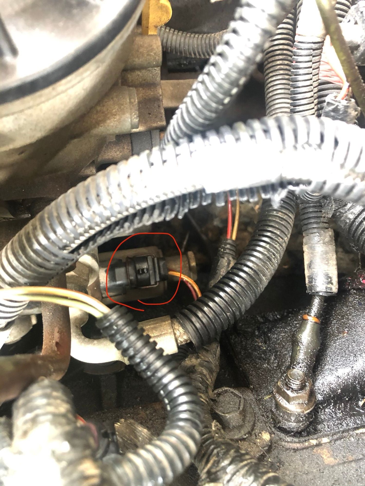

Originally Posted by Wes444
Are you sure you unplugged the IDM while it was running? It's very hidden in the inside of the fender well, I can't even see any bit of mine without removing the fender liner. Unplugging it while running would instantly kill the truck, and possibly damage the IDM or PCM. What did you actually unplug?
Circled plug
Old Jun 7, 2020 | 06:22 PM
SkySkiJason's Avatar
SkySkiJason
Joined: Jul 2008
Posts: 12,782
Likes: 2,142
From: N.GA Mountains
That is IPR. Won’t run with that unplugged.
You cam unplug the ICP sensor and see if there is oil in the plug and/or it runs different unplugged.

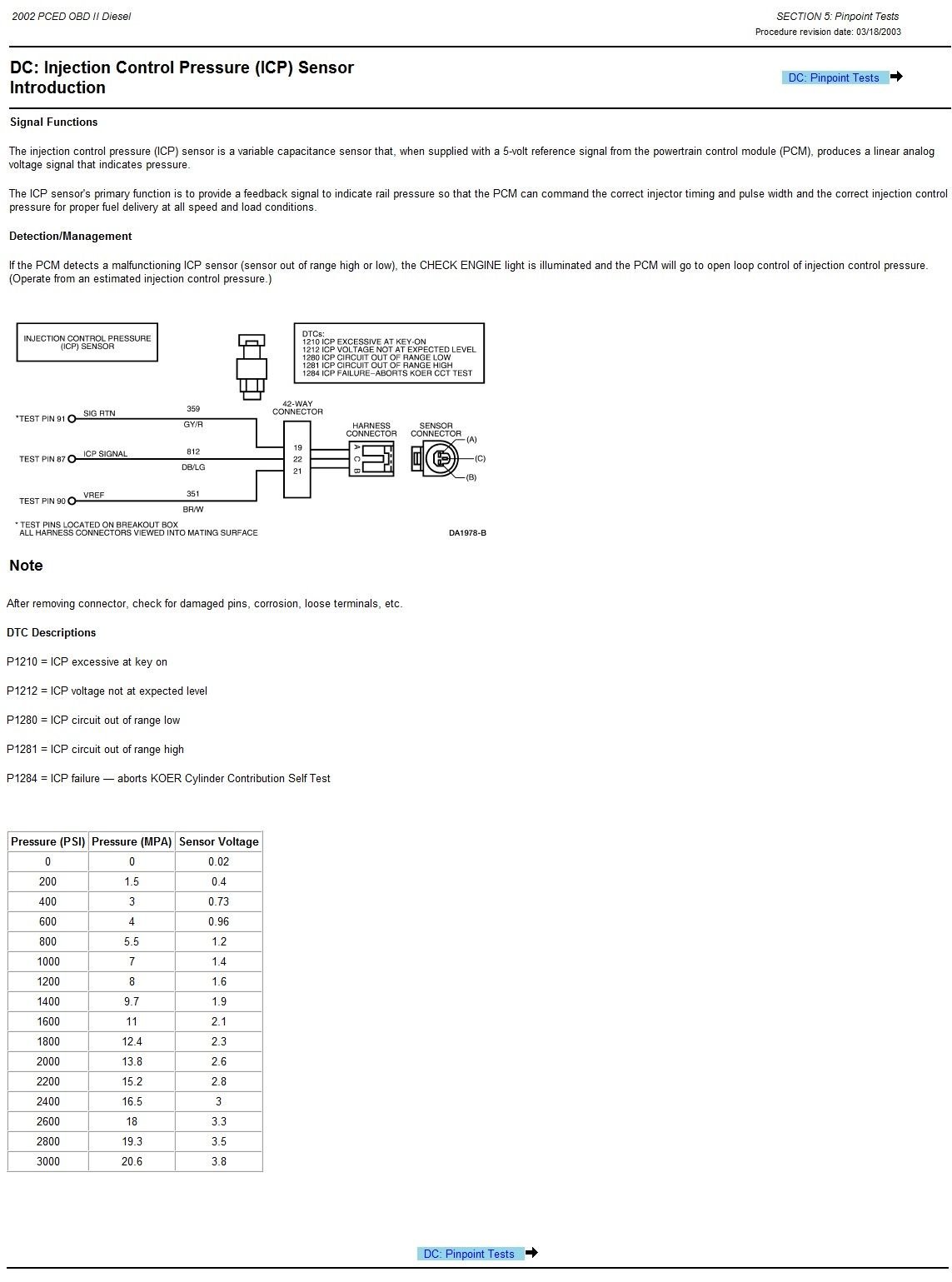

Old Jun 7, 2020 | 07:07 PM
FordTruckNoob's Avatar
FordTruckNoob
Joined: Jan 2005
Posts: 13,111
Likes: 4,716
From: Henderson, NV
These may help.
