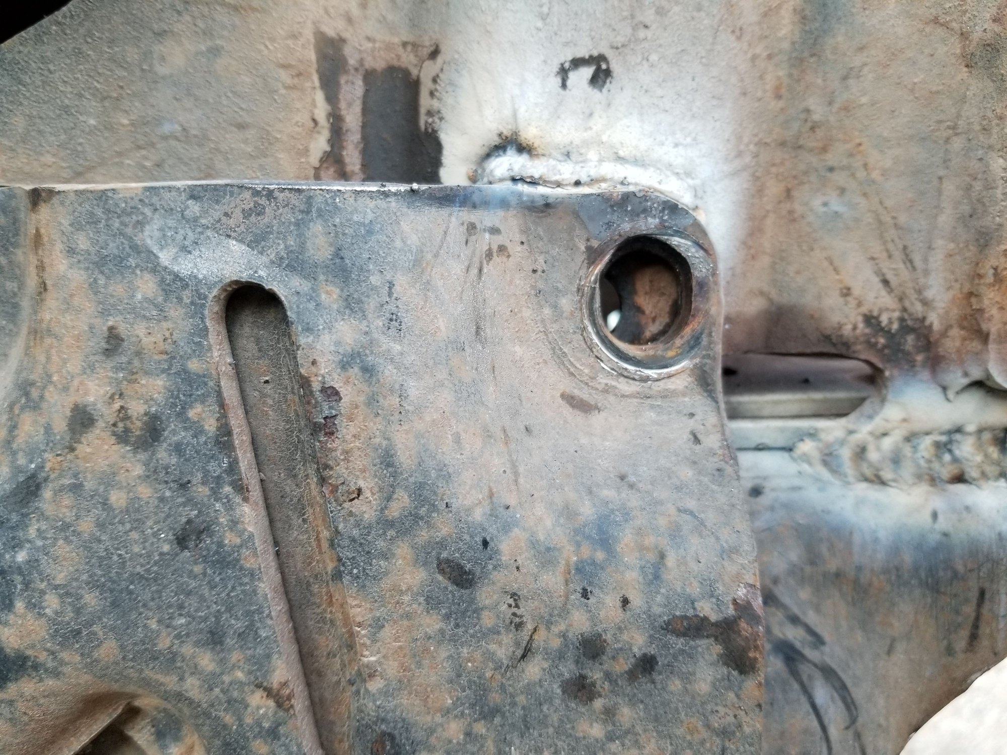

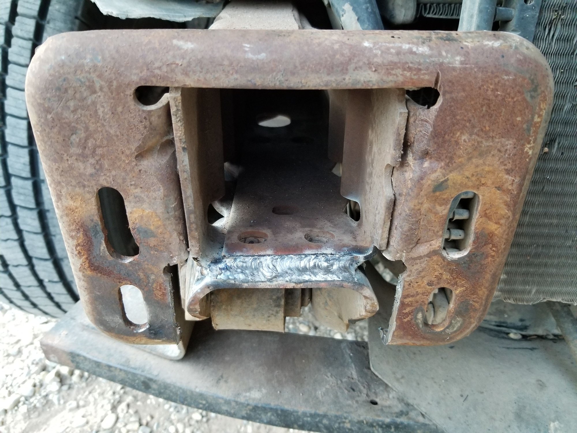

It worked good this way but the shackle angle was very steep. The steep angle caused the leaf spring to become U-shaped and bottomed out fairly easy. To combat this I decided to move the front spring mount forward. What I did was unbolt the front spring mount, shim the shackle to the desired angle ans weld the front mount in place.
The front spring mounts are moved forward about 1/2" bringing the total axle placement to 1.5" forward from stock. This is what helps for running big tires.

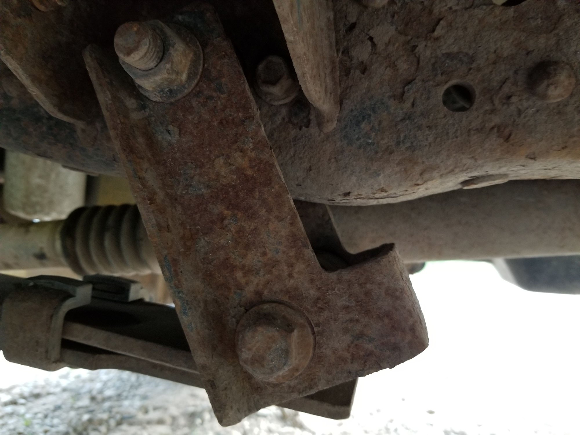

Shackle angle comparison.
U-code stock 7.3 Excursion.
U-code 7.3 F350 front spring mount moved 1/2" forward.

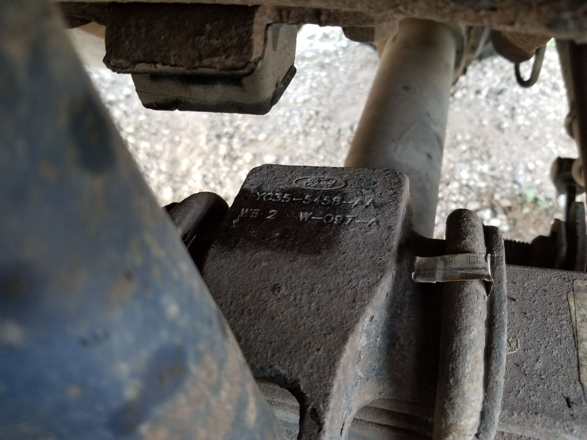

Shock angle with lower mount moved forward.
Bump stop in relation to the lower shock mount.

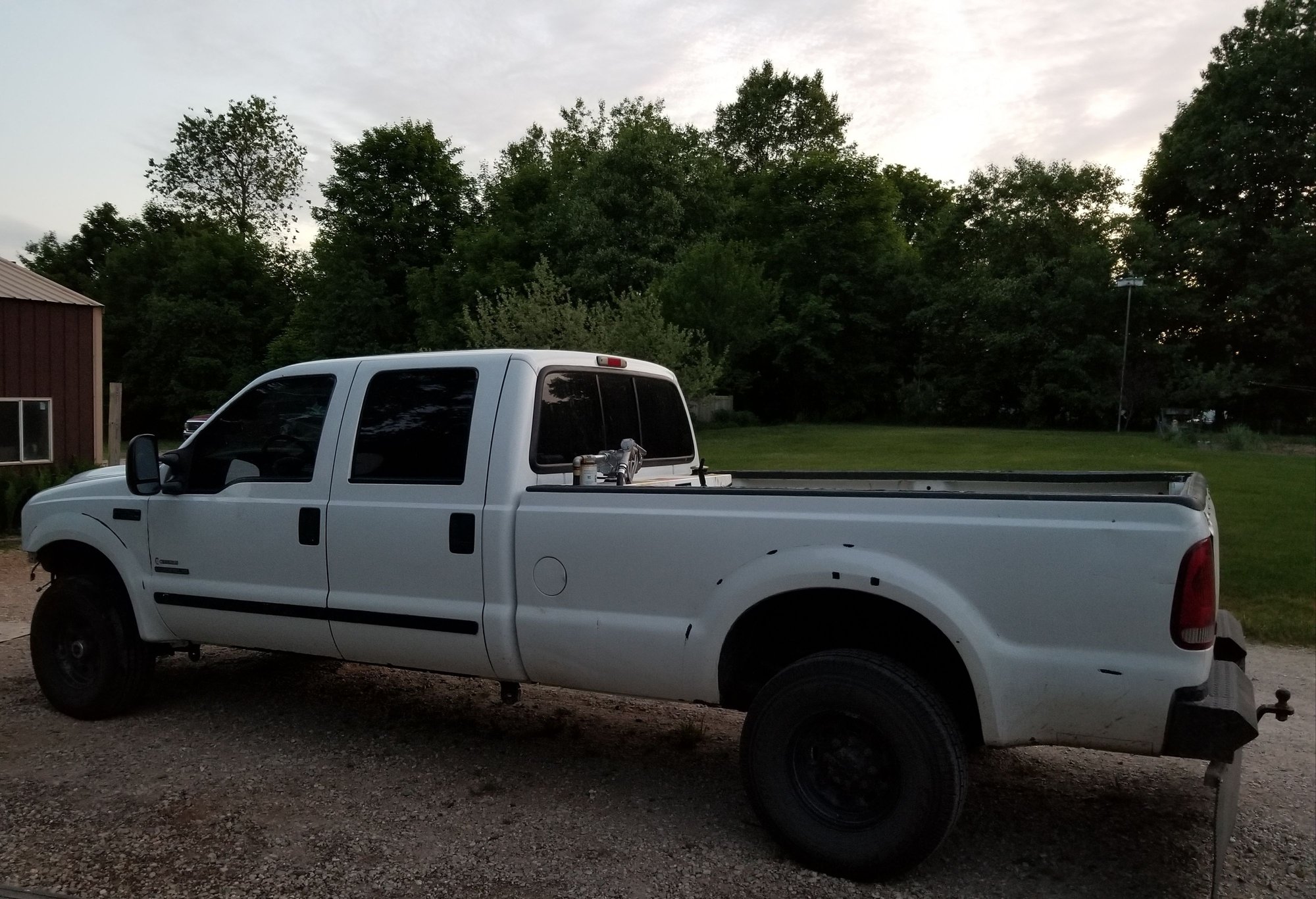

Stance of the truck, has a bit of air in the rear bags to keep it off the overloads.

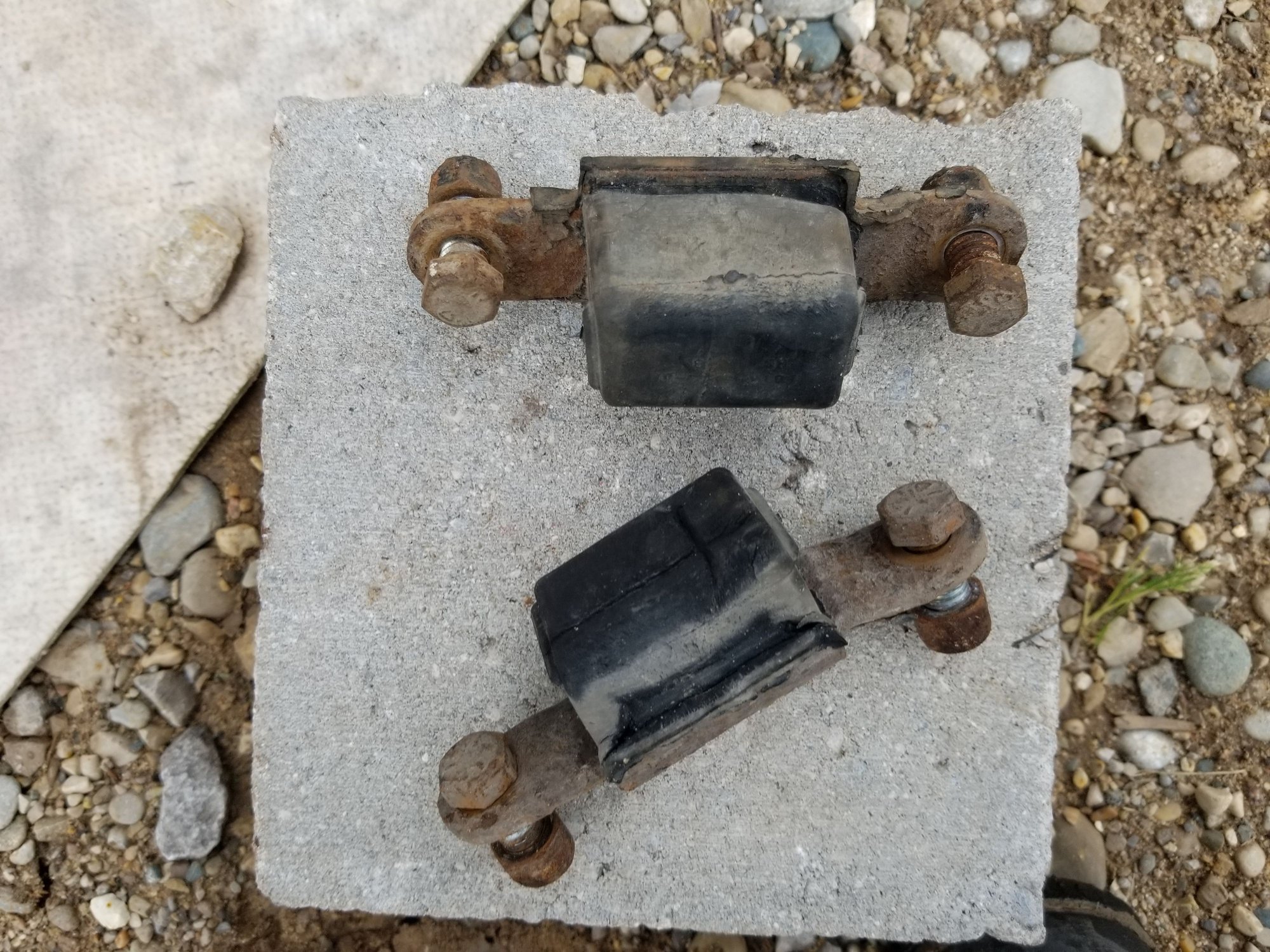

Was unsure on what shocks to run in the front. Previously I have ran Bilstein 5100, KYB Monomax and Rancho. Never liked how stiff the Nitro charged 5100 and KYB were, like 200lb to compress them. Had the parts store bring out everything they had and tested their compression. The Monroe Gas-Magnum fit the need the best. Still Nitro-charged but not as still as say a Bilstein 5100. Has a mono-tube and large body, Made in USA as well.
These are the bump stops that came off.

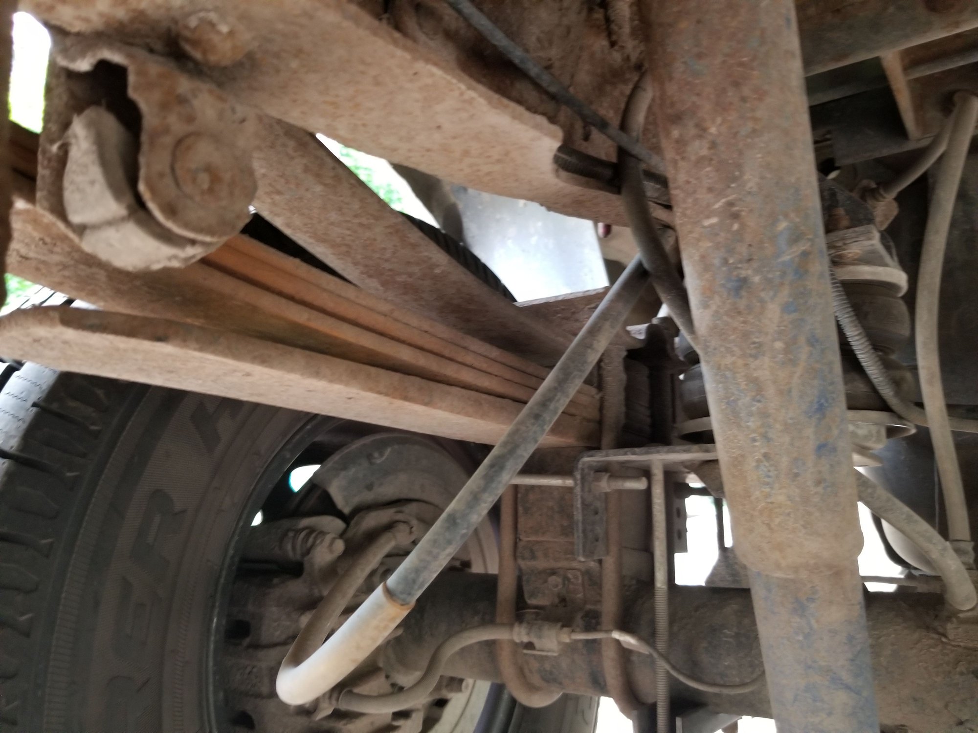

Might as well elaborate on the rear also. The truck started with some kind of ****ty BDS 4-6in lift or something like that. It came with only a 3" add-a-block so I am not sure if the springs are stock, most likely. When I pulled everything off it I wanted to make the rear suspension soft but able to holr a load. IIRC, 3 leafs were removed from the rear pack, all lower spring the upper/lower overload springs stayed too. The stock 4" lift block was also changed out with a 3" one to keep the rear lower. This helped tremendously with ride quality but needed air bags for towing heavy. Went with Load Lifter brand (without internal bump stops). With the softer springs I run 10psi unloaded pretty smooth. Will likely go to a Monroe shock in the rear as well.

You really have the market cornered on some rust there.
Old Jun 10, 2020 | 07:30 PM
brokestroke's Avatar
brokestroke
Joined: May 2018
Posts: 2,442
Likes: 993
Thats hardly anything! Michigan salt is the worst on vehicles. Mixed with lots of mud and being put away wet, about time for some Chassis Saver. Those rear shocks are less than 4 years old.
