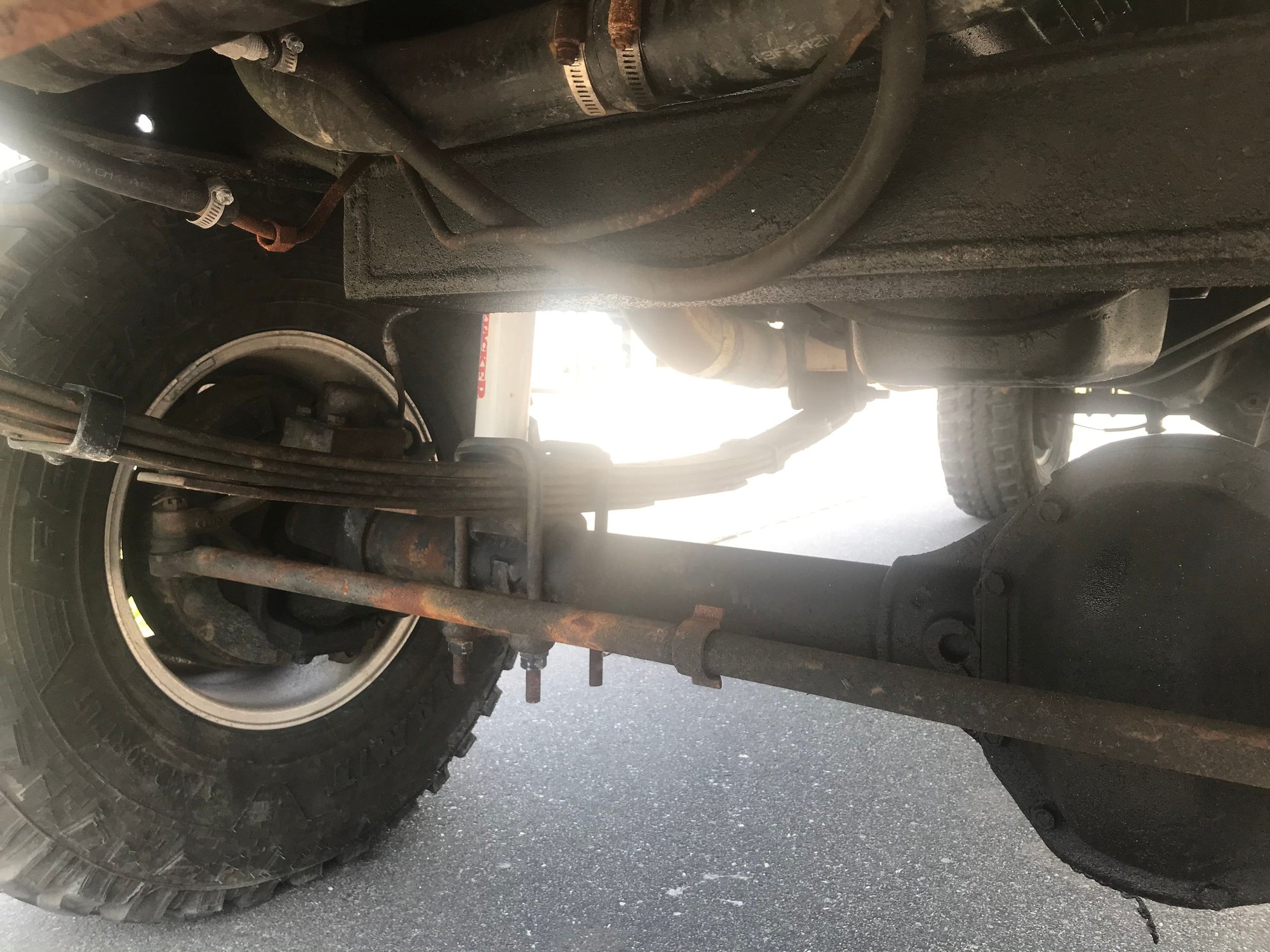

I want to re-visit the crossover steering for my 74 highboy. The current setup is in need of new TRE's and if possible I would rather go ahead an upgrade steering setup while I am replacing parts. I do get some bumpsteer with current setup.
I briefly looked into a couple years ago but wasn't sure if the modified cross-member on my truck would interfere? it is boxed down for the cummins.
Looking for any info on what is needed to make this work, or if its even possible. I have a dana60 kingpin with powersteering

Thanks for the help. Trying to compare pictures and test for clearance
here is my setup now. I think I will use some wooden dowels to mock up and see if it will clear
