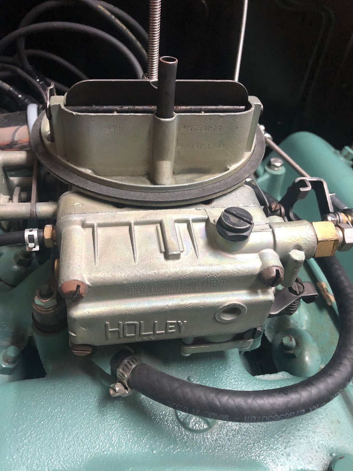

Not sure the exact model. Found the marking List 1772 on it. See pic. Once before I’ve had the air cleaner off and witnessed fuel spraying out of the two venturis while revving the motor. Not so much anymore. When I press on the lever I get another a shot of fuel to each side from what I think is a secondary. It comes out of the cylinder where the Phillips head is in the 2nd pic.

Looks like a common Holley 2300 from here. The phillip screw is the pump nozzles.
Venturies likely plugged up. We hold throttle wide open and shoot shop air in each
venturie you should see a fine mist of fuel.

That spray of fuel you are seeing when you actuate the throttle is from the accelerator pump discharge nozzle, which is normal and good. You should see two good streams of fuel from the accel pump discharge nozzle when actuating the throttle. You are correct in that's the part in your bottom photo, in the middle with the philips head screw holding it in place. With the engine running when you rev the motor that spray of fuel will hit the air stream and booster venturis and atomize . Sometimes looking like it's coming from the booster venturis.
But with that said, that looks like a fairly small carb, so you might see some fuel from the booster venturis when revving the motor. Is the float bowl full? If you remove the fuel level inspection screw on the side of the bowl and shake the truck a little, fuel should dribble out. If the float bowl is empty, there is something wrong with the fuel pump, filter, etc. or it leaked out overnight. I have seen them leak into the motor through poor sealing metering blocks. If the float bowl is empty you can fill it from the vent tube, then see if the motor will run okay for a few minutes. If the float bowl is full and it won't start and there is spark at the spark plugs, one or both idle fuel restrictors in the metering block might have gotten plugged with some debris. They are very small orifices, usually 0.025" to 0.035" depending on the carb model.

After you get it running again, it might be worth double checking the adjustment on the idle A/F mixture screws. Could be something that simple. Plus, stock ignition systems are not as capable of keeping a spark plug clean if the mixture is a little too rich.
Another last simple thing to do just as an occasional precaution is clean the air bleeds on the carb. If you look at the bottom picture of your previous post you will see 4 small brass plugs, two on each side of the accelerator pump discharge nozzle. The outer most two are for the idle and transfer circuits, and the inner most two are for the main circuit. There is a very small air bleed hole in each one. These allow air to enter the fuel stream in the passages inside the carb and emulsify (aerate) the fuel mixture. When they plug the mixture will get rich. Take a can of carb cleaner and with the straw on it and spray it through those bleeds to be certain they are clean.
