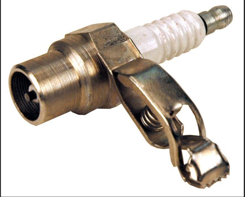

Do what Steve has mentioned. I suspect the spark is too weak. I've seen that happen. For points ignitions I use the tester shown below. If it cannot jump that big gap on the tester is won't jump the small gap on a spark plug inside the cylinder. The big gap in the tester is to compensate for the added resistance created by compression pressure inside the cylinder. The tester for electronic ignitions has even a larger gap.

I think it’s spark as well. I’m thinking a bad condenser.
