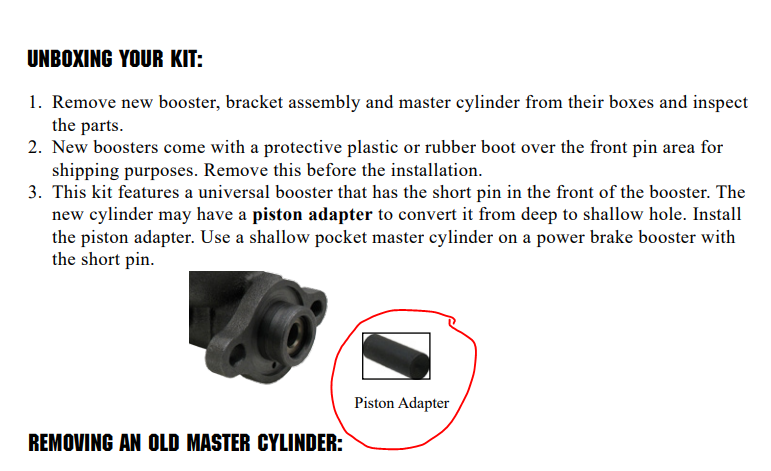

I downloaded the manual for my master cylinder from pirate jack. I realized the kit included an extension adapter that I didnt install (picture attached below). So I threw that on. I had my neighbor pump the brakes and as I cracked the inlet fittings to the prop valve noticed it bubbling air and fluid out. I also removed the outlet fitting and had him press down and hold and it was shooting fluid out strong so thats good. It got dark so we had to stop for the day. Ill keep pumping tomorrow to see if i can get fluid to rears at this point and try the vacuum bleeder again to see if I can get fluid to pull.

So I finally got the brakes to bleed today. I did two things but ultimately I believe it was the white tool I posted above that did the trick.
1) I re-tightened the brake fittings but instead of just apply constant torque I would tighten and untighten a 1/4 turn and retighten, repeating that process for a bit. I noticed it would keep going a little bit further each time forming/seating the the flare.
2) After that I removed the switch in the prop valve and replaced it with the white bleed tool mentioned above. I noticed the pedal starting to firm up. I began bleeding each wheel as normal until pedal was firm.
