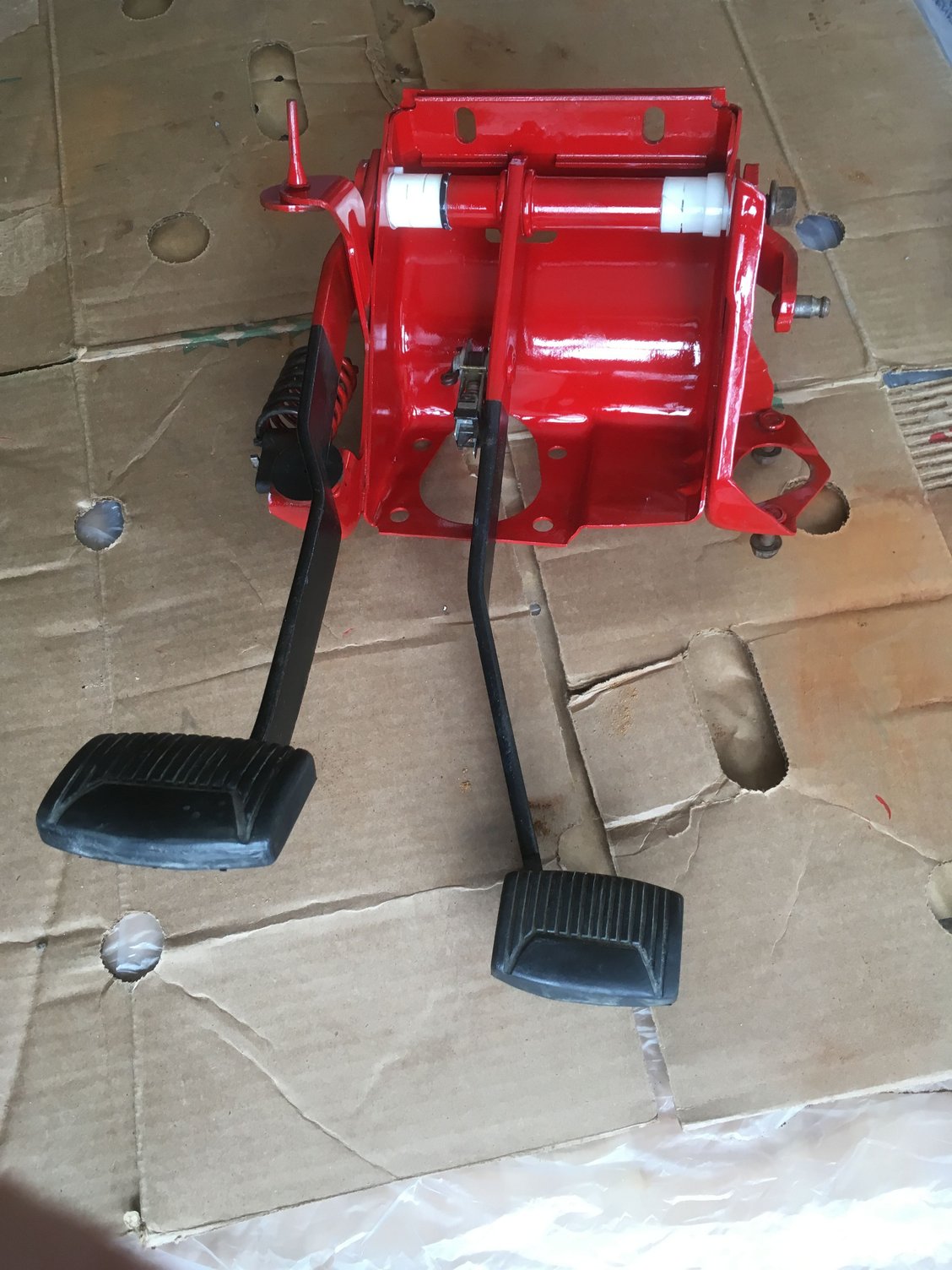

I noticed they could become quite worn if the bushings were too badly worn out. Finding one in a JY should be fairly easy and it should give you practice on how to get them out. Here's mine before and after, just because I liked the look so much.

@Ddaybc dude, that's amazing work!
i don't have those skills so i just bought a new one from Ford. she's my daily driver...
