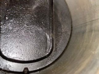

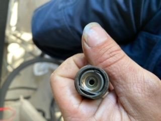

So that set did have the cork gaskets in it but on a better note... even though #4 intake hit the piston at some point it did not bend the valve. I believe the lifter collapsed or leaked down at some point and the pushrod popped up on top of the lifter. The retainer clip in the lifter was broken smashed in two. With a chip out of the top of the ring it clips into. Found all pieces sitting behind the dog bone in the recess it sits in! #2 cylinder has been leaking for some time as evidence by the carbon and burned oil in lifter valley that ate the intake lifter up.
heads back from machine shop and back on the truck. Got the Lower plenum on tonite.
this has been a rather eventful head gasket replacement as the truck now has a new cam, lifters, springs and rocker arms, water pump, balancer, timing set. Replaced leaking 4 piece oil pan gasket with one piece.

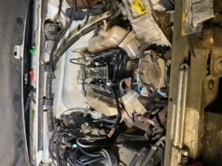

Truck finally back together, had to get longer pushrods for exhaust side. Between running on all cylinders again and the new cam it’s like a whole new truck!
frp lifters
factory rockers
sealed powers pushrods couldn’t get the length I needed even after measuring w adjustable pushrod so ended up putting shins under the rocker pedestals.
comp 35-512-8 cam and matching springs
factory timing set
ultrasonic cleaned and back flushed injectors
motor mounts
freeze plugs.
fixing to replace condenser compressor and accumulator as soon as they arrive.
