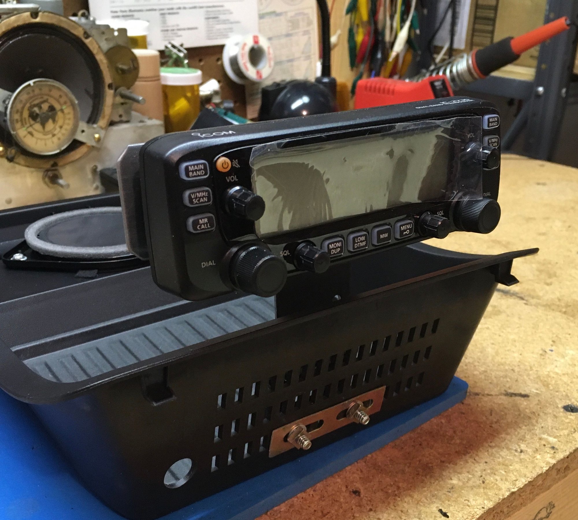

Wanted an easy to reach and view mount but was concerned about it being too obvious to passers by. The dash tray is so hidden and hard to reach that I have never used it and the truck is so high it isn’t visible from the outside either. Anyhow, this friction hinged swing down mount should work for my needs. May need to come up with a sun shade for when the truck is parked but I’ll deal with that later.
Final install waiting for bulk cat6 cable to arrive and RJ12 connector installation.
Head held onto T-Strap with magnets for easy removal. Head position is about a 1/4” above the 12” display top trim piece for easy **** access.
T-strap mounted on a friction hinge allows it to be tucked away when not in use.

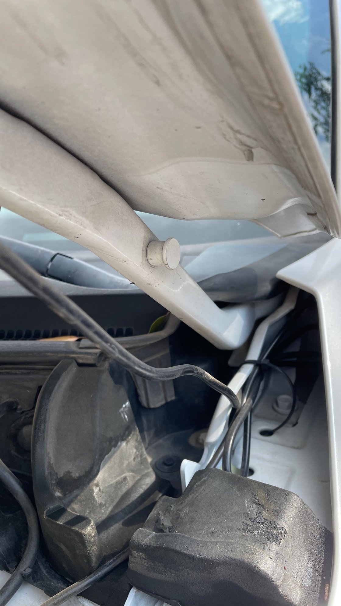

Power goes through the firewall via pass-through wires to a BlueSea fuse block. Ground terminates at the ground lug behind the passenger kick panel. Radio is under the driver seat with the speaker angled up. Faceplate is velcro-taped the the dash. Antenna is wired with RG-58 coax and run up through the floor grommet under the driver side carpet and sealed with black RTV. Handhelds are for stow-and-go and multiple end users in addition to my truck if needed.
Easy, clean, can be removed in 5 minutes if need be.

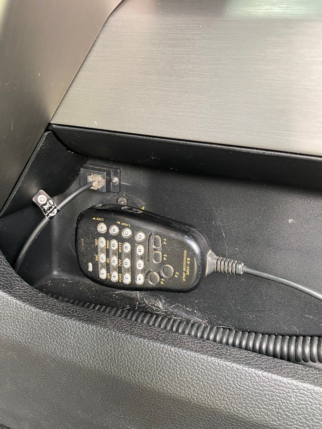

Here is where I mounted my FTM400 mic. Uses a bulkhead pass thru for the wire and a mag mount to hold the mic.

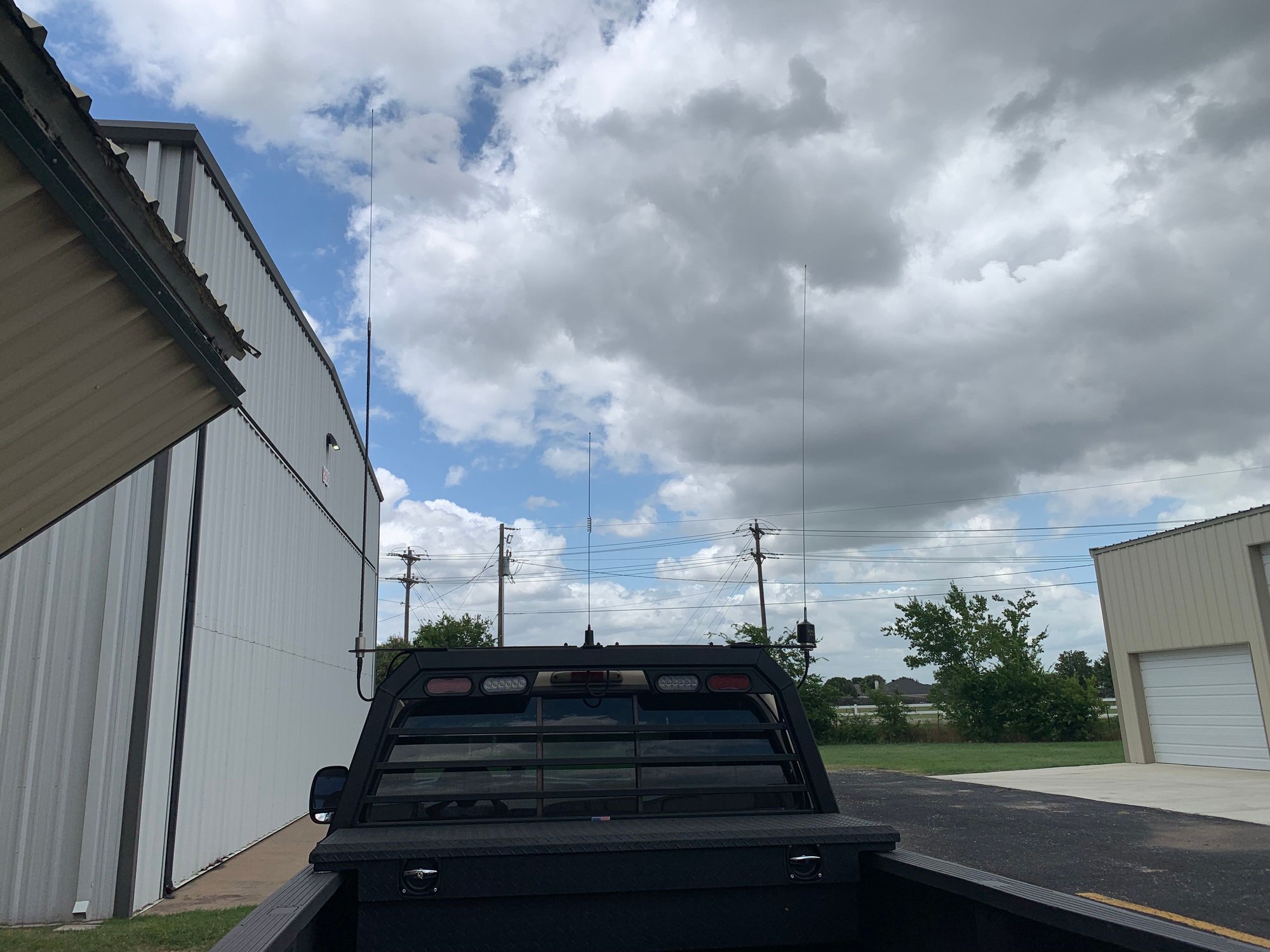

An older thread but I got my radio put in my truck and thought I would share. Im using the bullet point mount for the radio and the bullet proof 3rd brake light mount for the antenna. The antenna is tall but my F450 doesn't fin in my garage, doesn't go in parking garages or in the drive-throughs.

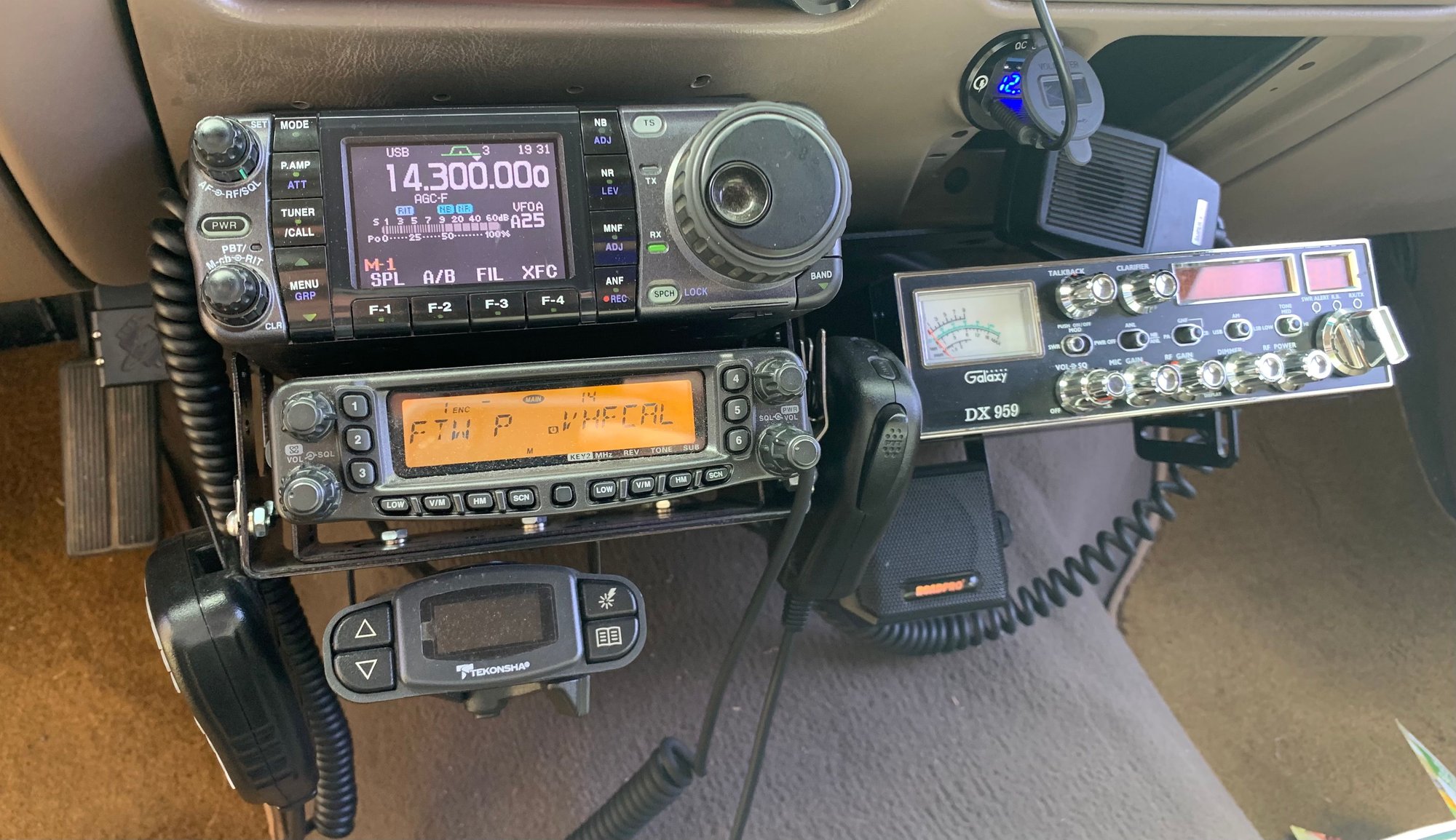

I have a bit more room than the newer rides..
And yes, I see I need to dust again.
