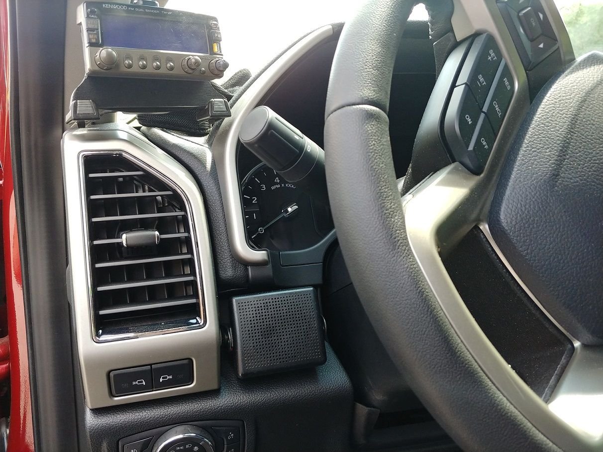

Nokia bag phone comms speaker fits next to steering wheel. Attached with 3M command strips.
73,
K0MDA

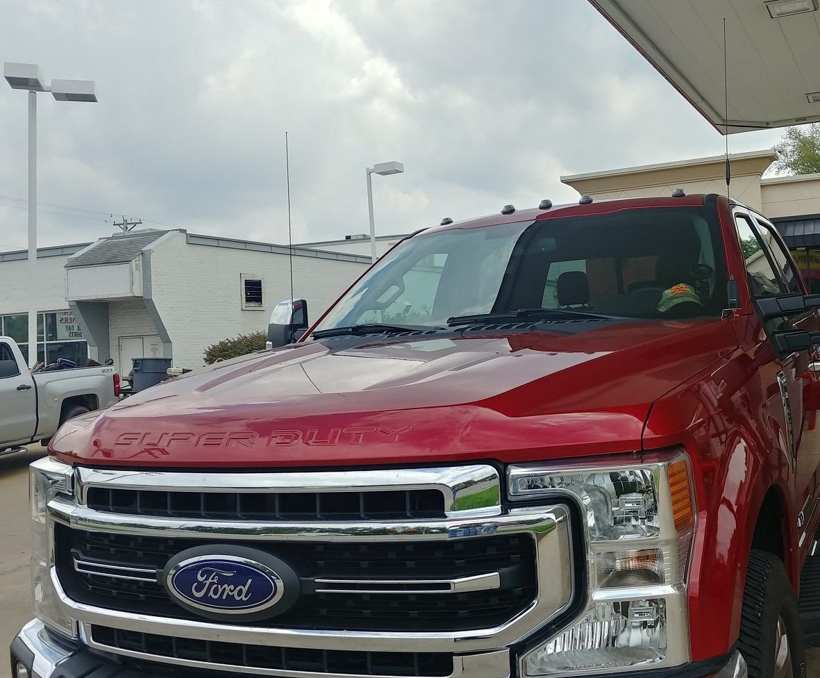

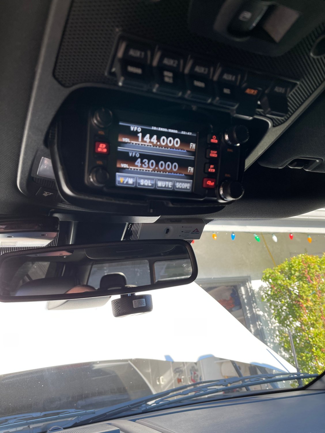

I ran a cable from the upfitter wiring on the drivers side, through a firewall grommet and under the carpet.
wanted a clean look so I mounted the display in the sunglasses holder. Never use it so wasn’t worried about cutting it. Didn’t need to cut it but made it easier to use the dials.
mic sits perfectly in the slot on the side of the console.
Got a little creative with the antenna. Happy with the outcome

Similar mount idea, different placement.
K0MDA

I have the fender mount Mike in STL has and just ordered a Larsen NMO2/70 for it. I don't have the upfitter switches so power probably has to come from the battery. I think I'll try a Lido gooseneck mount for the head. I'm not left handed so that location probably won't work for me...lol! Mike, what speaker is that? W0AZZ
Old Dec 29, 2020 | 03:56 PM
Mike_in_STL's Avatar
Mike_in_STL
Joined: Aug 2020
Posts: 229
Likes: 71
That is an old Nokia HFS-12. Amazing little speaker. I got it as a part of a collection of stuff from a friend of a friend who had passed away. The audio is very clear, and even for it's size, there is enough bass response that the sound isn't tinny. It beat out a Uniden speaker of similar size as the Uniden speaker had a reverb/tinny sound profile.
I'm thinking of retiring the old Kenwood and getting an Icom ID-4100A. The display on the Kenwood is getting really tired even after I re lamped it.

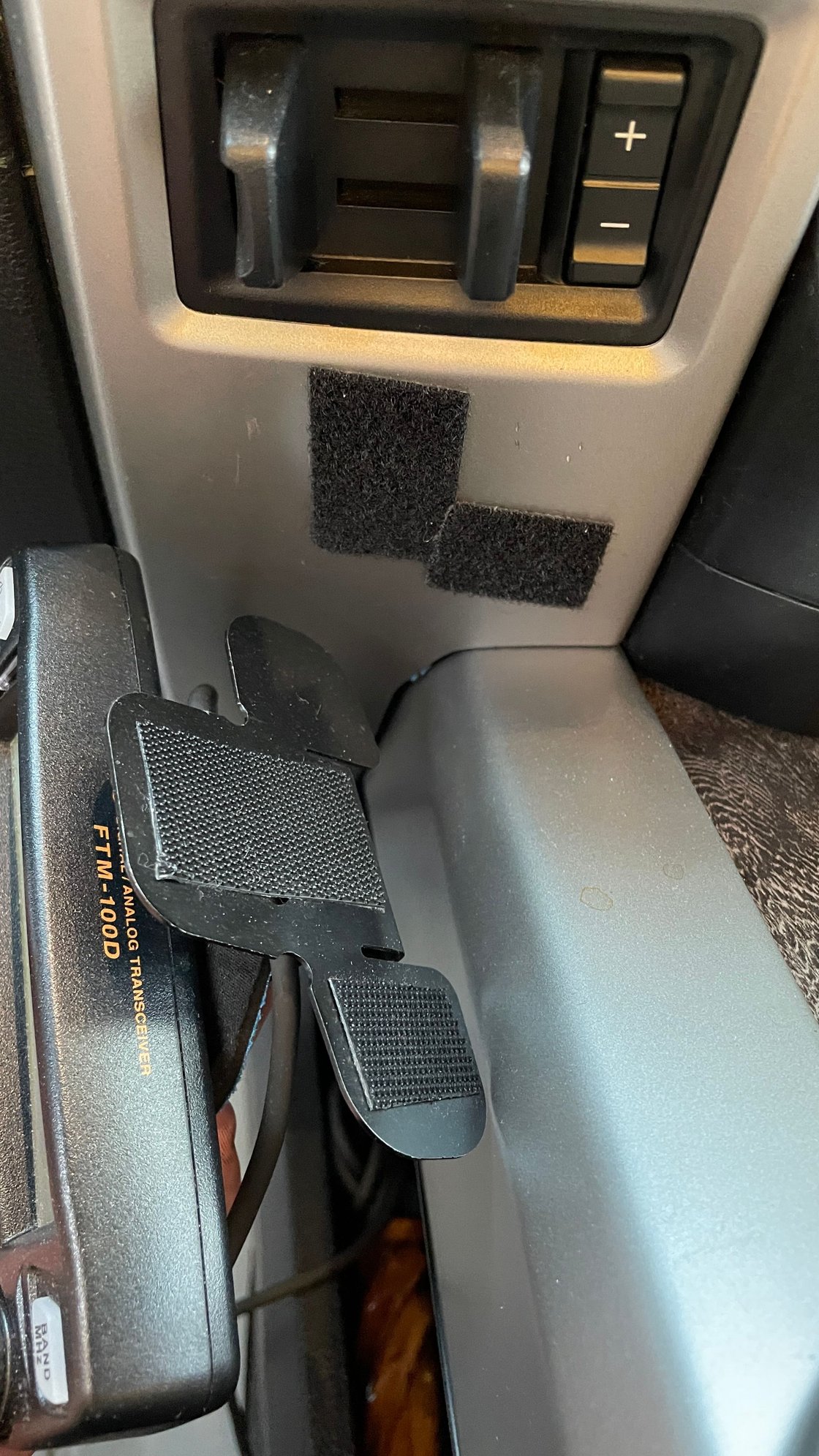

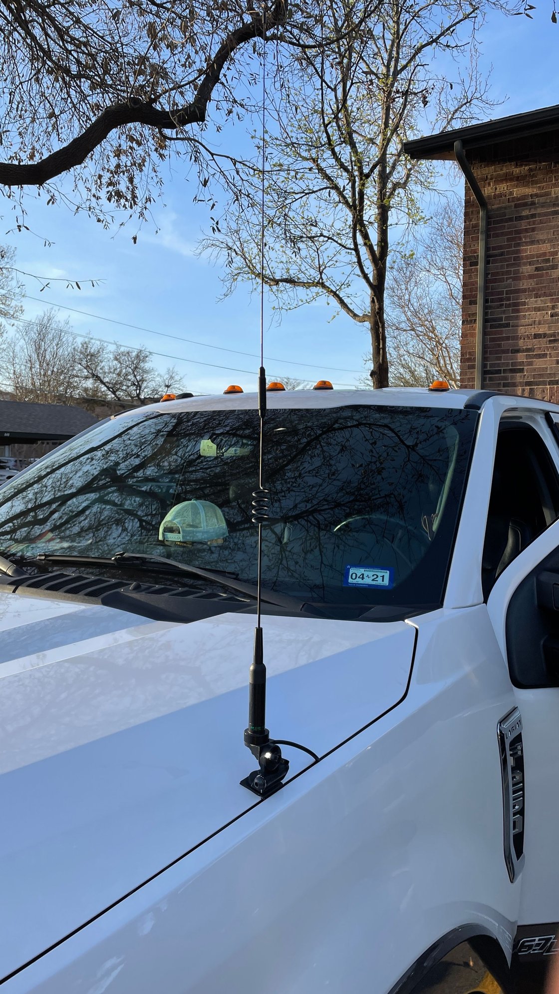

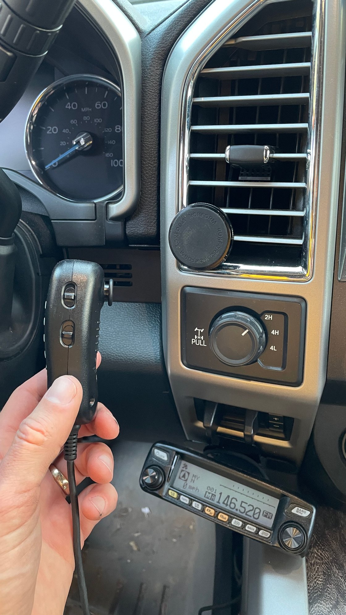

Pretty simple setup on my end. Yaesu FTM-100, Diamond NMO lip mount, Diamond 34" dual band antenna.
The previous Diamond antenna I had was only 1/4 wave and it had absolutely no whip/give. I brushed that antenna up against so many trees on 4x4 roads in Colorado and west Texas, it ain't funny. I could only repair and resolder so much before the antenna just didn't want to antenna anymore.
For this setup, the radio body is stuffed under the driver seat. The faceplate is velcro taped to the dash. The mic is magnetically attached to the vent via a RokForm magnet phone mount. I didn't like my phone being in the way of the vent, so I stopped attaching the phone to it. The little magnet makes for a perfect mic clip.
KG5QHL
