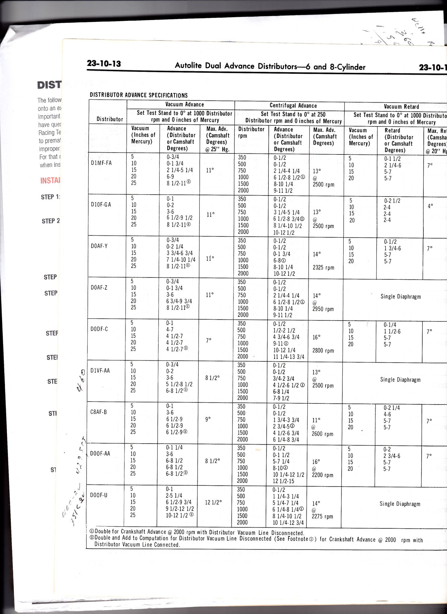

Here is a page from the early 71 car shop manual. This would be non-smog factory settings. Sounds like your distributor is doing what it's supposed to do. And the way you set the initial timing is exactly the way to do it. Advance it until it kicks back or drags when hot, then back off until it starts normal. This is assuming that you are using a good dial back timing light to come up with those numbers.
You can get a little more advance without taking the distributor apart by removing the plastic bumper from the advance plate stop. That will get you another 2 to 4 crank degrees depending on how thick that bumper is on your distributor. I need to add that the numbers represented in the manual are for camshaft degrees and distributor RPM so need to be doubled for crank numbers.

Thanks Crop Duster. This all makes sense and gives me some confidence that I got it set up correctly. We are just looking for a good running setup that is reliable. Willing to leave some hp on the table in order to have a safe setup. Also we are only seeing 15” of vacuum I think due to the more aggressive cam. That will affect/decrease the vacuum advance. My BIL drove it to run errands all day so it was a good test. He said it started easily after each short stop and didn’t get too got even sitting in traffic. It was about 90F ambient yesterday so I’m pretty happy right now. He seems satisfied so I may just leave well enough alone. He is wanting to go EFI at some point so that will probably be my next challenge. I really appreciate the input guys.
