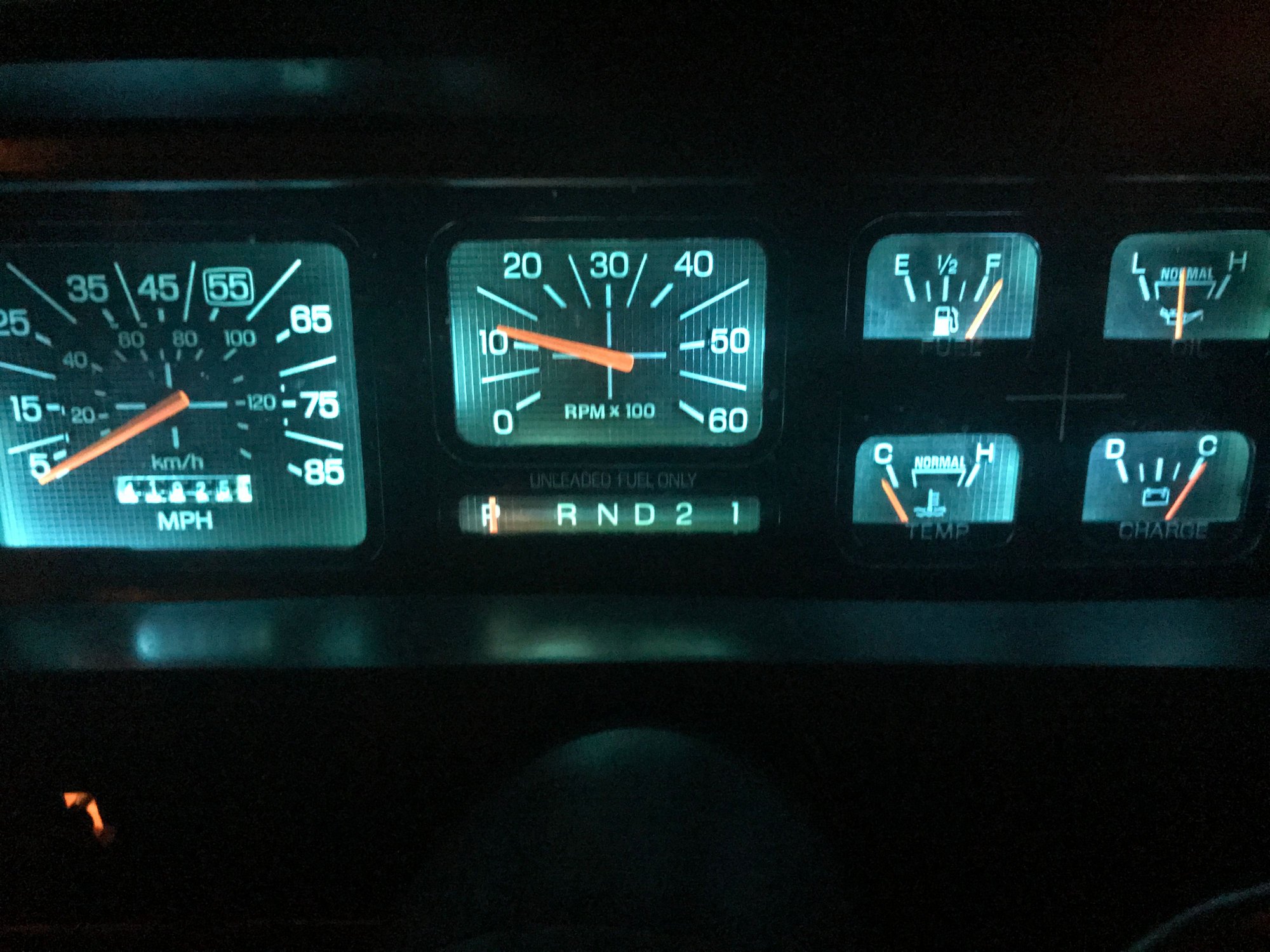

Nice! When I had mine out, I ordered some cheap LED's for the cluster, and left the "green" domes in, the color changed to a teal afterwards, but all are much brighter and use fewer watts than the original incadesents. If you leave the domes out, white lights are pretty bright too. If you want to keep the color green, just order green led's. When you do all of them (including the cig lighter and temp control lights, the lights only dim about half way. I only did ones in the cluster and the remaining incadesents provided enough voltage resistance to allow full dimming. I think it was like $10 for about 25 of them. I bought a whole cluster on ebay for about $85 and swapped in a factory tachometer. I also spent $15 on rocketmans WEBSITE and upgraded my ammeter to a voltmeter. Normally its $45 to send him yours and he sends you a converted one back. I ended up sending him 2 and got 1 back which is why he cut me a deal. (sent him my original and the one from the purchased cluster). Wiring for the tach and voltmeter were super easy. Just suggestions for your project! (and yes, my truck only has 41,925 miles on it)

I also did the LED's for the main gauge cluster but I went with green.
The color is really close to the factory color to match the HVAC, radio & lights / wiper factory color lights but not so bright I need to dim them.
The only thing I will say is I used Testors fluorescent model paint on the gauge needled, they look great in day light but are hard to see in the dark.
I was told its because the paint was not fluorescent type but only by name.
