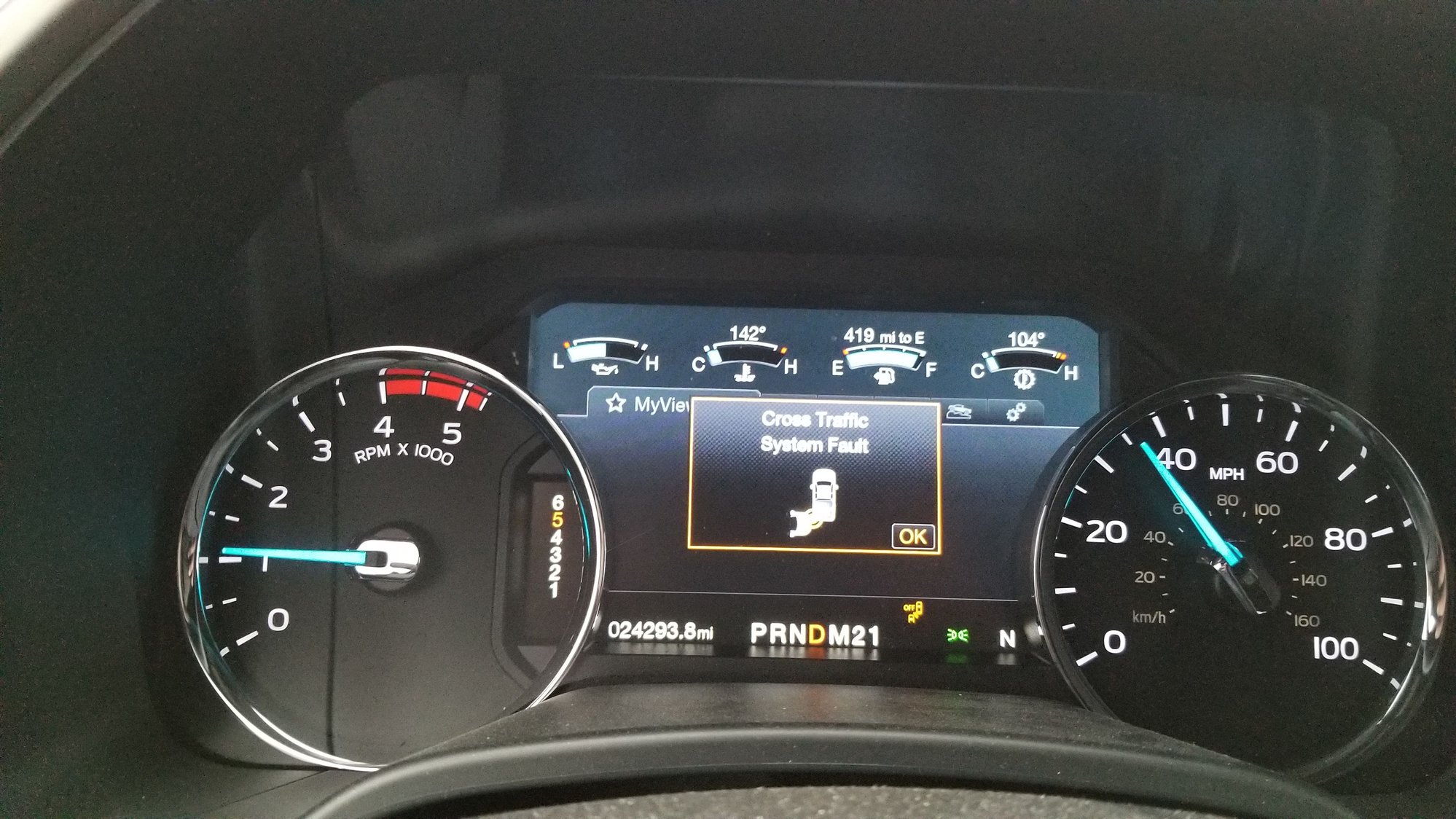

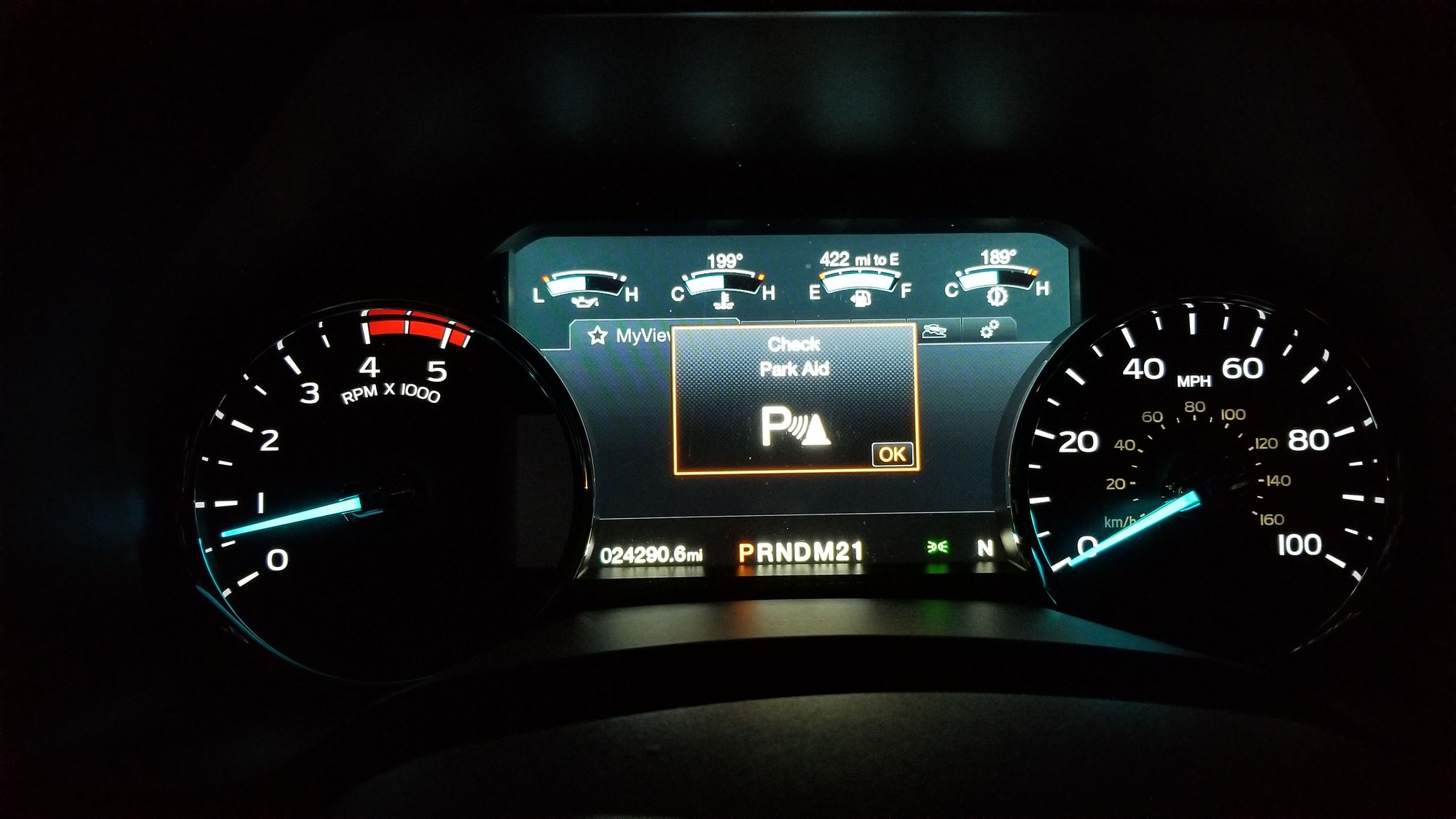

I had similar issue on my 2019 F350 with push button start.
Infrequently when start button was pushed the starter would not engage and I would display. blind spot fault, cross track fault, pre collision assist not available etc. Dealer had it 3 times for a total of 30 days and were not able to duplicate it.
I documented it several times on video. The culprit was the Start/run relay. Contacts were corroded.
I was all set to lemon law it when they found the cause.
