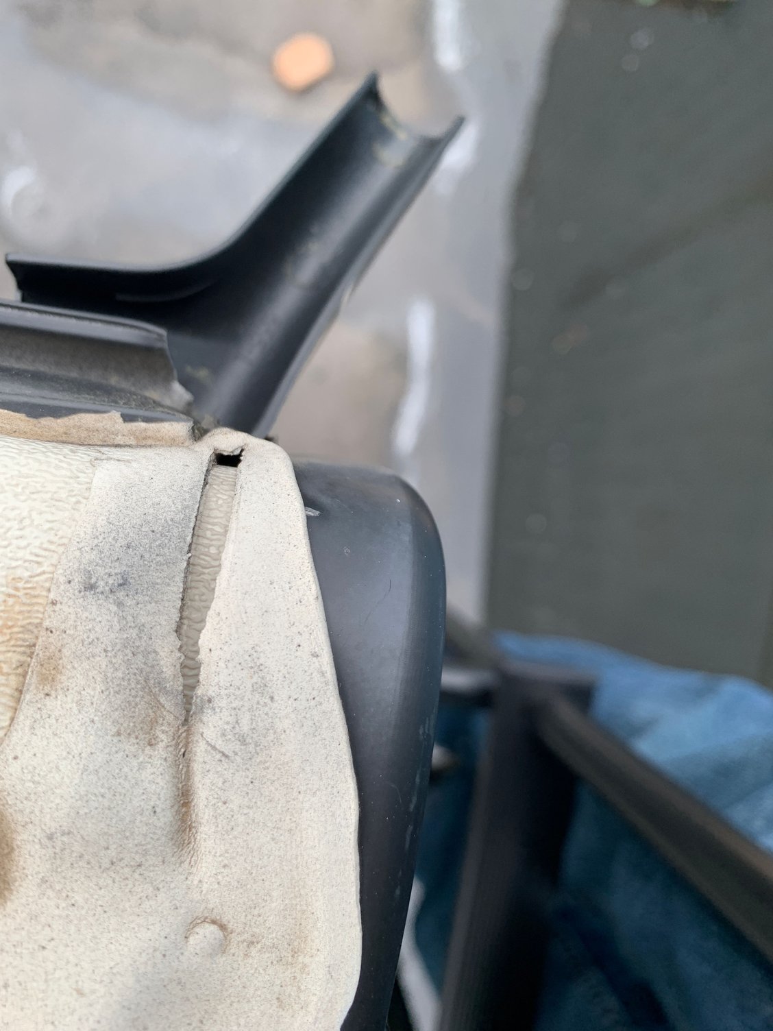

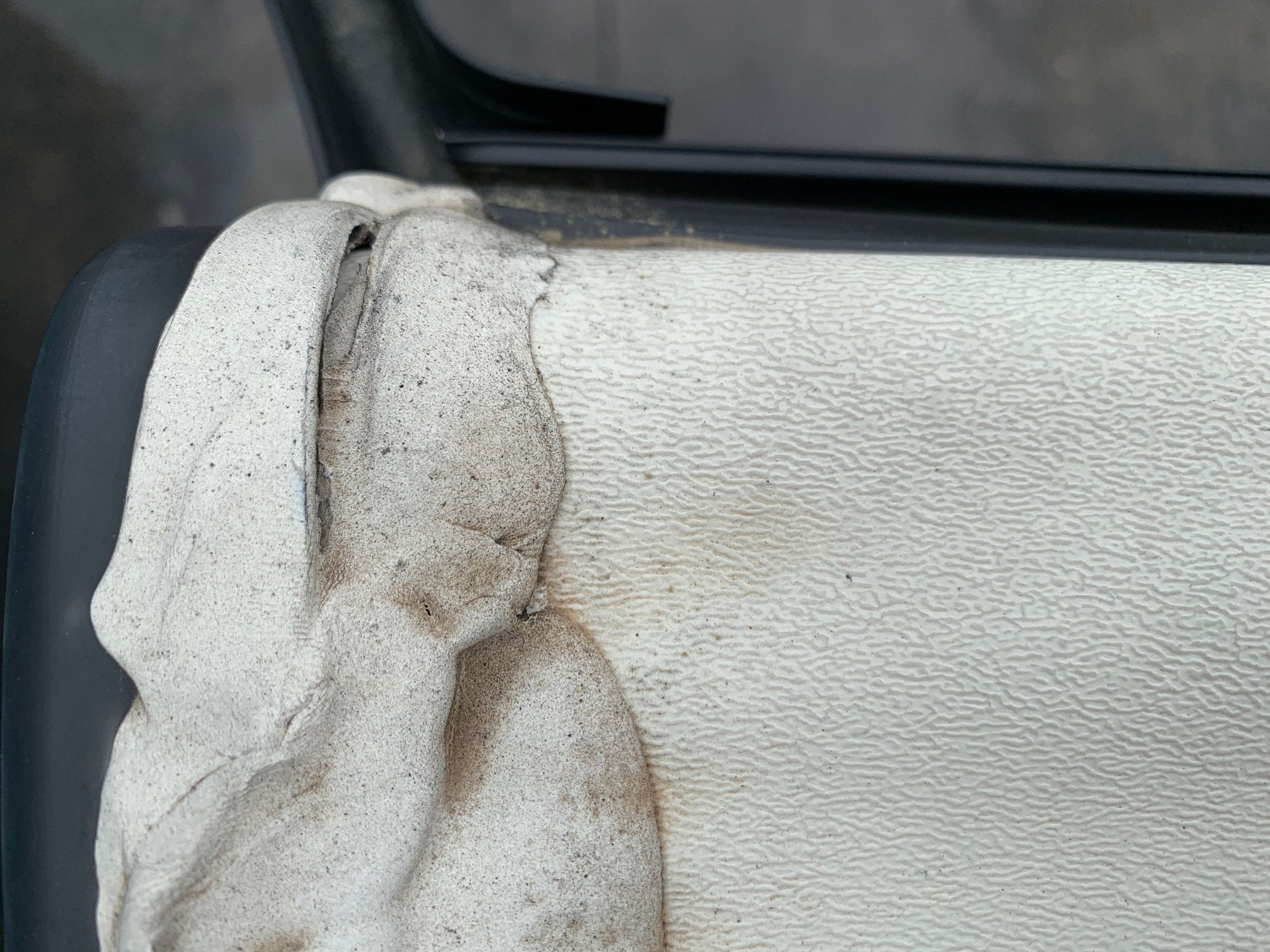

The first one we looked at in Columbus, Oh had trim sagging and just looked dull and faded. It was when I climbed on the roof, I discovered the dicor on the rear corners to have 1" by 1/8" gap which means snow and rain has been leaking down the back corners of the roof. The second one is in Lexington, Ky which we thought was going to be the one! It was dirty but at least didn't have a dull look to it. No sagging trim, but the bedroom thermostat was just hanging by it's wires and missing bedroom door ****. Those small things are cosmetic and not a show stopper. I asked that the unit be plugged into shore power so I can inspect/operate everything before I decided to make the purchase. When I tried to operate the self leveling system it had a "Error LR Jack" on the display". My goal was to hook up my 2018 F350 SRW to check bed clearance, but I couldn't even get the jacks to raise enough to hook up. The front jacks would move a little and the display started dimming and the jacks quit moving up or down. Ok that can be fixed. I decided to move on and perform the roof inspection only to find the same thing! Not only is the rear corners of the roof been leaking but the TPO material on the driver side was separating from the roof. I don't know if water had penetrated and caused this separation or the TPO wasn't installed correctly.
I showed pictures of the roof to the local sales person at the dealership and he said he doesn't know what's going on with Grand Design lately, but they've been seeing quality issues lately. I called my local sales lady at Colerain RV and told her I'm getting frustrated driving around to look at these units just to find leaky roofs. Of course she said Colerain will probably send them back to GD, but I bet they just glob dicor over those corners and sell them to the next person.
I get it, roofs need attention and IMO these dealers need to spot seal these roofs. They don't expect buyers like me to climb up there and inspect the seams. On the other had is GD getting stingy with the materials they're using during the build process. When I purchased my GD in 2015, the dicor was applied very thick. If their really getting stingy on dicor what else are they scaling back? I've also been looking at Jayco Eagles that have been on the lot just as long and have not seen any sagging trim much less leaking roofs.

That separation issue looks similar to the problem I'm having where the cargo door frame attaches to the trailer on my 2006 toy hauler (non-GD of course). From your pictures, that's more than an issue of not getting enough sealant on the seam.

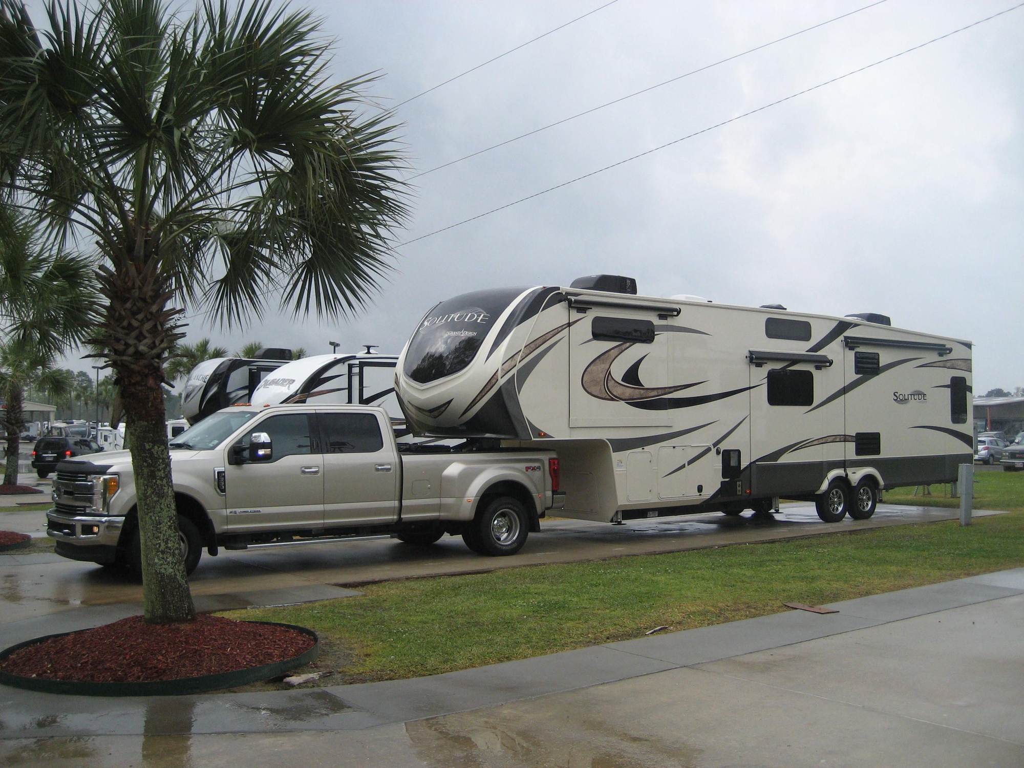

We bought our 377 MBS Grand Design in March of '18. We had the usual pieces of molding falling down just like any other camper builder. The worse part was when I brought the camper into the dealer for its first annual checkup. I told them to check the large living area slide that is hydraulic because it was coming in a little crooked. They said they checked it and by looking at their crappy job of putting the trim back I crossed my fingers. First trip pulling the slide back in it got sideways and broke a weld and got stuck at the campground for 2 more nights. Got a mobile tech to come out and help get the slide back in and I brought it to their shop and had it repaired. It's been fine ever since and brought it back for an annual checkup again...this smaller shop makes the large dealer I bought it from look like their techs just came out of a rehab clinic. Camper has been fine since and I got in the habit of doing a walk around and checking everything before and after a trip. One of my son in laws is a welder and jack of all trades and if I buy him a sack of crawfish or oysters he will come over and fix just about everything I can find. We had a '15 Keystone Fuzion that was the same way lots of small problems that dealer couldn't fix right or didn't want to. Keystone was zero help whereas Grand Design will get back to you if you send them pictures of what the problem is. Across the industry all the manufacture's are having the same quality control problems.
Day we bought the camper

The pictures appear that the edge trim has warped and pulled away from the end. There was a bead of sealant laid down, but it's been pulled apart.
