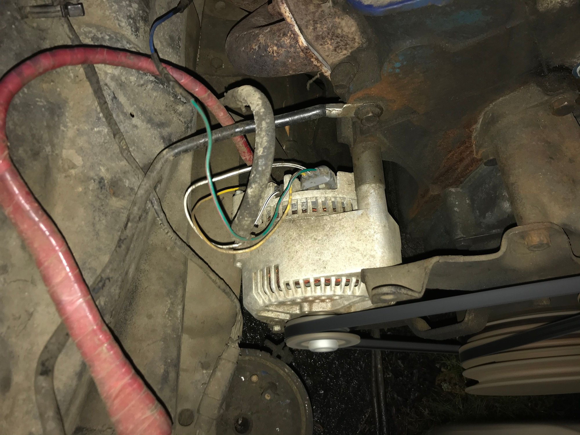

I swapped out the old alternator on my truck for a Delco 10si. Suddenly my truck wouldn't shut off. The alternator was backfeeding power into the electrical system. I ended up getting a little diode pigtail from NAPA tip fix it. So I guess what I'm saying is that if there is a diode or resistor in the voltage regulator it could be your problem.

is it running or dieseling? pull the wire or the belt from the alternator and try it if it is running. if it is dieseling, check the tuning/timing/curb idle/blahh blahh.

This right here is a good idea. Hook your alternator back up and take the belt off instead. That should narrow it down some

Ok so I have done nothing to my truck since the last time I posted except for I pulled the battery and took it to get charged. Now I’m hen I was putting the battery back on I connected the positive and then when I put the negative on the post the engine started to crank. So I decided I would see if I could start it this way but once the engine is started I removed the negative and it dies. There is some serious wiring issue I think lol. Also it turns out someone put a alternator that doesn’t belong on this truck and deleted the voltage regulator and put a inline diode in it.
