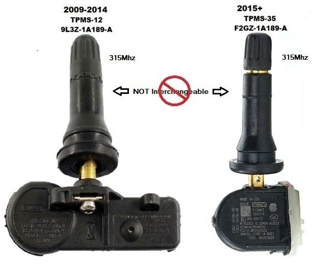

Pictured is a 2015 rim will this fit on a 2011 the off sets are the same and will the tire pressure sensor the same , thanks

They will work fine, the TPMS will not work with the older truck.

Can I put 2011 tire pressure sensor on the 2015 rim

You will need to install the correct tire sensor for your 2011 F-150 onto the 2015 rim if you intend on installing onto your truck if you don't want the tire pressure sensor fault message to display.

Unless you've recently installed new TPMS sensors in your 2011 rims, you would be more betterer off to purchase new. REASON: Battery life expectancy is ~8years.
When buying TPMS sensors get OEM Motorcraft. REASON: Less hastle initializing, less RFI interferance, and, in general, higher quality.
NOTE: *new* Motorcraft TPMS sensors are available on eBay® for not much $$$. Have purchased several sets of the past few years (since 2009) and have never had any issues. HINT: Review the sellers' rating and sale comments.
The only issue you will have with the gen'13 (2015+) wheels is that due to a change in the mounting flange the lug nuts will stick-out slightly more. NBD ... It's only cosmetic.
