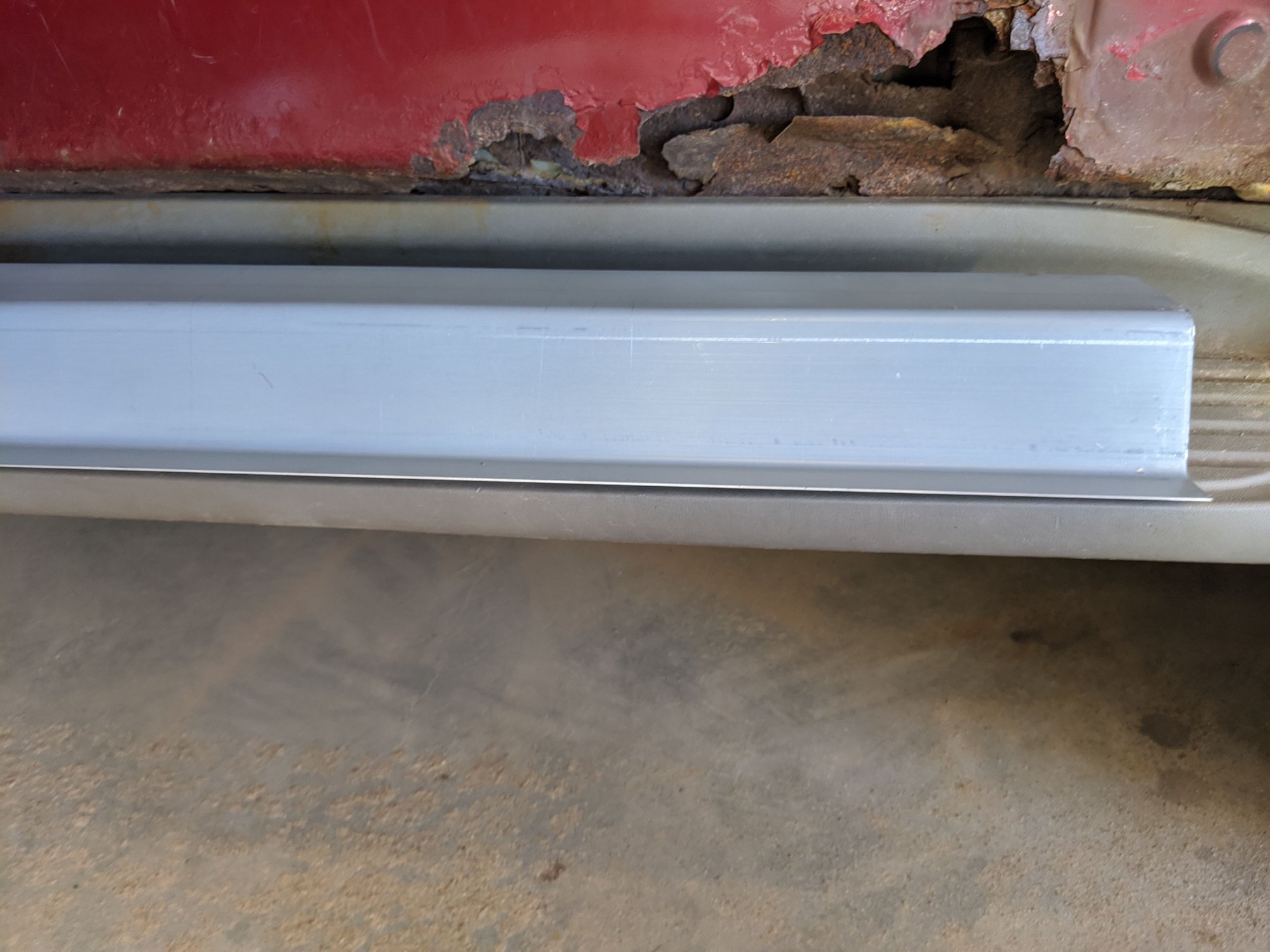

The rocker panels ARE NOT all the same as the super duties. Front driver and passenger are the same. Rear doors are not. The super duty stuff is the same shape, just too short. There is only one place that sells complete rocker specific to the excursion. https://www.etsy.com/shop/SEMichiganAutomotive . They have full length inner and outer. In fact I ordered a full set of inner and outer from them and fed ex delivered today. Very high quality. This is one of the outers. I put it on the running board to make sure it was actually long enough.

I didn’t think there was a way to search the excursion section alone. I had a feeling they were different shaped and I didn’t know about the bottoms if they were the same length or just shorter on top. So it sounds like I’m gonna have to use that eBay source to get them. Yeah they got a love how they make the excursion a little more complicated but we had a live the king of SUVs.

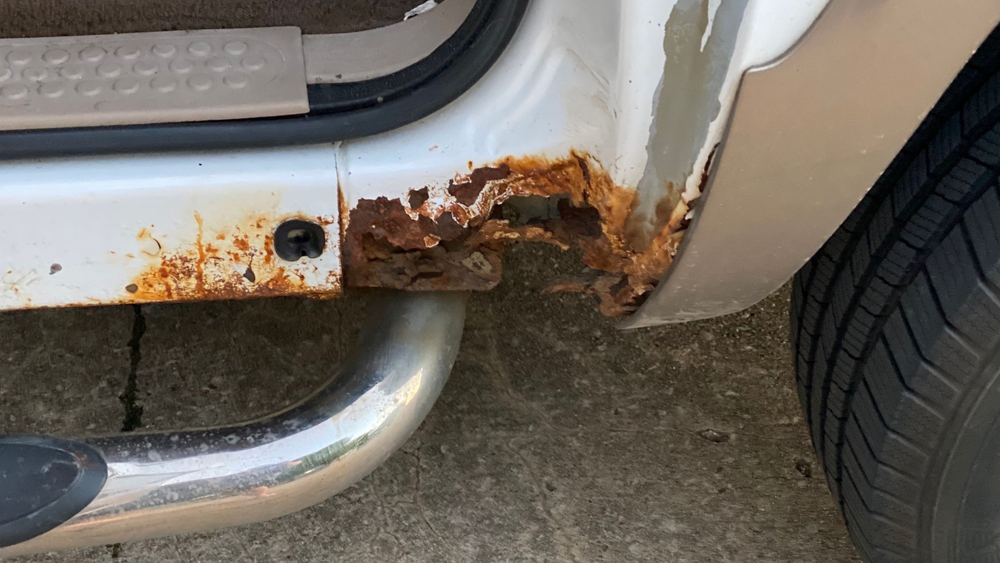

Yeah took pictures last night. Mes fronts are decent except for pinch welds but the rear c pillar on drivers side needs to be fabricated Mes begging to think. Body shops love to mark up labor on that. But can’t do a amp-research drop step install till it’s fixed Mes don’t think.

your passenger side was like both of mine were. I was able to save from the raised circle section and up and just rebuild the bottom. That driver side is bad. You are pretty much going to need a nice southern donor and have those sections cut off and then weld in place on yours.

The dog legs are no longer around anywhere that I have found. Only option is to custom fab or find a good one out of a junkyard which if rust is a problem in your area it will be almost impossible to find something locally. There is also some confusion about rockers for the rear doors on the excursions. The inner and outer rockers ARE NOT the same as the super duties. The inner and outer rear door rockers for super duties are too short.

Yeah even Maaco said they were going to have to sublet that part of it to a professional fabrication shop. But honestly I was surprised at the price for their best paint job with all the rust repair. Only $6,030.75 ont best paint service they offer
