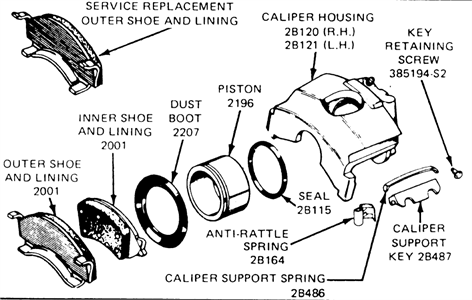

I am having a problem getting the caliper retainer in. It's a tight fit by it's self and no way the spring is going to fit. The calipers are reman ford units. The retainers are aftermarket. The truck is a 76. I have no idea what is going on.

Are you talking about the caliper support key? I had that problem with my 73 when I got reman calipers. First thing I would try is seeing if your old key fits. That worked on one side for me. What I had to do on the other side was gently file the key (a little more so on the end that goes in first) and then tap it in with a hammer. Don't file too much though, file a little and check. If there are any burrs on the caliper itself where it slides in, knock those off.

The key has 2 notches because it's universal for both sides you can't get it wrong. it's chinese reproduction keys you're fighting toss them and use the originals.
