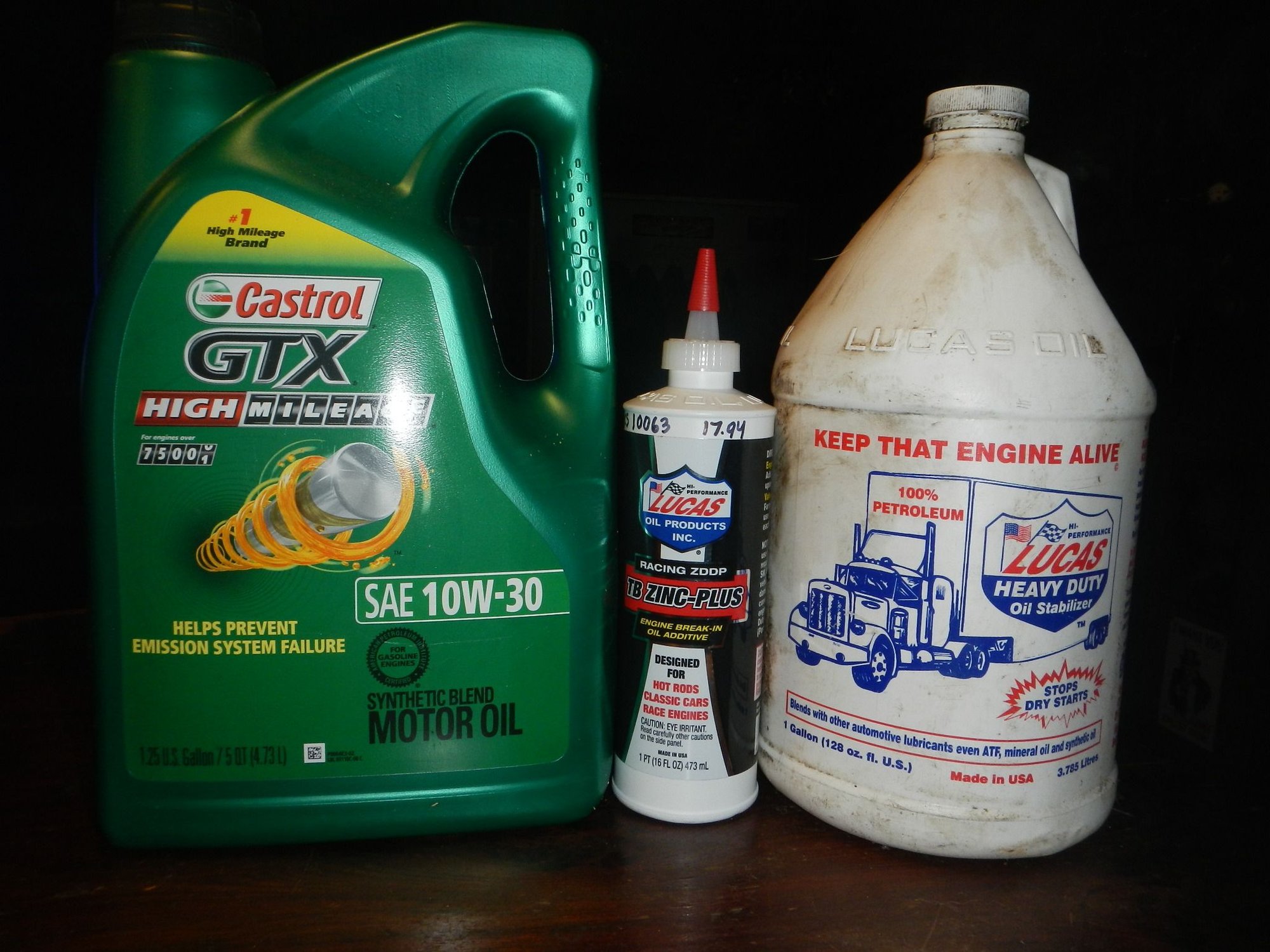

Here we go. 5 qts Castrol, 1 pt ZDDP, 1 pt stabilizer and a Napa Gold filter. About $80

I run the zinc for the cam and the stabilizer to prevent dry starts after sitting for a week or 2.
