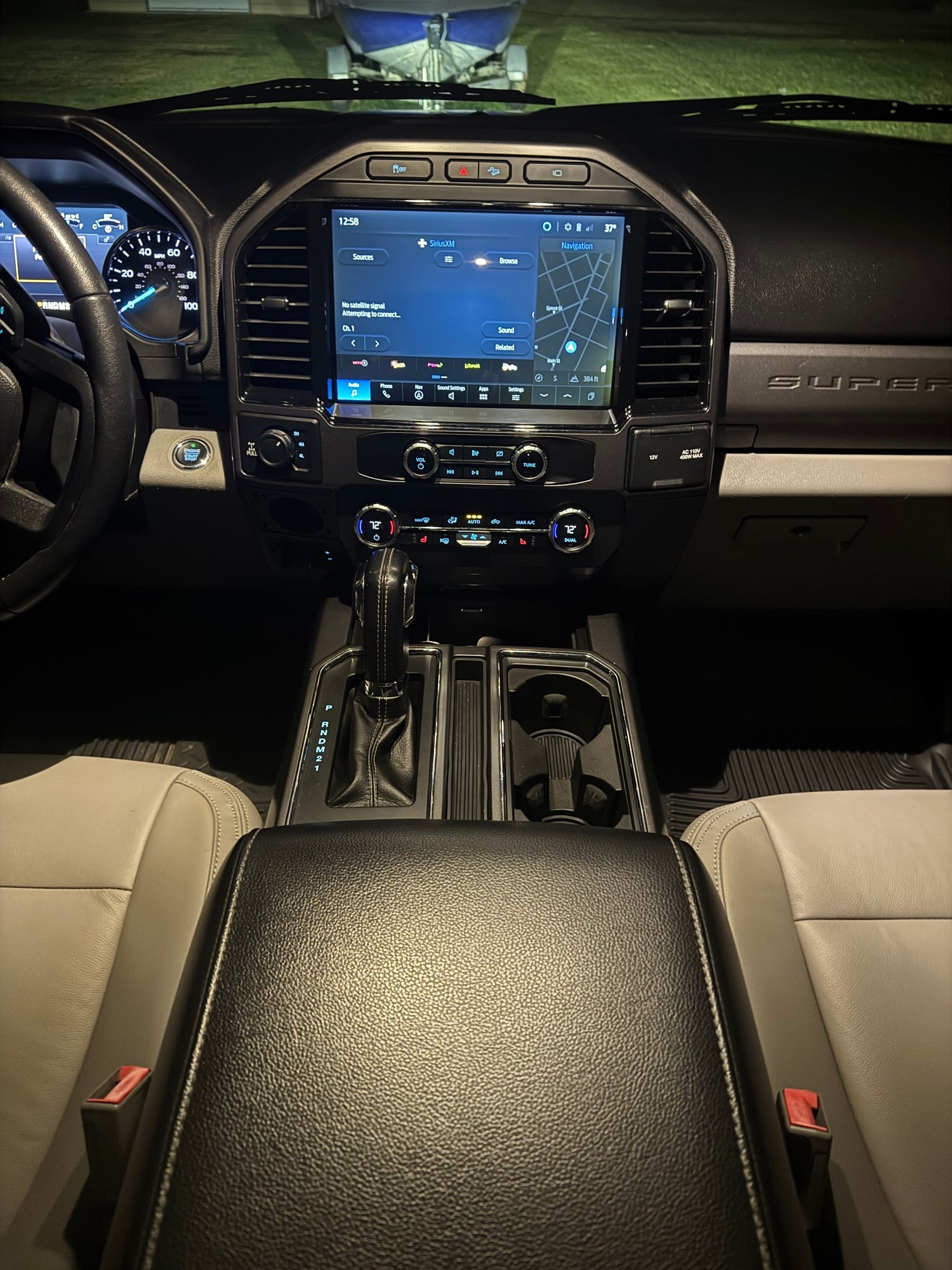

i did this upgrade in my 19 xlt. Instead of buying a whole console I 3d printed some spacer plates with holes for the cupholder/shifter plate clips to lock into. Saved little money in not having to replace the whole console just glued the spaces in and replaced the top trim plate. If anyone wants the STL just pm me, it won't let me post it here.
Where/how did you do the 12" Sync upgrade? Expensive? Use this kit?
Old Nov 14, 2025 | 12:42 AM
  #58
fastbike02's Avatar
fastbike02
Joined: Jul 2024
Posts: 35
Likes: 11
I used parts of the Sync4 kit along with a bunch of oem parts... wouldn't recommend unless you can get a used kit cheap like I did!
Thanks for the response.
  • Why'd you need a bunch of OEM parts? The kit looks like it has most for the conversion.
  • Why wouldn't you recommend it?
  • Where'd you get a used kit and may I ask how much did you pay?
  • Are most ofthe supplied parts truly OEM? One video I saw suggested so.
I was looking at this one.
Old Nov 14, 2025 | 11:55 AM
  #60
fastbike02's Avatar
fastbike02
Joined: Jul 2024
Posts: 35
Likes: 11
  • Are most of the supplied parts truly OEM? One video I saw suggested so.
I replaced the following kit parts with oem parts, the apim they send is a knock off and known to have issues, the screen is a knock off and known to fail, the ac controls do not come with the kit. I don't recommend it as it's not 100% working as you will loose functions like fordpass, heated mirrors/backglass, navigation, and 360 cam on screen soft buttons, they say all this stuff is fixed with the 2025 kit but they won't sell the parts/programming to anyone who they can't confirm originally bought the kit from them(really shady). I got my used kit off FB marketplace for 500, lots of used kits for sale as people are sick of trying to get it to work properly. IMO the best kit would be use fordsync4 plastic trim and screen mount and infotainments upgrade kit as infotainment uses oem parts and has more of the functions figured out and working.
