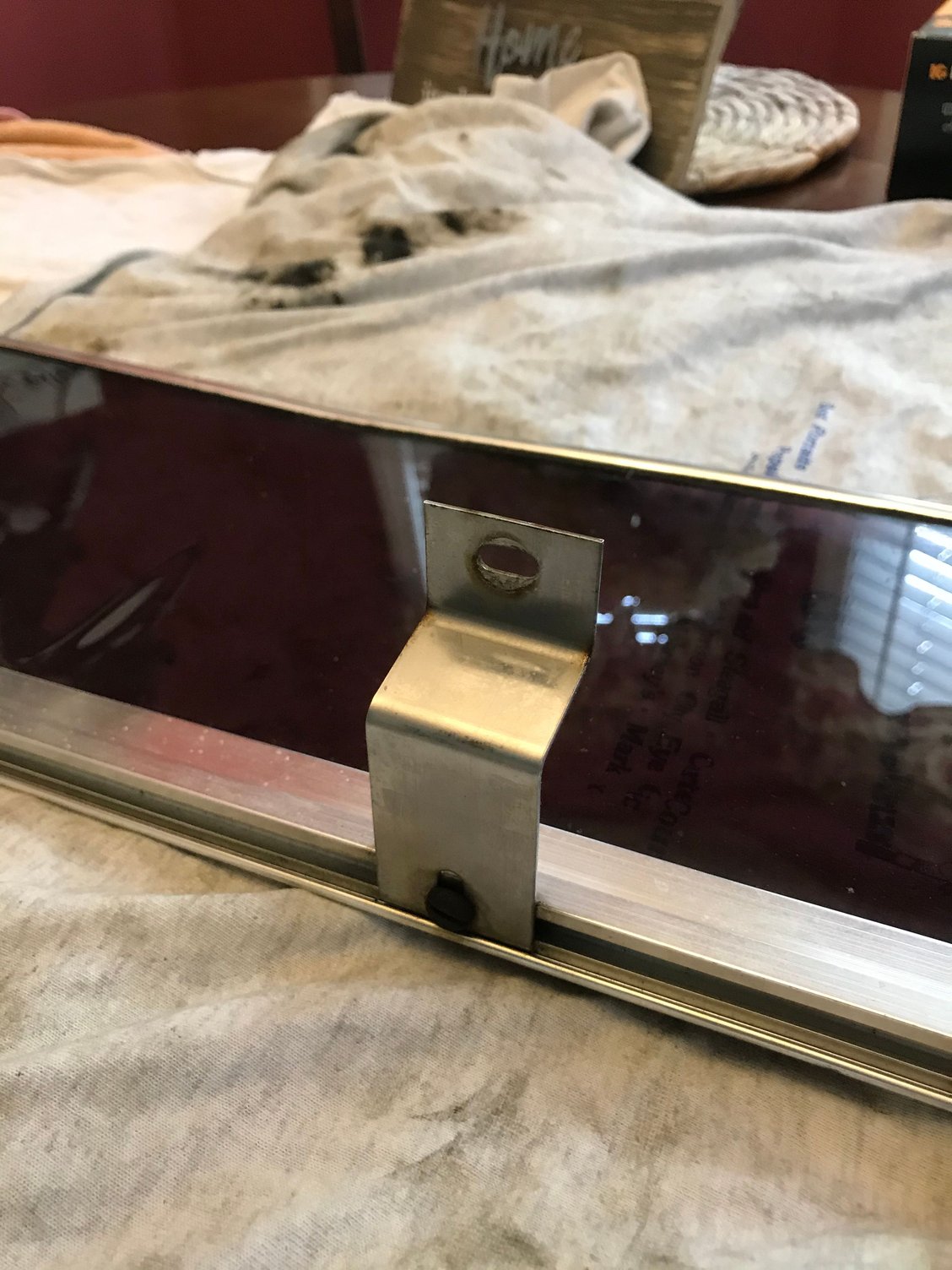

I recently acquired this deflector from a friend who’s dad had one of these trucks back in the day. Apparently it was removed and been hanging in the barn for a while. Still on the fence whether to put it on or not but my question is for those who have them, is the only way to mount it is to drill the hood for the brackets?

Take those brackets off and flip them over. That will allow the deflector to follow the front of the hood up and over the aluminum Grille Shell.

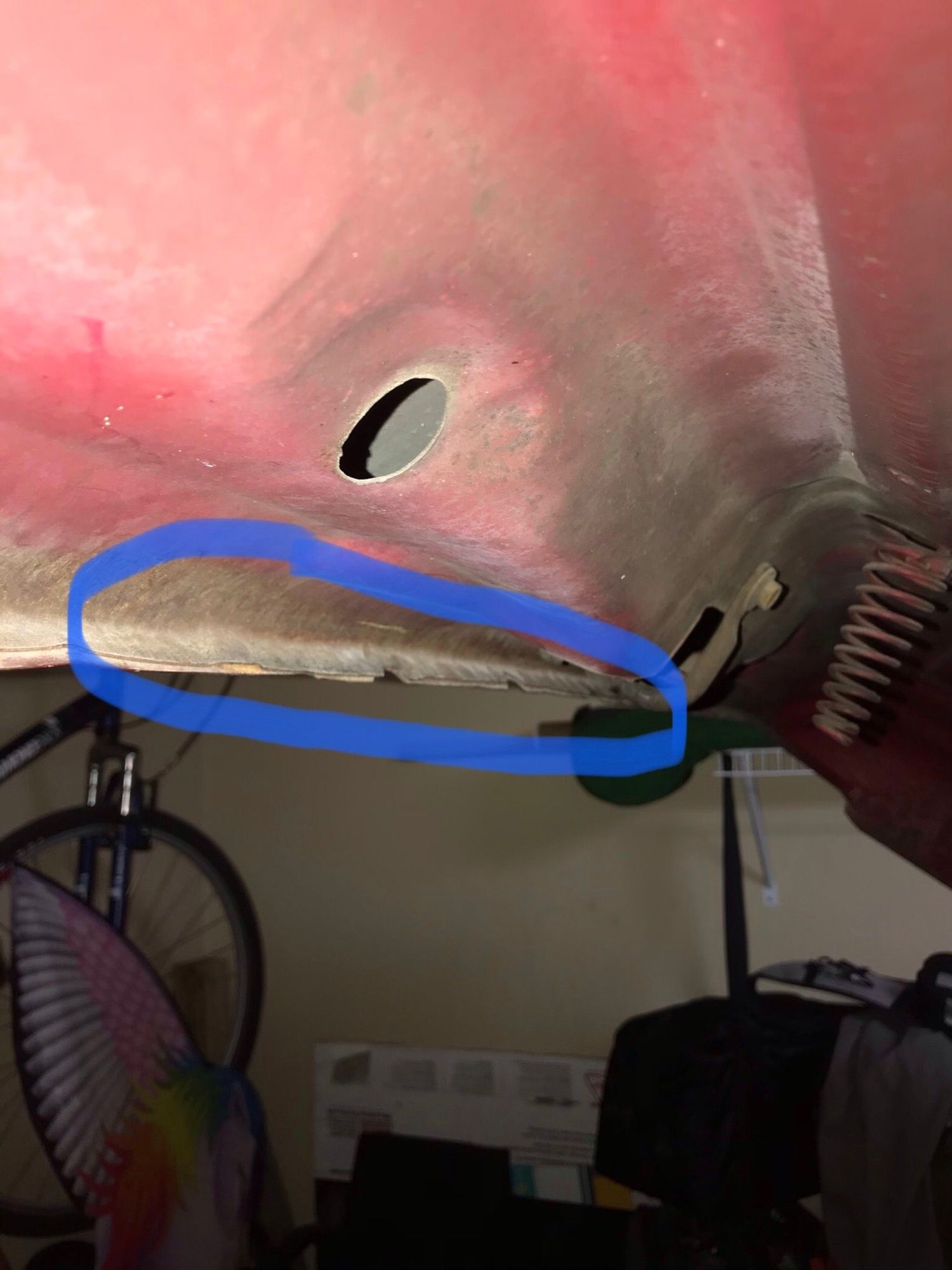

The holes you have to drill are under the front of the hood not on the front as it looks the way you have the brackets now.

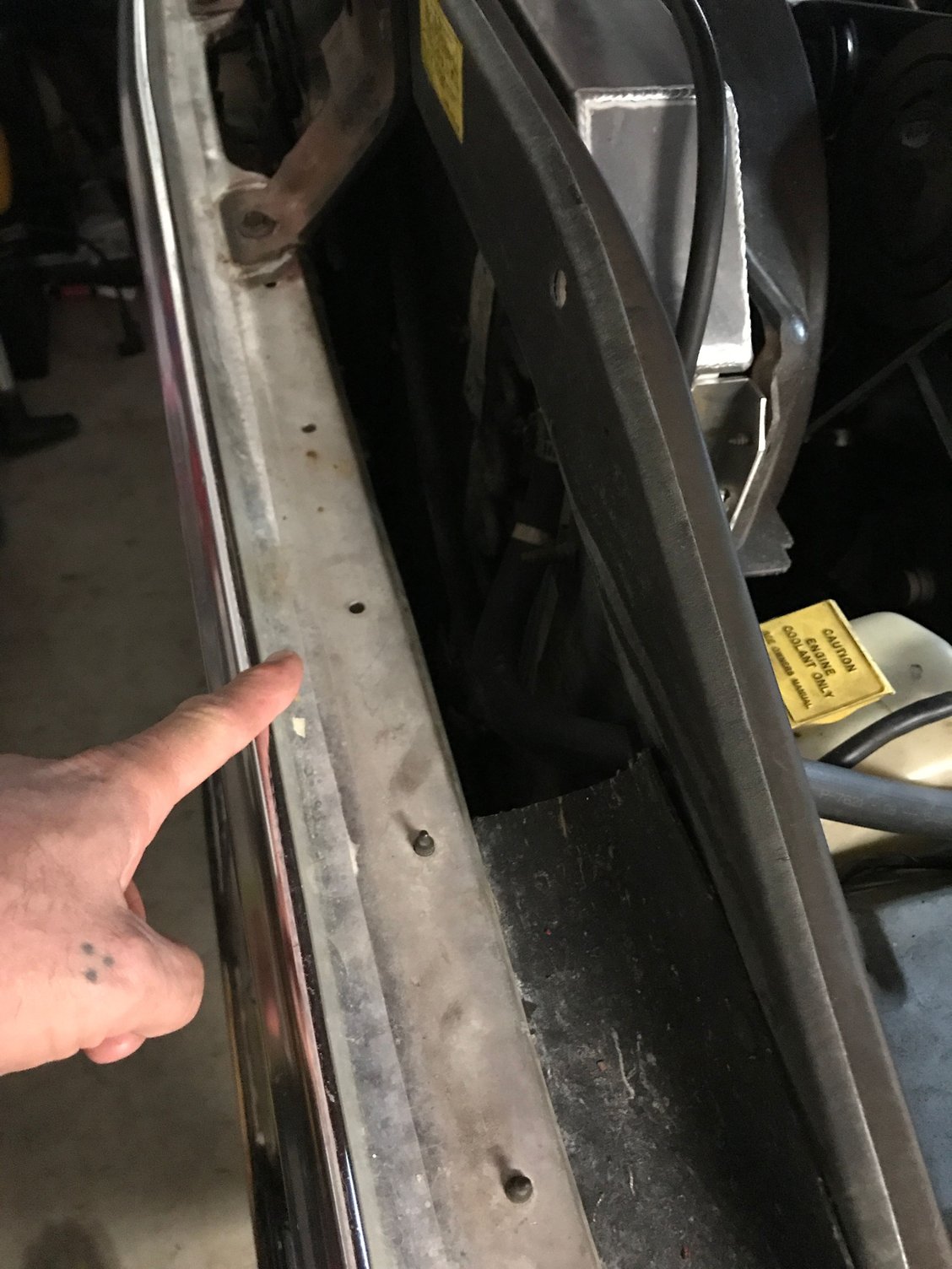

This area ?
Not this lip.

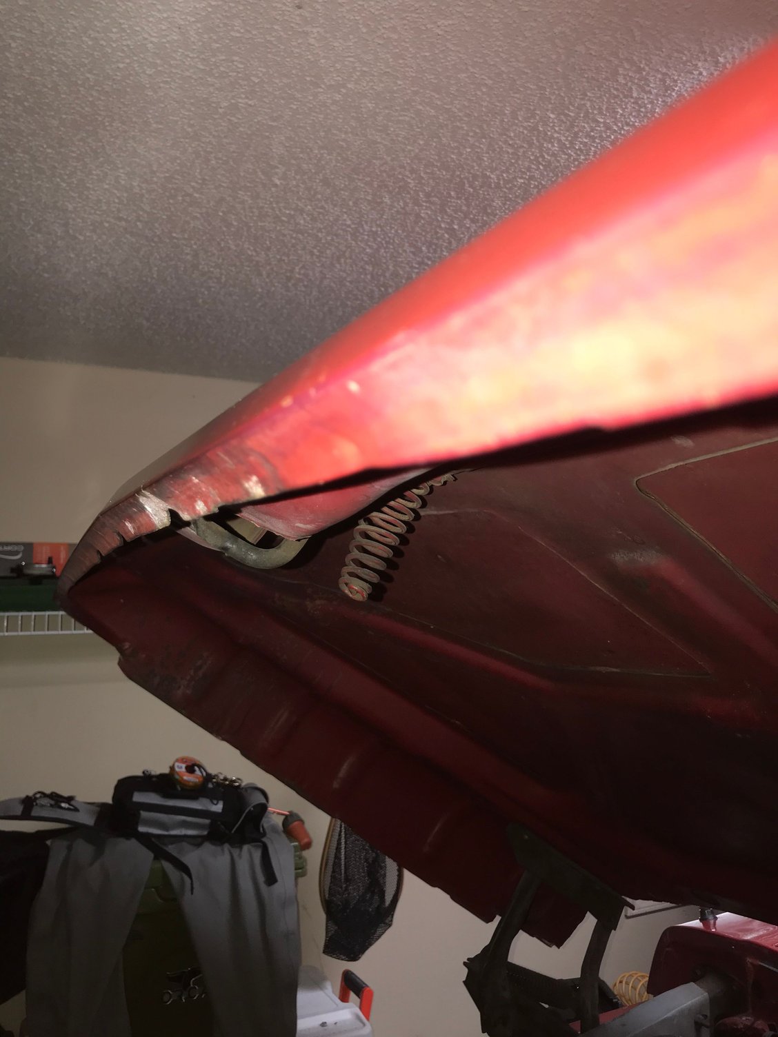

Or this ?

Visor gets bolted to the underside of the hood. Is it a straight one (blue) or does it have a V shape (red)? V shaped is what you need. Here are some pics of one I sold a while back.
Not 100% sure how they go, but I know along time ago the one I had on my truck ( a different one that in the pic) and it rubbed into the top of the grill shell at every bracket.
