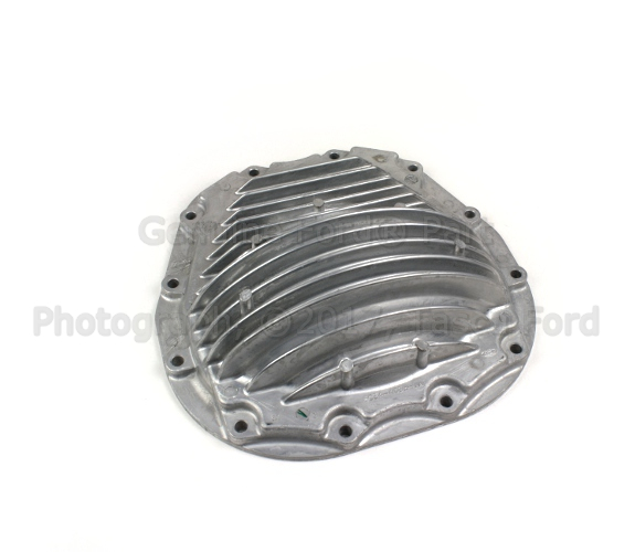

This is the 08 and up finned aluminum cover Armylifer spoke of. OEM from Tasca and $120, tough to beat.

That cover is a perfect swap. Over time it will get a good layer of oxidation. Am not the best expert to tell whether the oxidation reduces (or by how much) its ability to radiate / transfer heat to air. Am considering getting another cover and coating it with a heat shedding ceramic coating. Then again, perhaps Ford added a protective layer since I bought mine.

FYI... If the upgraded cover is purchased, you will need 5/16" x 1-1/4" coarse thread bolts.

Here’s my aluminum diff cover and fluid change parts list in case you are interested:
Ford 8C3Z-4033-A Differential Cover
Lube Locker Ford Sterling 10.25 & 10.5 Differential Gasket
5/16" Flat SS Washers Hillman Group 830504 x100
5/16"-18 X 1-1/4" FT SHCS x25
Mobil 1 102490 75W-140 Synthetic Gear Lube x4 quarts
