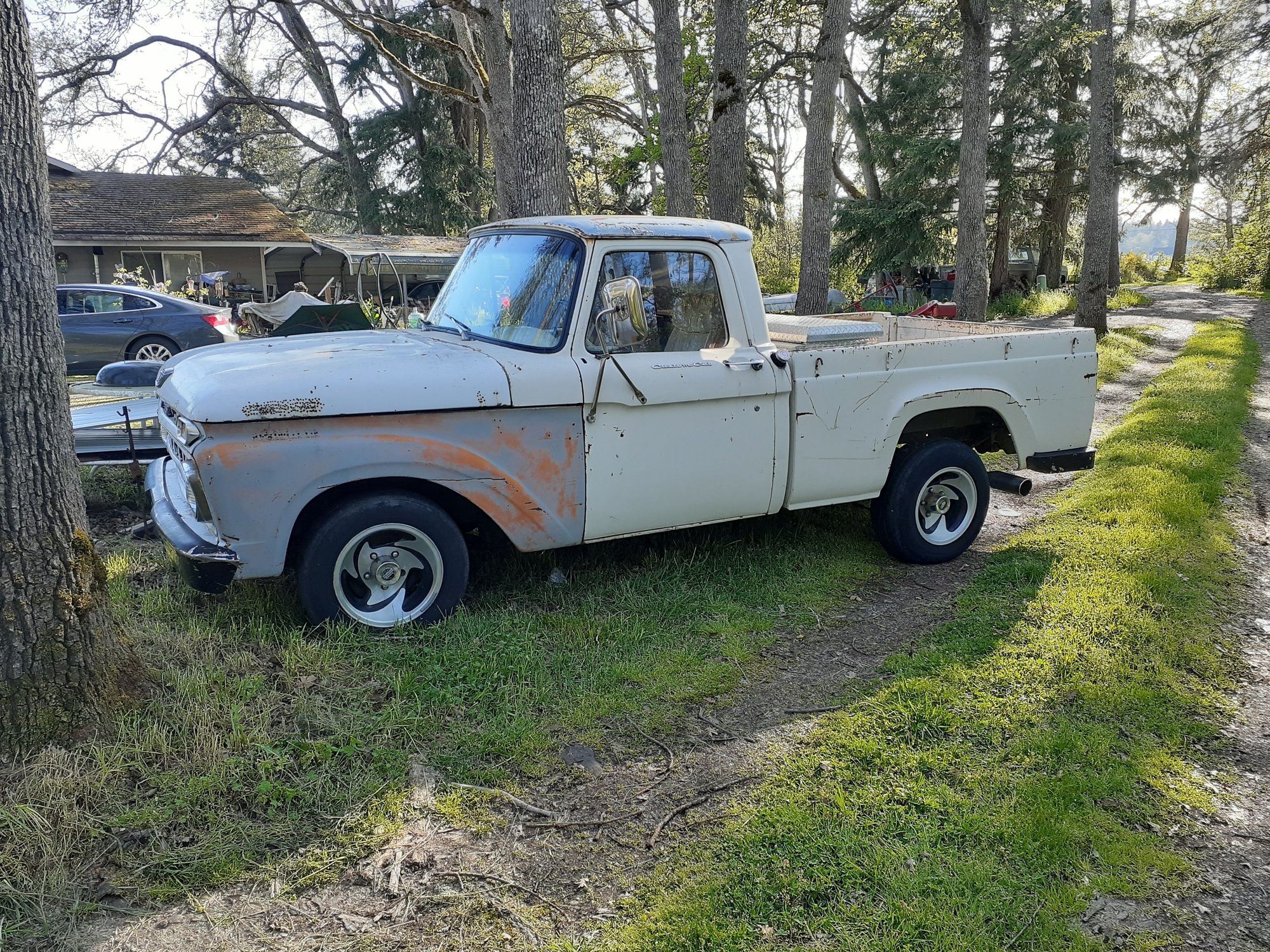

I just bought a 1962 F100. I thought it had a 300 but it only has a 223. It has a 3 on the tree but i want to switch to an automatic. Ultimatley, I would like a 300 with a c4 or c6. Is there any transmission that will interchange with a 223 and 300?
