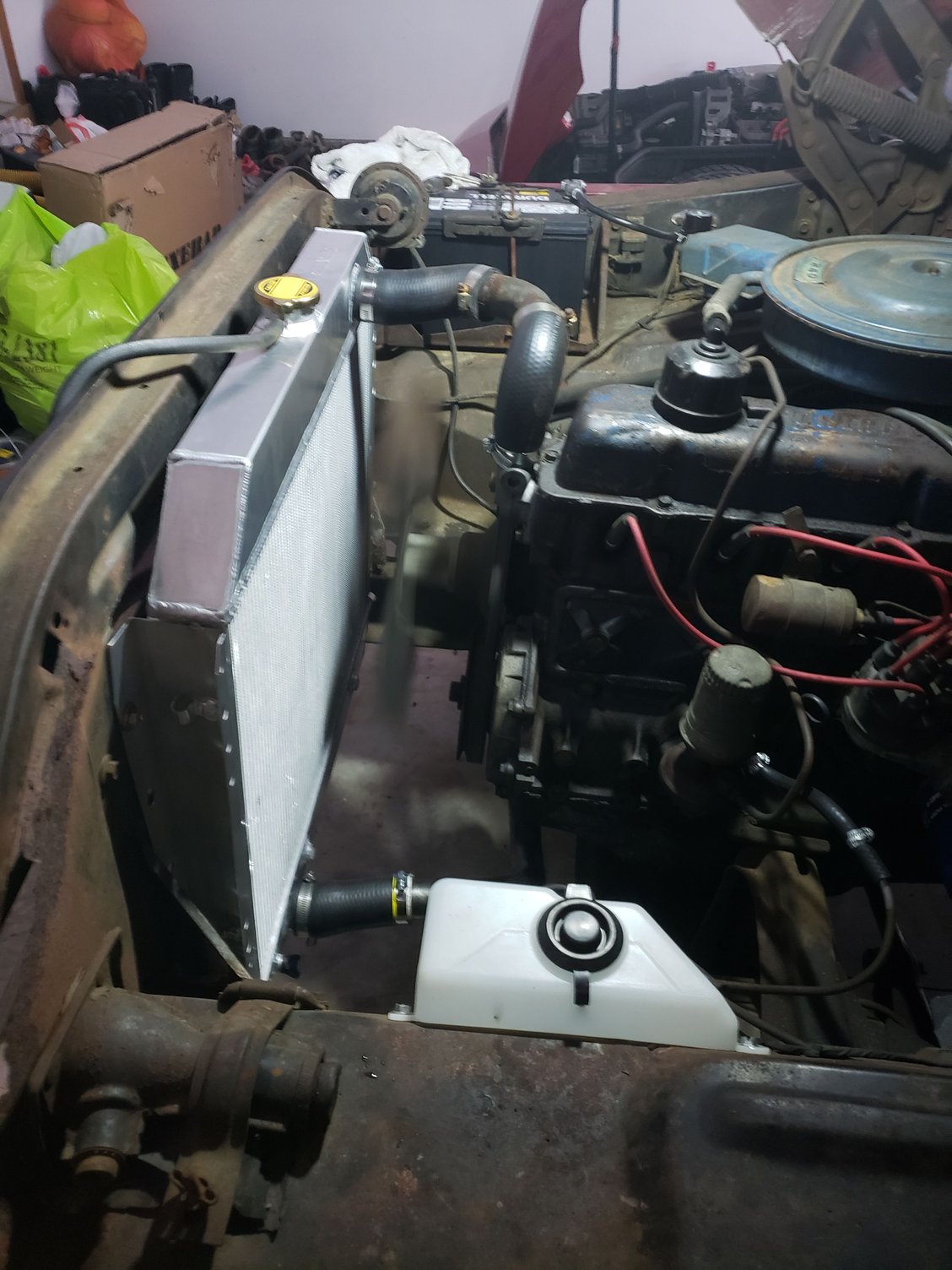

So...finally heard back from the radiator shop....well not great news. Crack, 2 holes and completely blocked. So I put a new 3 core aluminum radiator in...since the larger radiator for the V8 was so much cheaper ($160 vs $500)...I went with that and had to do some "creative" work with the hoses but it looks pretty good and works great. I ended up getting all new mounting hardware for the radiator from bronco graveyard. The radiator bolt kit for the early 70s f100/late 70's broncos fit perfectly. After filling up the radiator and testing everything I noticed my temp gauge didn't budge after leaving the truck running for 10 mins to heat up. So I went thru diagnosing...grounded the wire and the gauge maxed out when I put the key on ACC so its the sensor. Really bummed I didn't notice this before I put 3 gals of coolant into the truck. I am assuming that I need to drain the coolant before I pull the temperature sensor, right? I tested the OHMs on the sensor but I don't know what they are supposed to be...was only reading 2.5 ohms. On the 240, its at the right rear side of the engine. I definitely need to drain it right???
