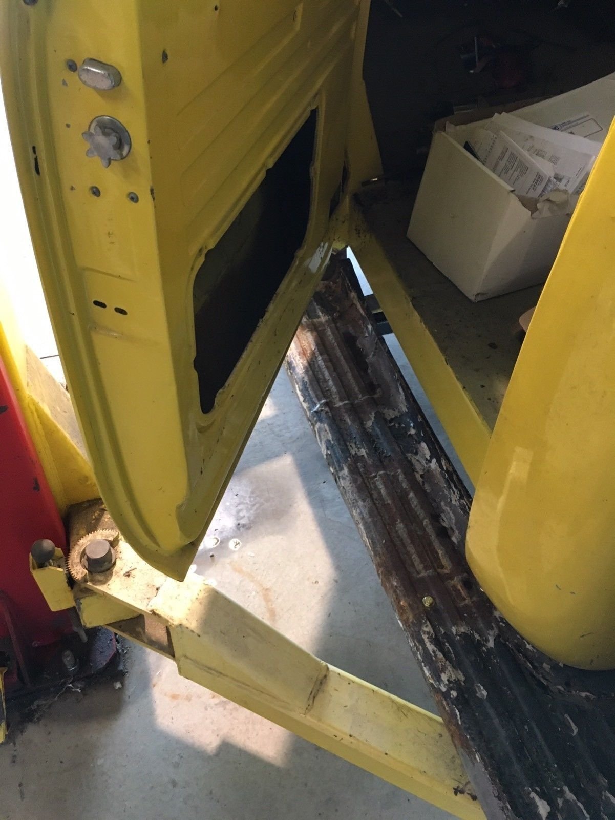

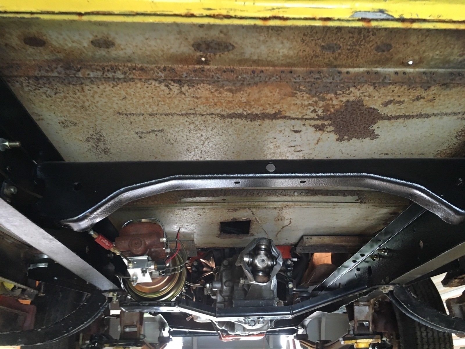

Pictures

This is not what I would call a "truck"...it is a collection of parts that have been tacked together to roughly resemble a truck. Flat floor in cab and telltale weld beads along insides of doors indicate that someone has been doing some extensive metal work on the cab. Since you asked the question I am assuming that you do not have enough experience with these trucks to spot the weak areas and to assess the level of $$$/effort that need to go into bringing one back from the dead. I would suggest that you keep looking, there are some fairly nice complete trucks still out there that do not require this level of commitment to make roadworthy. Good luck...

The trucks looks to be in sound, very decent orig state, and it would seem the owner is transparent about the condition and work done. The new work "looks" professional in the photos, but they're pictures. Hard to check the tranny without tearing into it, but a compression check would be a place to start on the engine. And running beats not running, of course. And from my experience, what he's asking probably doesn't touch the time he/she has put into it. Overall value, both finished and the condition it is in now, is often determined also by local demand and scarcity of similar vehicles. It appears, IMO that it is in a reasonable state to finish out to what might be a very sweet ride. Good luck if becomes yours.

o My other concern would the front suspension. Is it welded in there right?
Will it drive straight? Having to re-do the front suspension would be a tough job.

The engine isn't installed, it's placed in the engine bay. Still need to setup the exhaust and gas pedal and radiator. Exhaust is easily $600 in parts btw.
Driveshaft probably still needs to be fitted.
Instrument cluster and probably complete wiring for the truck.
Steering.
Where's the gas tank? On a '56 they're in the cab.
Seat?
Glass?
Wood for the bed?
Having the brakes installed and having them trouble shoot'd are two different things. Sometimes everything works really well till you actually move it and find it had a small leak somewhere.

It appears this truck had a lot of rust and the repairs were not done to any kind of professional standard. We are a huge group of enablers and generally encourage the spending of other people's money. There's a lot of great advice above in this thread. To have this large of a consensus saying to pass, that should speak volumes. Welcome to the forum, Robert.
