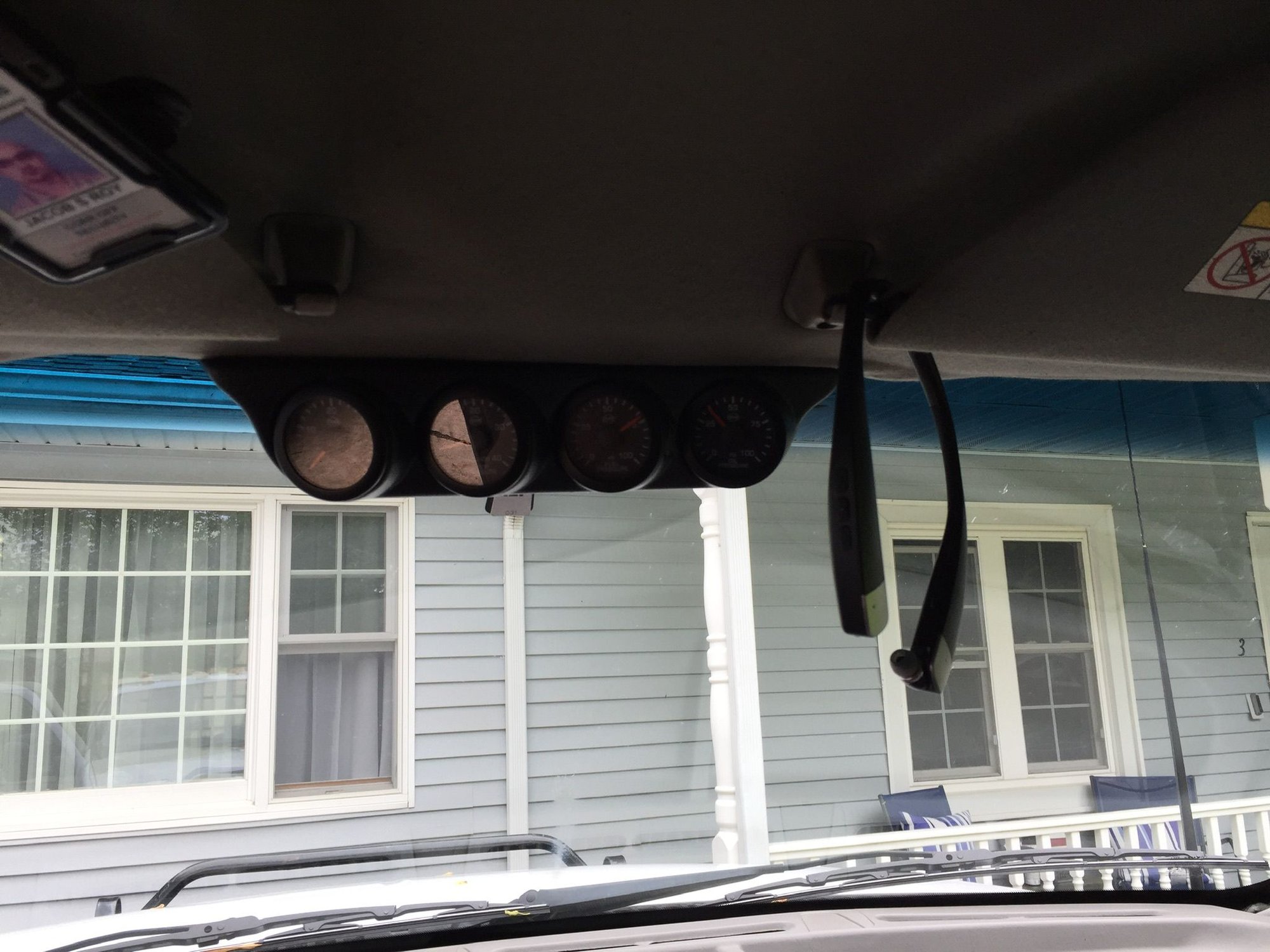

I’ll snap a pic of my center mount quad gauges to show but yes, it is the second link you posted. I had to remove my rear view mirror but I never used it, between driving trucks with no rear mirror and having stuff constantly block my back window I just used my side mirrors for everything. But now I’m wanting the 08+ style mirrors.
Not the best but you get the general idea. Left to right is Boost, HPOP, fuel pressure and oil pressure.
