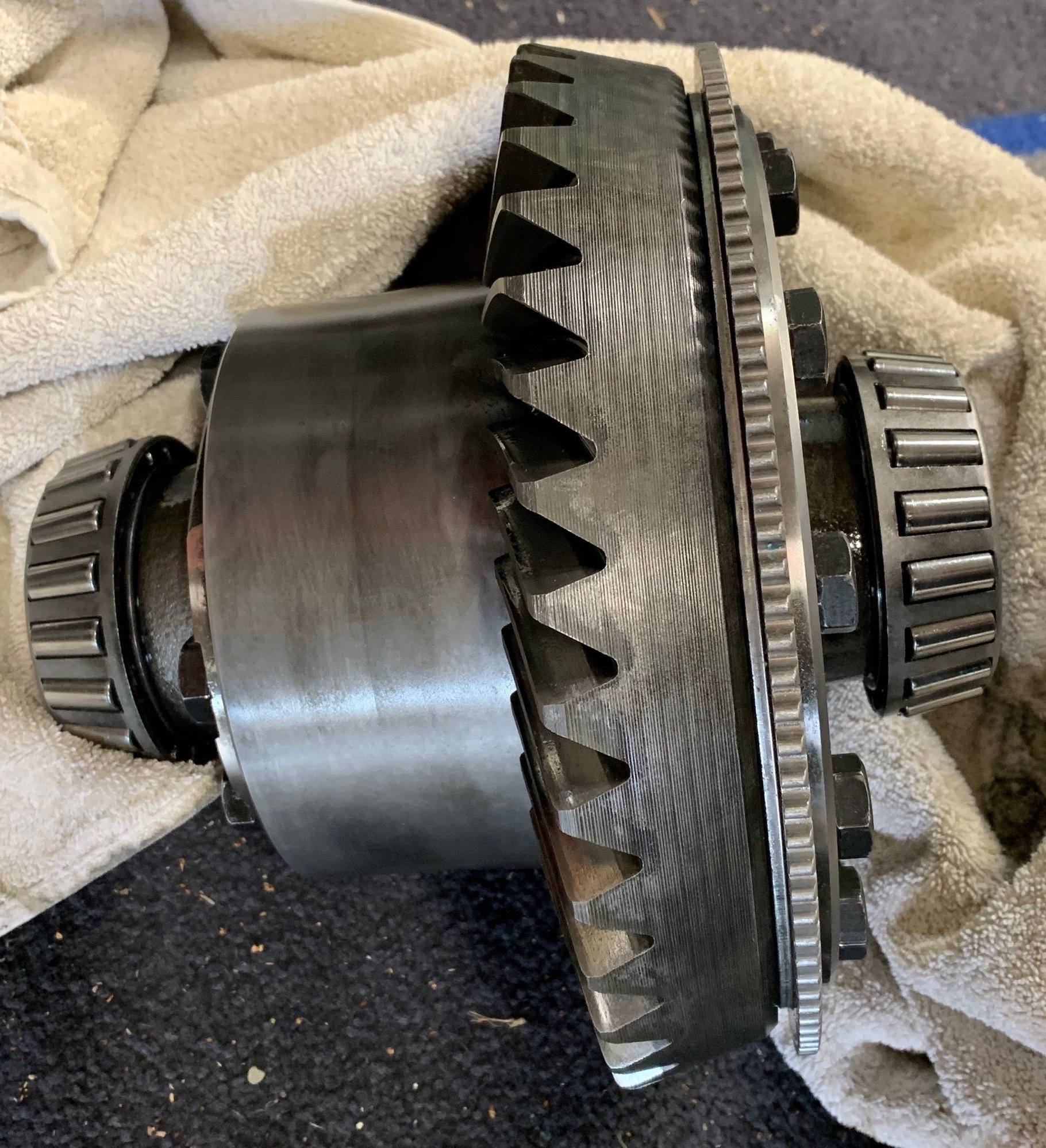

I was coming back from a trip and next thing I know my speedo is bouncing all over the place. It wouldn’t keep cruise on. I replaced the Ford VSS with another Ford VSS sensor and it still was doing it. Enough that eventually it put my E4OD in a limp home mode.
I suspect the problem is damage to the tone ring. Would this cause the speedo jumping in the video clip? Worst part is, I paid good money to have the rear end done 2 or 3 years ago and have only put minimal miles on. I don’t want to pop the rear diff cover off just yet in case the shop try’s to say it was tampered with so the photos are through the VSS hole.

Yes it will. It looks similar to what happened to my brothers truck a couple years ago. Ended up being a broken piece of ring gear that floated around and damaged the tone ring. The only sign of problems was the speedo. We ended up replacing the tone ring with a spare and it was fine. He didn’t do anything about the ring gear and it drove just fine.
good luck. I hope the chunk isn’t junked up

I hope the shop will honor it as I just found my receipt and I had the rear end fully rebuilt with a TruTrac carrier installed on 12/1/17 and have only put 10,375 miles on since.

I've got it scheduled to go in a Wednesday. Hopefully they cover it. The owner actually sounded a bit surprised when I spoke to him and asked me to email him the photos I took. I'm curious as to what let loose. I didn't hear any odd noises or grinding prior to or after the speedo started going nuts.

Update, shop said rear ended looked fine and tone ring had minimal markings. They filled it up and didn’t charge me anything which is good.
I replaced the tone ring myself and took a look at the carrier and bearings and all looks good. The speedo stopped the erratic swinging but was still slightly unstable. I then replaced the PSOM with an eBay one and it works great now. I even rolled back 20k miles!

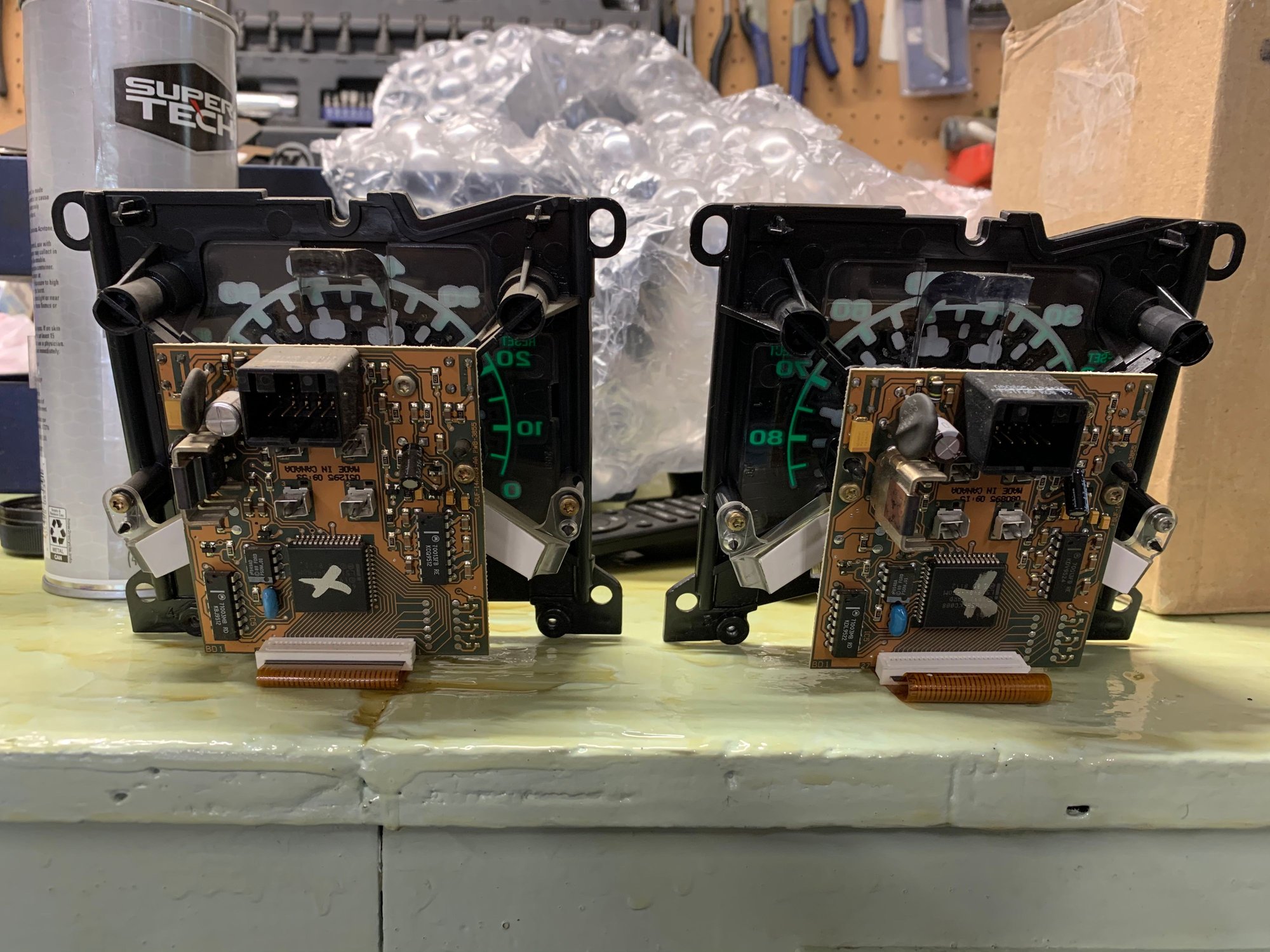

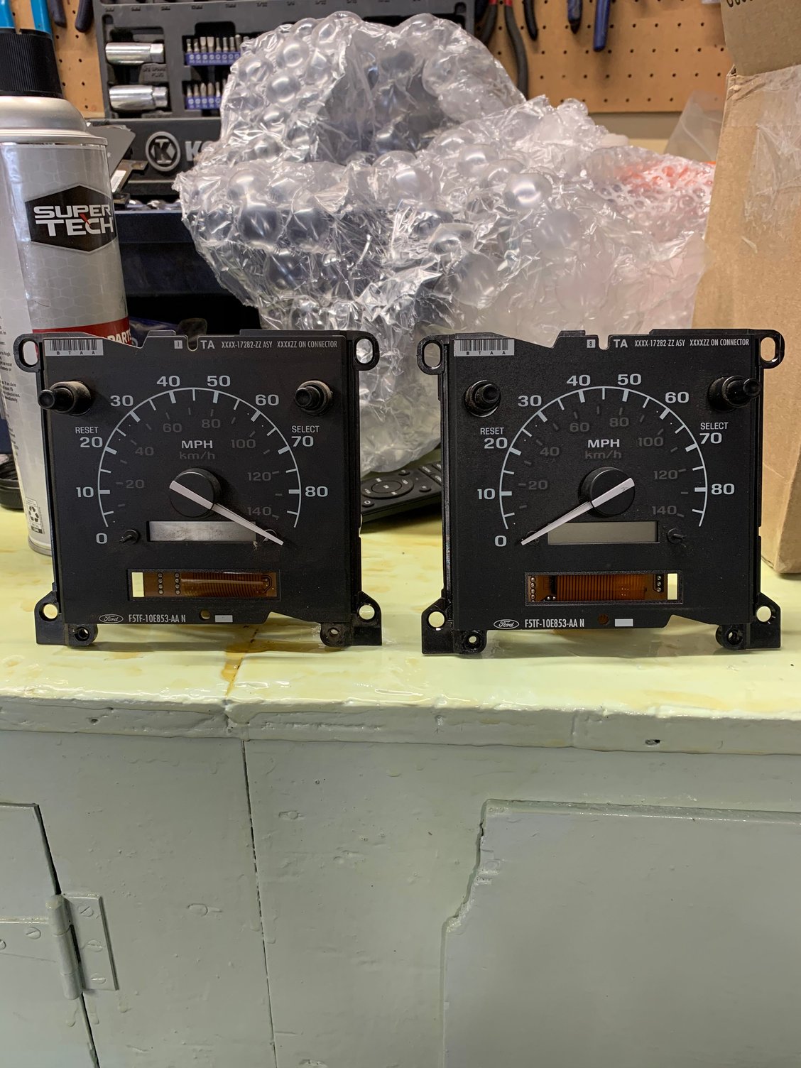

Any 92 to 96 will work no matter the engine from what I’ve found. I got mine off eBay for $50 and it had no description of the vehicle it came off. Old on the left and eBay on the right.
